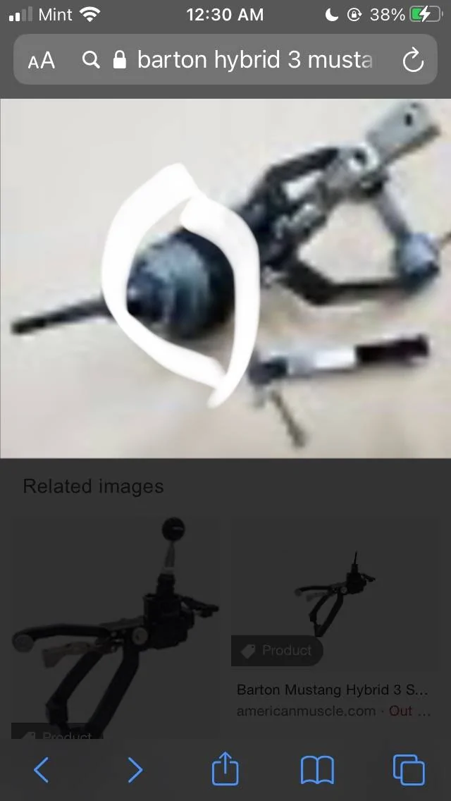

I only had one issue, the little shift grommet boot seemed a bit hard to get around the base of my shift stuff, it’s basically a rubber condom.
I trimmed off 1 inch of it. After I did that it folded right over the shifter securely.
I can’t find a photo of it, but send me a photo of it and I can show ya, but I would install it unless you have similar issue where it is simply too hard to push down over the assembly. Then trim a little off it. After the small trim w a razor, it folded right over it cake
That was only hiccup
It’s blurry but you can kinda see the weird rubber thing covering the assembly. Mine was just tapered in too right, trimming a little back made bigger opening so I could roll the rubber over it
Literally a condom. Lmao
The shift rubber goes over the assemblage once you’re done, and also there’s memory foam looking stuff a little sheet of it goes down under it with a sheet of dynamat. All for removing NVH I believe and sound

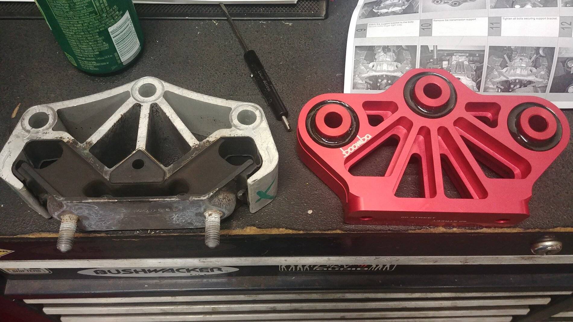

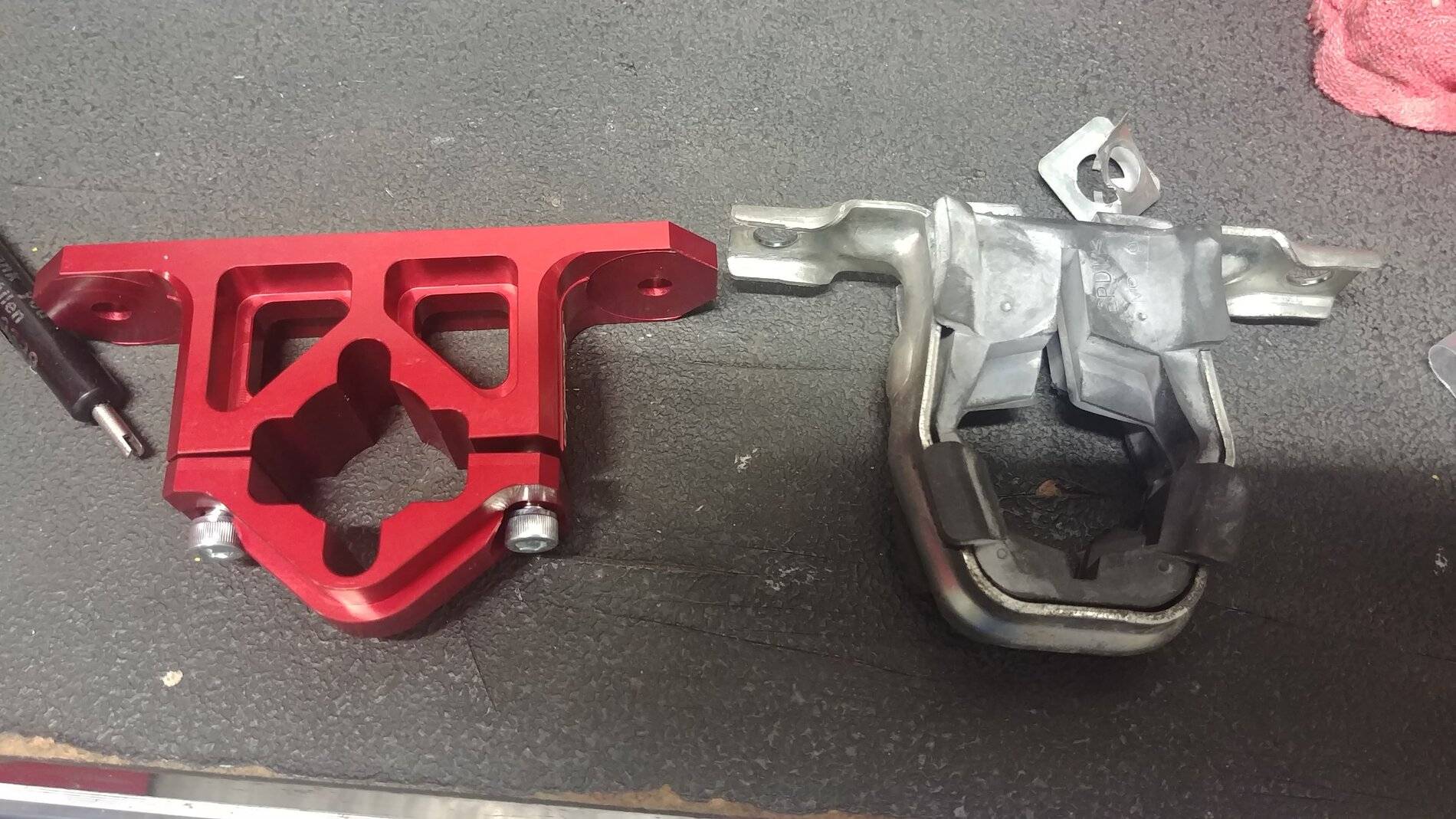

Another option for you to consider, https://www.boombaracing.com/transmission-9/?sort=featured&page=1
I have the trans mount and shifter assembly along with the BG syncroshift fluid in my car. I'm happy, the trans is still a little noisy but I've never experience a lockout and the fluid change makes a significant difference.
Elp_jc
May 2, 2020
48
3,527
807
None
Man, those pieces look like art. Ha ha. Definitely higher NVH than stock, right?
