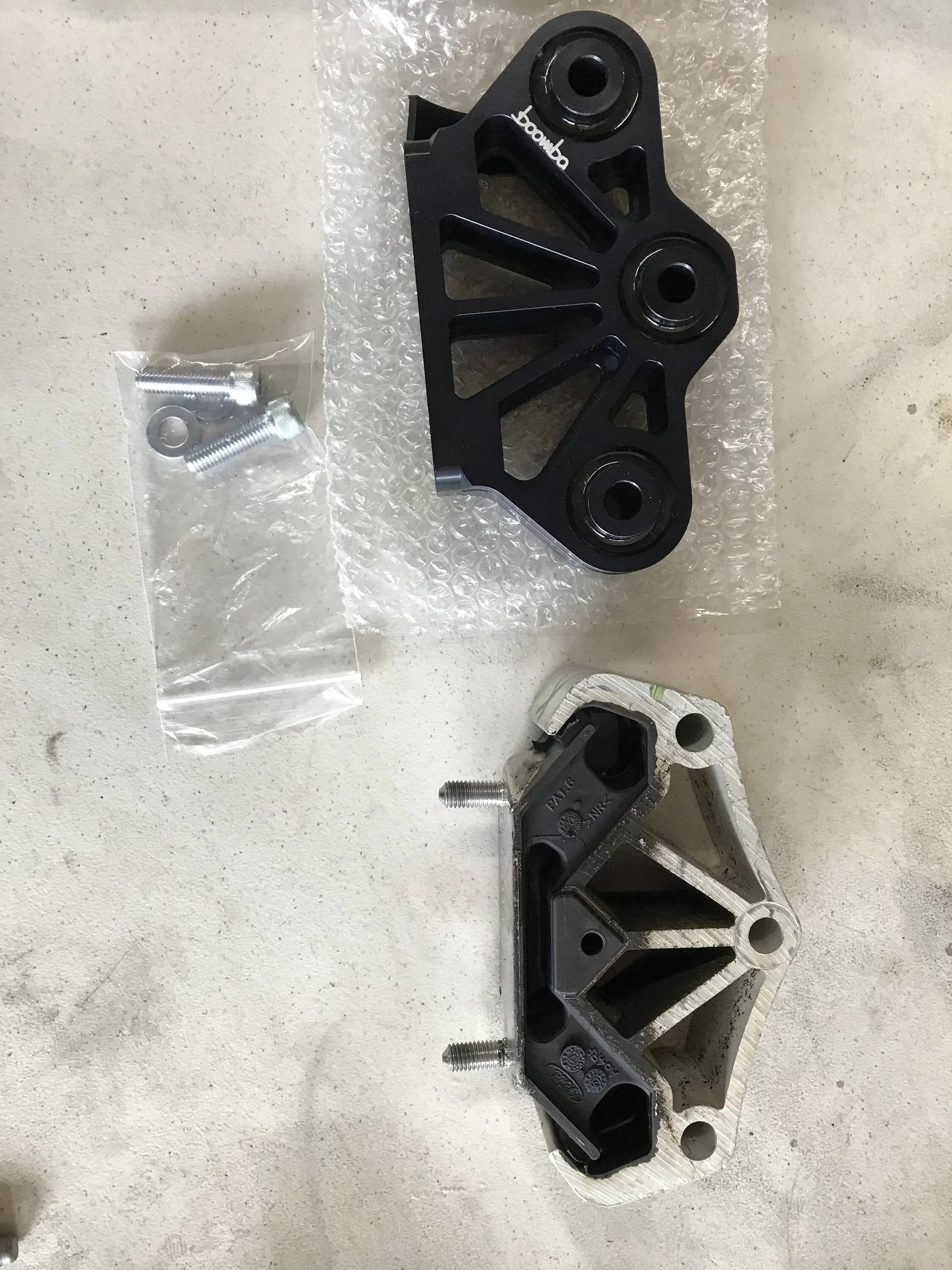

In case of interest. Boomba trans mount vs. stock unit:
Did you get the race or street spec? And how do you like it? The street version is on my list of to dos.
Street spec. At first there was a noticeable vibration which eventually faded. Perhaps 50 miles or so. I like it, took some of the slop out. Its not a gamechanger, but its a mod and I like modding!

@Zrussian13, I have the Boomba race spec and I love it. My NVH was nowhere near what I thought it would be given every bushing I havve on the car is the black hard race spec.
When the new driveshaft goes in, I’ll have to reassess, but I hope it remains the same.
