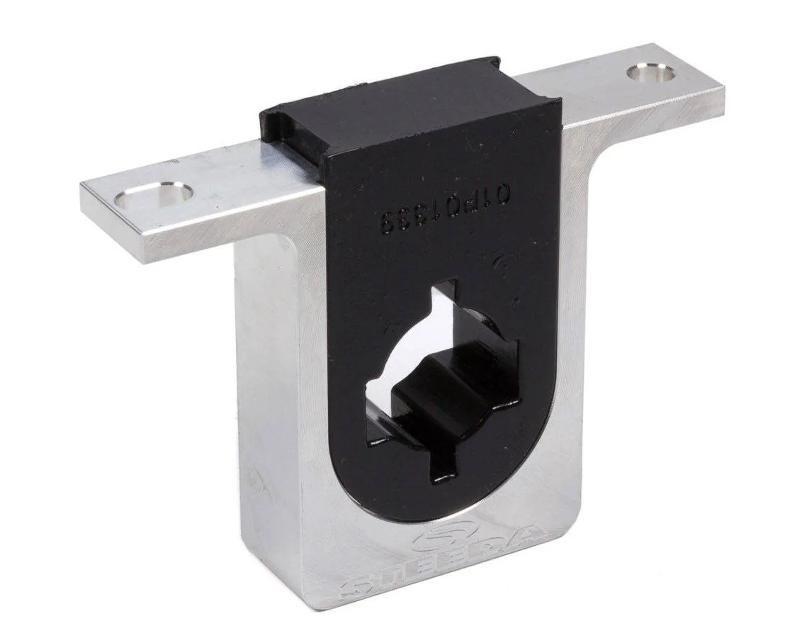

Are you guys referring to this bracket :
Cheers,
WD :like:
