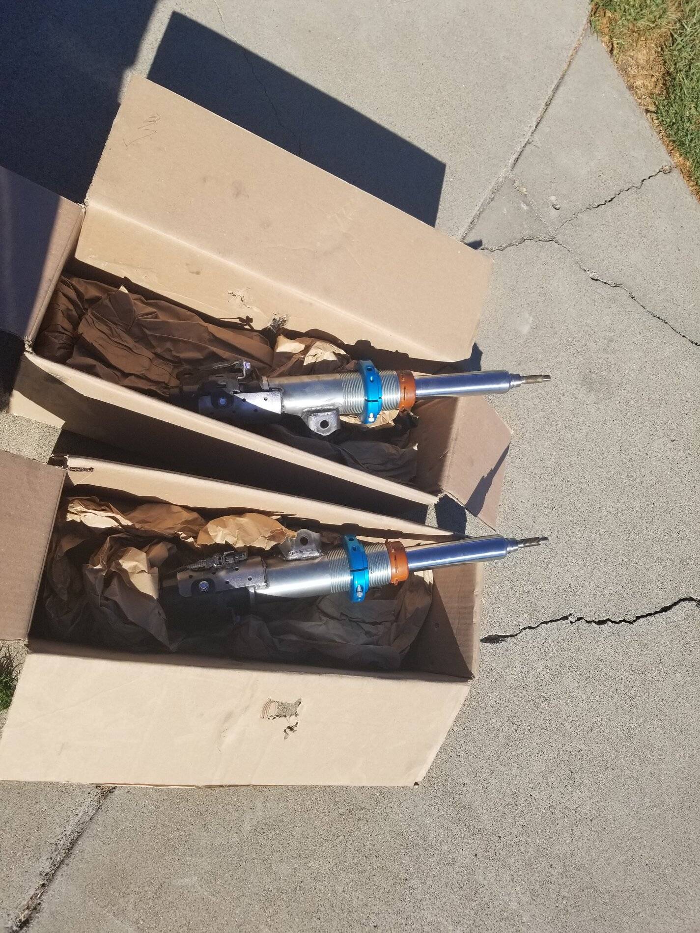

Let the games begin!

What are we looking at?
$20,000 shocks he found in the dumpster behind the paddock from the Cadillac prototype team.
Kidding...
Those are MR shocks transplanted into coilovers bodies.

Yep. I've been blabbing on about them for a while. They're the GT350R Magneride struts turned into coil-overs. I just got them back from the machinist, so I gotta play show-&-tell. I guess I forgot the 'tell' part.
