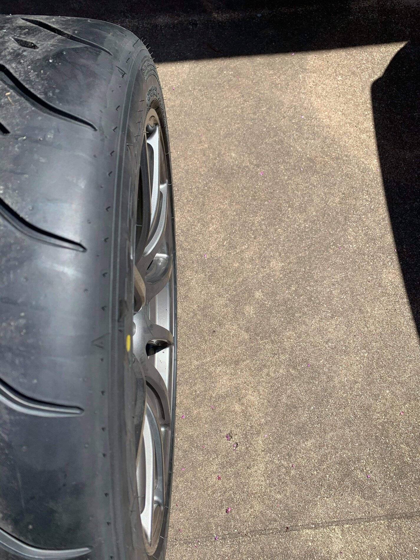

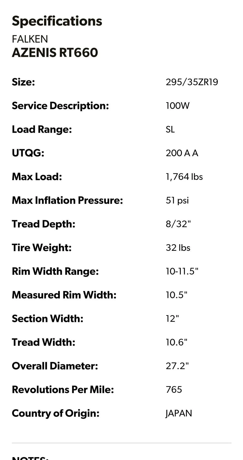

Not quite. They do not appear stretched at all, actually.

Good point and thanks for the picture and the correction on the max recommended rim width being 11.5" so not "stretched" on 11's according to mfg/industry specs. One thing I see from that picture and others I've seen is that the "rim protector" on the RT-660 is very similar in appearance to the ones on my OEM Michelin PS4S 255/40 and 275/40 tires. As a result a "stack" of 2 of each size is actually about 1" higher than a "stack" of four 275/35x19 RE-71R's. All on the OEM size 9" F and 9.5" R wheels.
Based on what I've learned so far I'm leaning towards four 275/35x19 RT-660's. My front autocross wheels have 6 mm more offset than OEM so tire to Magneride strut clearance will be fine.
