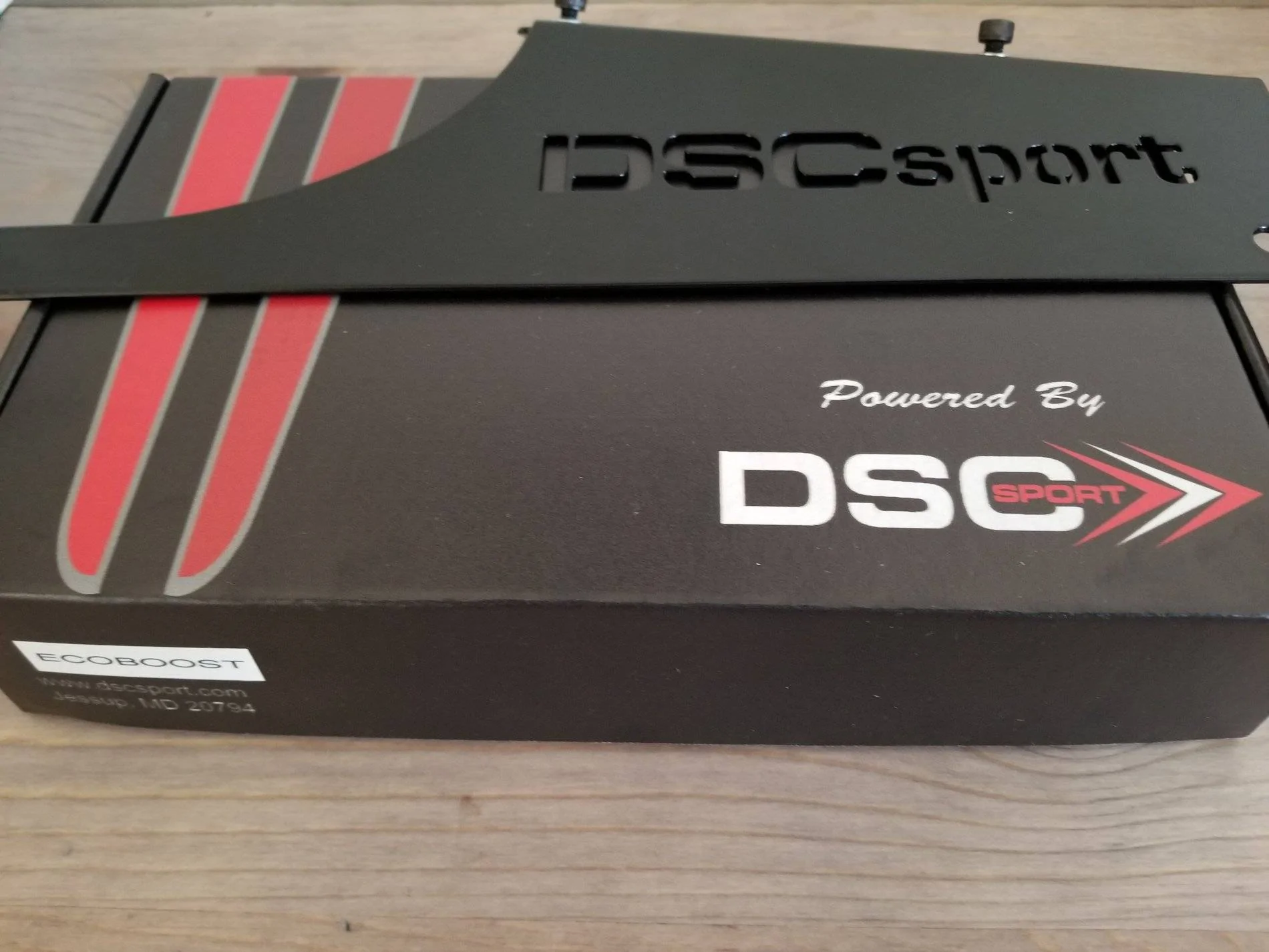

I stuck the DSC Controller in earlier today.
I took it out on an initial run. City ride is pretty good. It went over little choppy stuff as good, if not better, than the Ford cal. It did have the tendency to be a little undamped/floaty just driving down the street. I need to get it on a freeway to feel it there.
When getting frisky, it did control body movement pretty well. I feel like it has a bit better front end grip. I don't have track camber in the front, but it still had a strong enough front end that I didn't induce a push in a couple quick 180's. I haven't really challenged the rear enough to make a reasonable evaluation.
Putting it in is nothing, literally a 5-10 minute job and it was 1/2 dark.

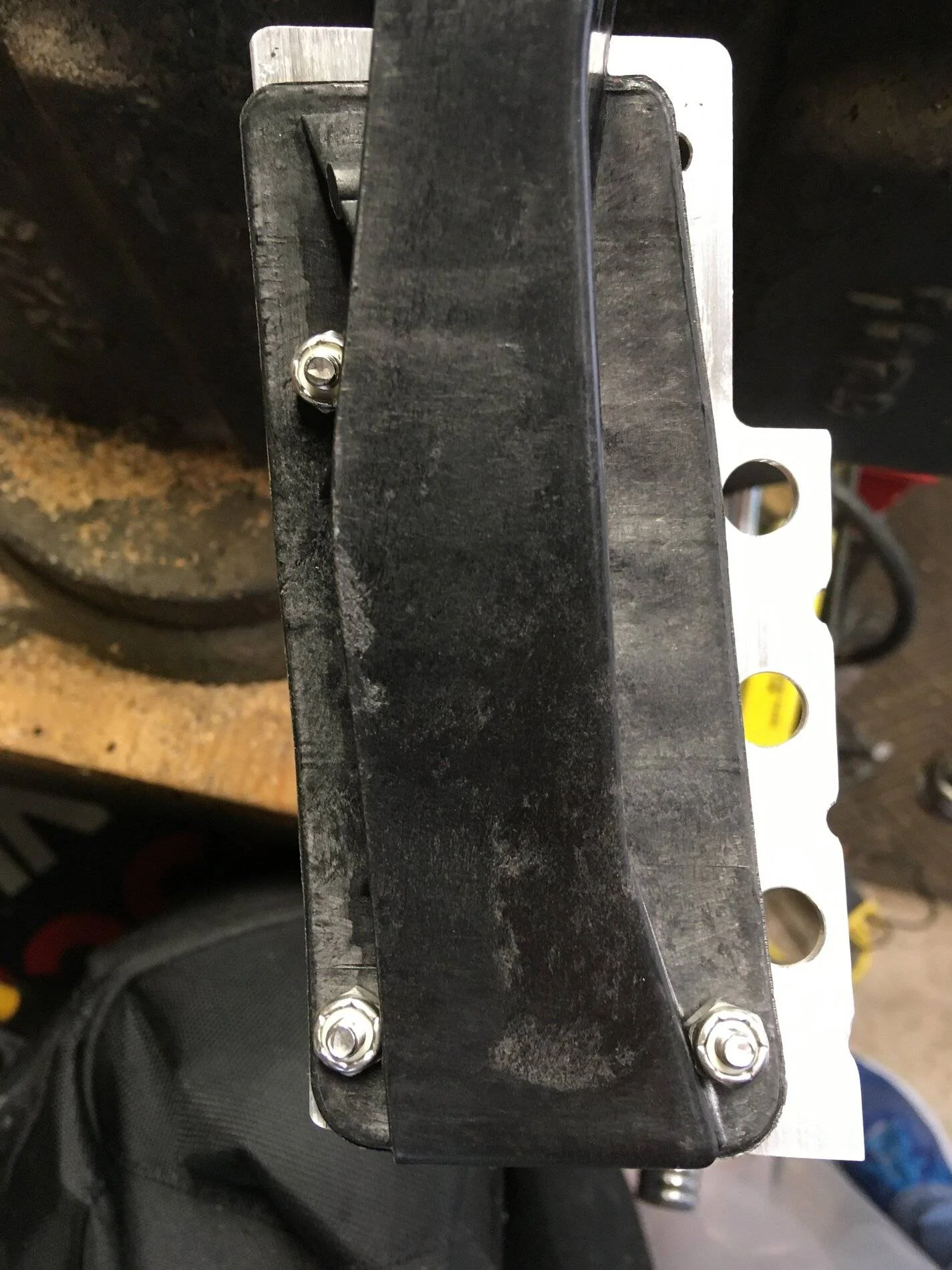

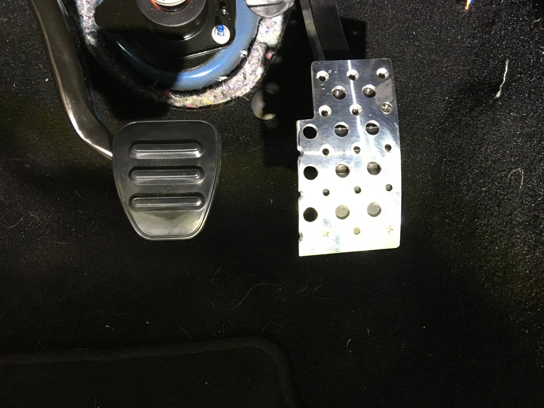

The space between the brake and gas on Mustangs are a little wider than the euro cars. So I got a wider gas pedal from Steeda. It was too wide and I cut it down so that I have about a 50 mm gap (2 inches). Only narrowed gap by about 15 mm. Also the Mustang pedals are more to the left than the BMW M3 and Porsche Boxster pedals in relation to the seat and steering wheel . I am practicing often so I do not get the gas and brake when I go for the brake. I have done that more than a few times transitioning to the Mustang.
