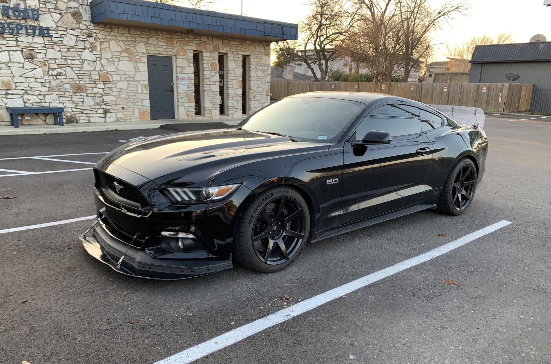

On my GT PP the most the factory splitter extends forward of the bumper is 1 5/8"ish at the pointy parts on each corner. Most of it is barely a half in forward of the bumper.

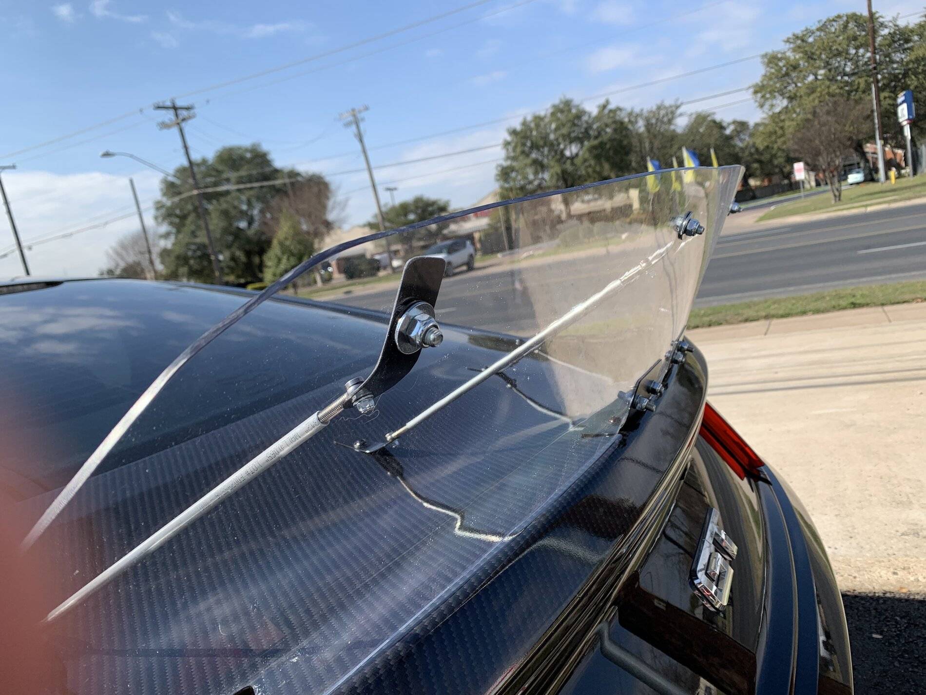

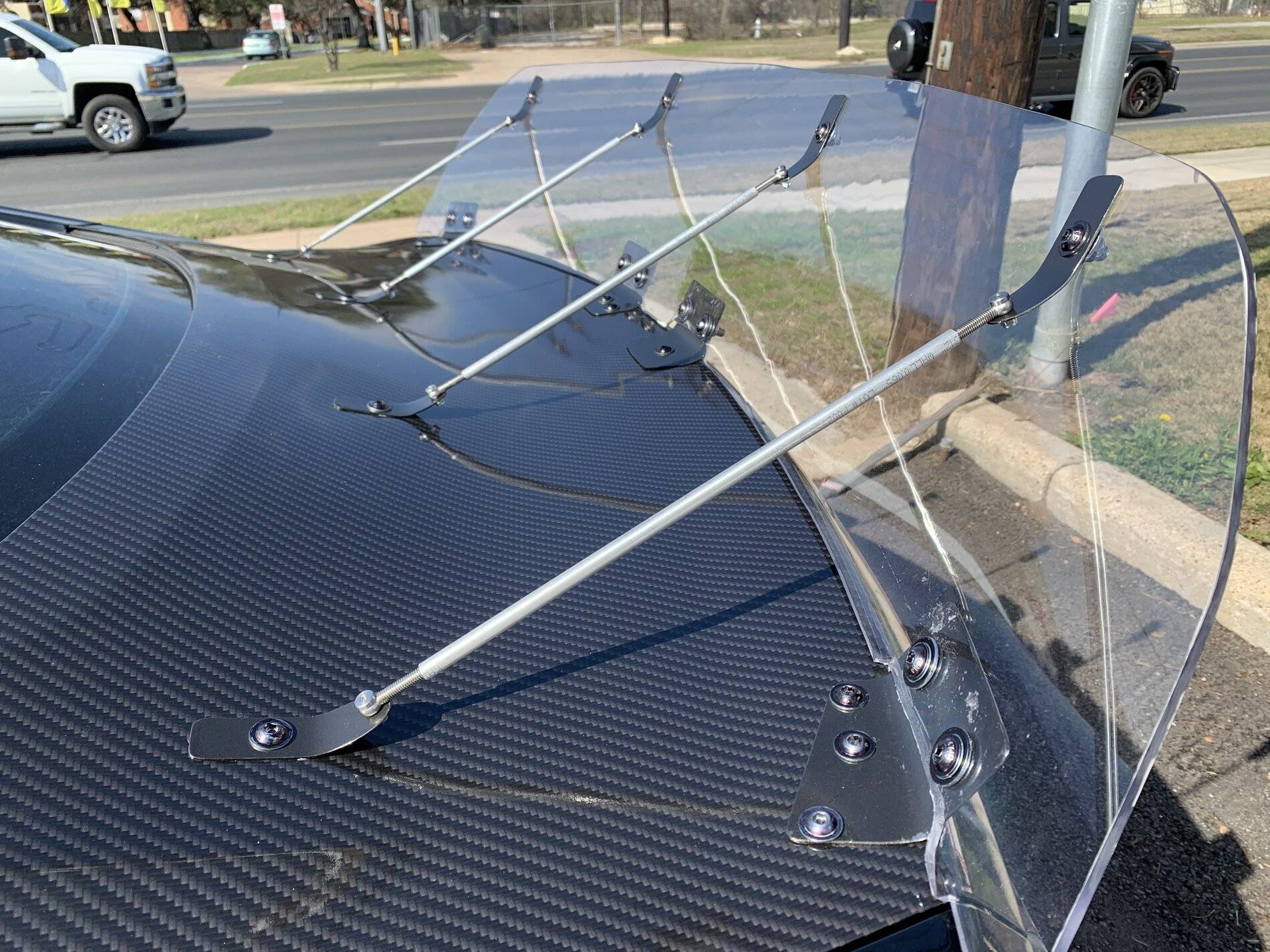

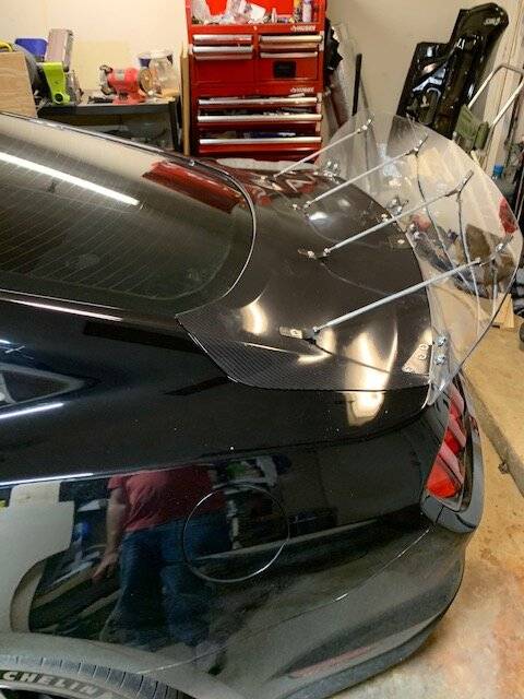

Finished my DIY CAM aero project. I did get an email replay from scca rallysolo (unsigned so I don’t know who), to my question about the splitter and they indicated that their read on the CAM rules was the splitter would measure from 6” from the plastic cover over the crash bar (implying not from the lower bumper plastic or front valence), so I cut back my original splitter to conform. The rear lexan spoiler is just less than 10” too, but it looks massive.
I’m satisfied with how it all turned out and I’ll get to test it all at a local event tomorrow to find out how the balance has changed at speed.

Did you have to drill the trunk for the spoiler rods ?

Yeah, I found a cheap deal on a black take-off factory deck lid with the stock spoiler holes so I used all of those for the brackets (and widened a couple), and then drilled 4 additional holes for the support rods.
Its not too bad to swap trunks, so the plan is to switch back to my stock trunk when I'm not in race mode. You can see my factory deck lid in the background here.

got a bigger pic? I note a distinct lack of sponsorship decals, friend.
are the 'tabs' on the front/leading face or on the trailing? Would seem ripe for flutter and pulling thru.

no movement at all at 80mph, haven’t tested it at higher speeds yet, but these 8mm bolts and large washers on the back of the rod supports seem pretty sturdy. The base of the spoiler is supported from behind so IDK.
Its my first try at something like this and I have plenty of Lexan left over so if it flies off, its no big deal.
and yes you can stand on the front splitter :). Scary to try that on something that took as long to build as this took me but it was fine. A rod collet slipped when I did so I’m glad I tested it.

That looks really good on both ends, Nightmare. I've got to think you'll be able to feel it. How close are you to the top of the spoiler protruding beyond the rear bumper? Leaning it back will gain plan view surface area, but you can only go so far. Side fences on the spoiler might gain a bit of pressure & add rigidity.
I love the approach. Drag be damned...we're gonna make some stick! It's almost always the way to go...unless you happen to be at Daytona. 😉

I've got about 2-2.5 inches horizontally before it protrudes past the bumper edge, so it could be leaned back maybe 5 or 10 more degrees. I'd loose drag, but I'd also loose downforce at a shallower angle (from what little I've read). Good info on wacky CAM legal spoilers is hard to find, but I did find a little.
