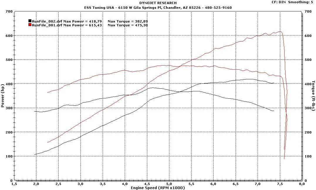

Heres a dyno example of a G2/125 setup and why I went with it. The torque really only increased by 100ft-lbs peak, and the HP is made holding that torque longer as the boost makes up for top end air flow restrictions. It also only weighs about 40lbs total. They claim 35lbs total change, but after weighing things its more like 40lbs.
At least in my case, the stock power was just sad. Now I can still use all the throttle, though it does take a bit more talent with the right foot.

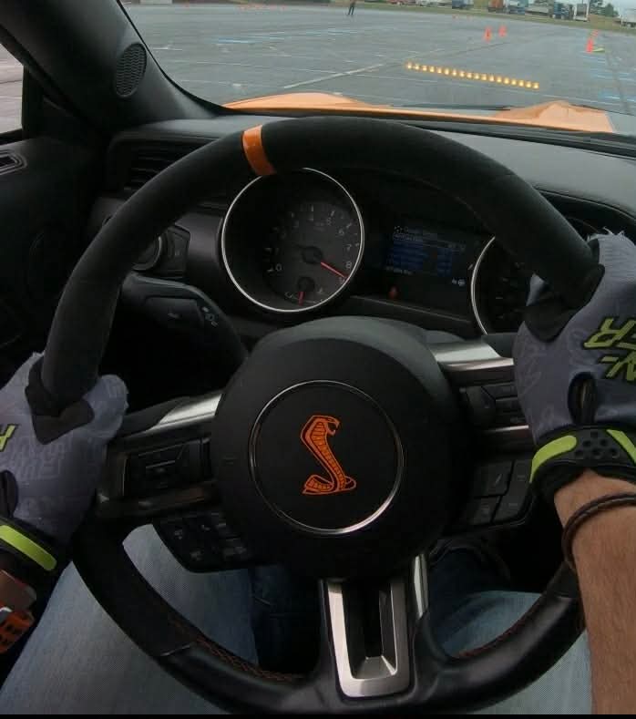

This was specifically for situations like this. My main CAMC competition locally in his 2014 GT had to shift to 3rd and back to 2nd. I am usually within tenths of a second of him on most courses, but beat him by just over a second at this event. My tuner built the 9,000 rpm limiter with a soft limiter so it just climbs and then sits there without bouncing or anything to limit potential damage.

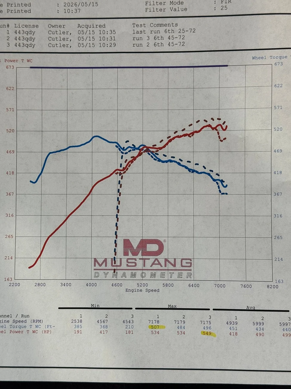

Heres some pulls on a mustang dyno. Limited by airflow on the small intercooler it was heating up pretty quick but not cooling back down.
Stock on a mustang dyno a Gen3 makes 380-400hp and 350-370tq.
With the lowest boost and 92 oct my setup made peak ~550hp/510tq. This would be low 600s dynojet. I think I make around 6-7psi over 7k, so its pretty low boost.
But what the dyno does show well, we make over 450ft/lbs before 3000rpm. No bad! I thought we'd end up with less than 500ft-lbs and a bit more up top. But some higher octane, ducting and airflow on the FMIC, a bit more pulley, and torque management to handle peak mid range, we could keep around 500ft-lbs longer and a bit less torque drop off up top.
