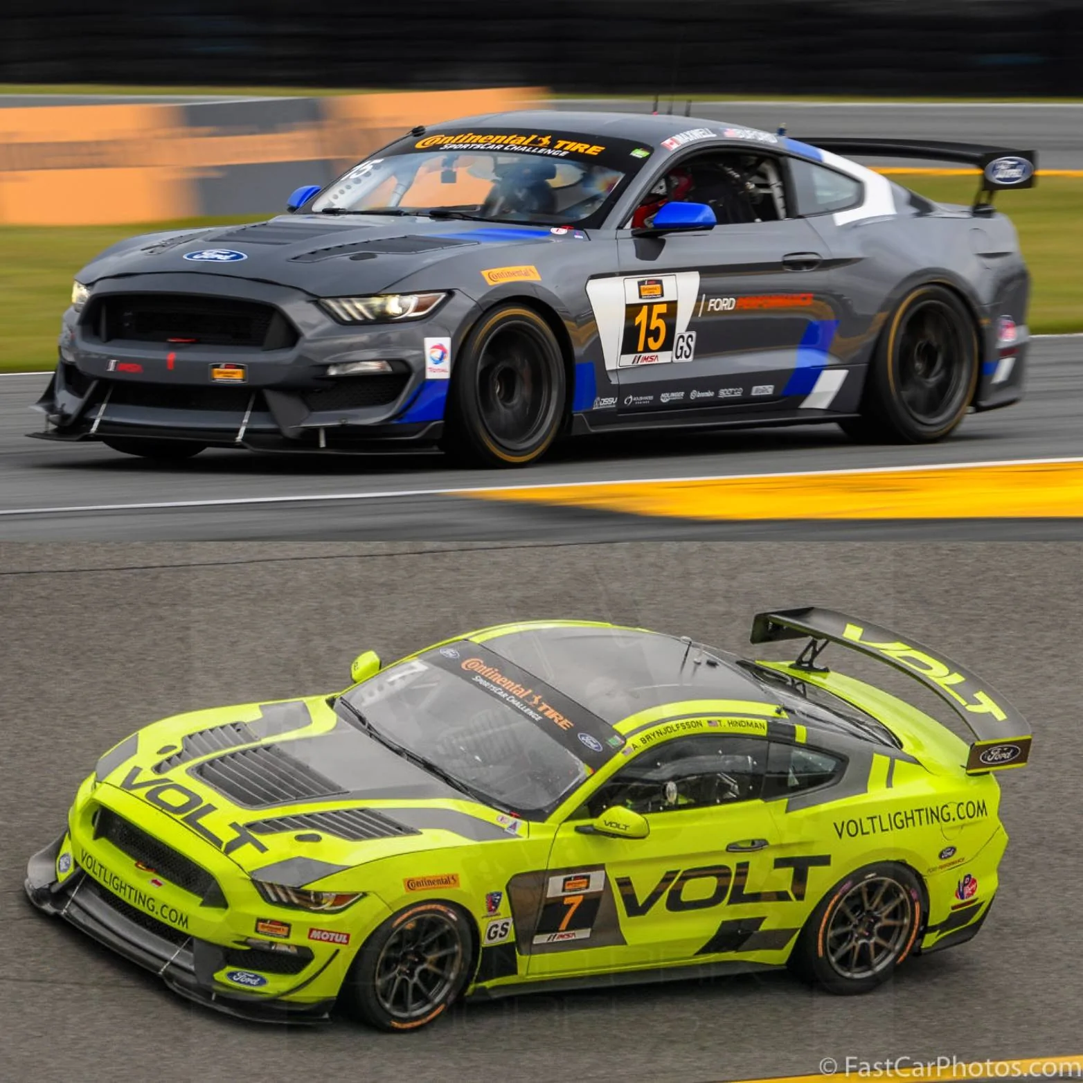

I can tell you that the large vents do well at radiating heat passively while the car is still, but in all honest I'm sure that a vast majority of it is simply imitation from what Ford did with the S550 GT4 cars.
TeeLew
Apr 27, 2020
3,396
2,613
So Cal
Tim
Honda Odyssey, Toyota Tacoma, 89 GT project, 2020 Magnetic EB HPP w/ 6M
How much different is the positioning of the Race Louver, Track spec & GT500?
Most OEM aero tweaks are more for show than practicality. They want the look, but anything that increases drag hurts fuel economy, so they mess it up.
I have the older GT350 spoiler on my car and the ends are peeled back specifically to dump downforce/drag, for sure.
I'm not an aero engineer, but I am a mechanical one with an emphasis in fluids (10,000 years ago) and a wee bit of experience on similar stuff. I'll never give you a straight answer on aero stuff, but I can tell you where to look to find the answer (some times).
Are those GT4 cars also using the Verus Engineering wing? And do you all believe it might suit my lower horsepower and lighter weight vs say an AJ Hartman swan neck wing?
