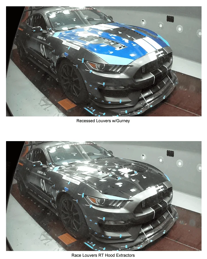

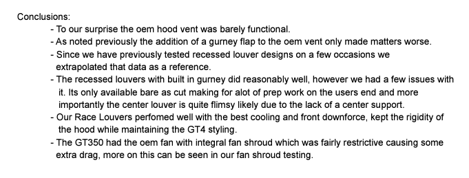

I went to the RL site to review their data. It wasn't that downforce decreased, but that doing things like adding a Gurney to a stuck GT350 hood was a net loss overall. The RL Louvers actually had a significant bump.
What's more interesting is looking at the SN-95 data. It's sort of all over the place. Somewhere RL tested a ducted set up, but I can't find those tests at the moment.
Either way, as I stated earlier, I could be wrong. I am. There is a DF gain with the RL setup, but a reduction if you add a gurney to the factory set up. That is what I was remembering.

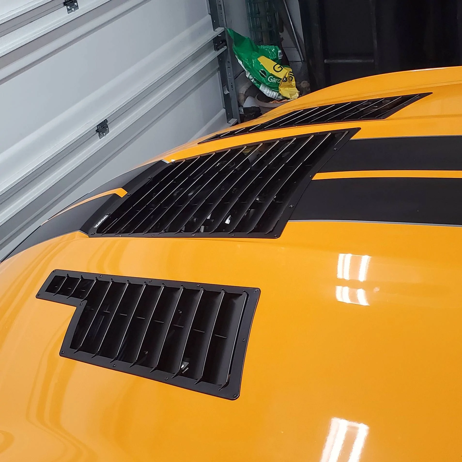

It sounds like he's referring to the Carter's Customs recessed hood vent solution there. They ship it to you flat and then you have to bend the vanes into place. It's cheap, but I said hell no immediately. It also doesn't have any center supports where as my Trackspec unit has two perpendicular supports on the large center vent and 1 each on the side vents.
I do wish the Trackspec were a little more 50/50 on the crease vs 85/15 with the majority sticcking below the surface.

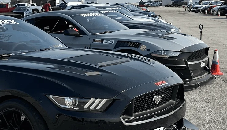

I don't recall your set up, I thought it was fairly close to Fletchers. The image below, I think it's more of a GT500 style louver. Fletcher is closer to the second image.
Here is the link to the data they collected:
chrome-extension://efaidnbmnnnibpcajpcglclefindmkaj/https://racelouvers.com/content/Race-Louvers-GT350-GT4-Wind-Tunnel-Data.pdf

Yeah similar to fletchers, but my wicker is bigger :) IDK when he added the one he's got.

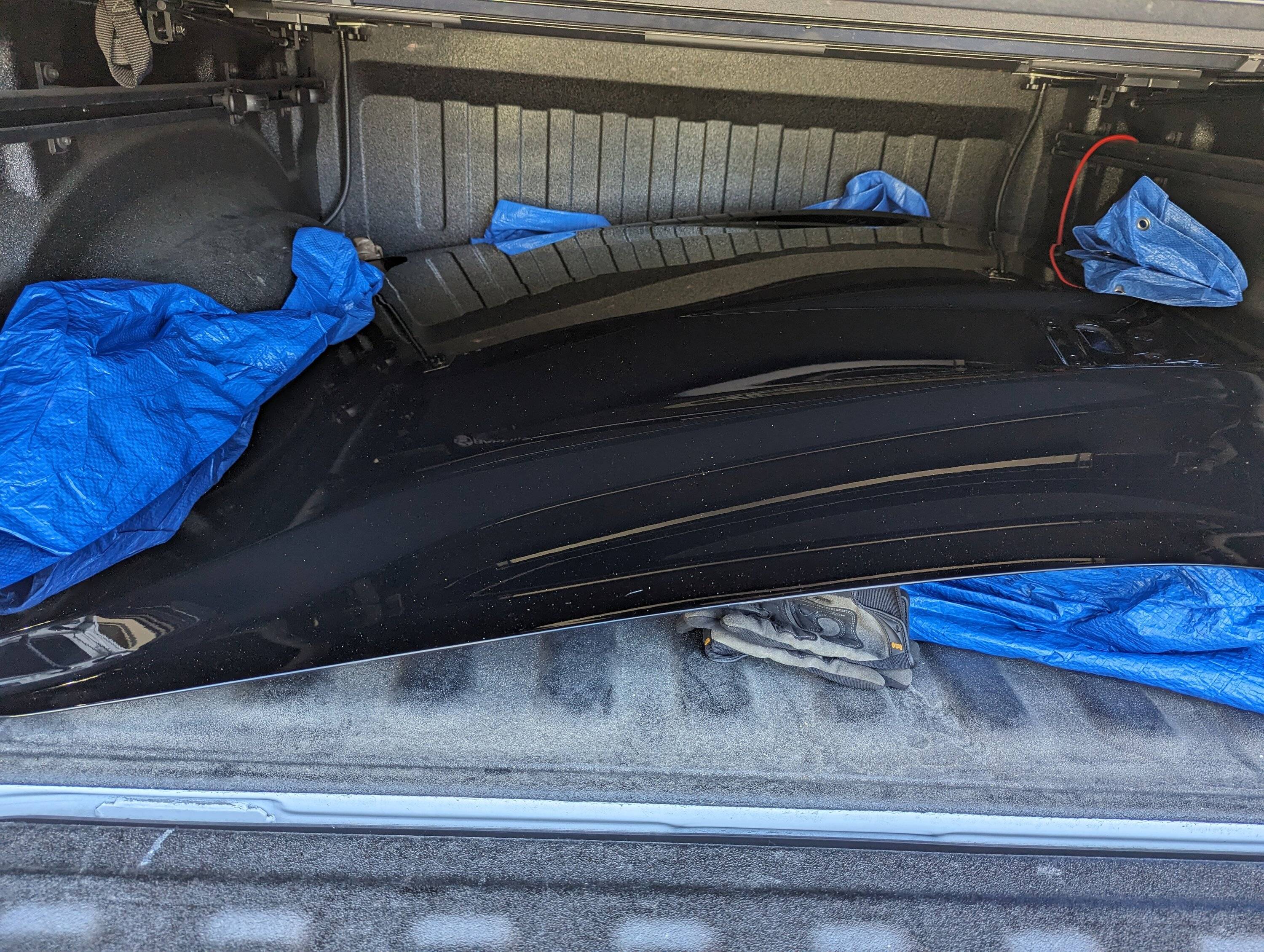

Reason I was asking - I brought home almost perfectly looking shadow black hood off '22 with two dents from road debris someone was selling on fb marketplace nearby - wanted $150, offered $100 and I got it... Won't hurt as much to cut....
So from all this discussion I get that it probably doesn't make a whole lot of difference which out of 3 versions I pick...

Chop! Chop! Chop!
Take some prep time after you cut it up in order to sand the edges and spray exposed metal. I was in a rush to get the vents in and really should have taken more time on that step.
I did my stock hood, but no regrets at all. Mostly a little rain hasnt been a problem.
