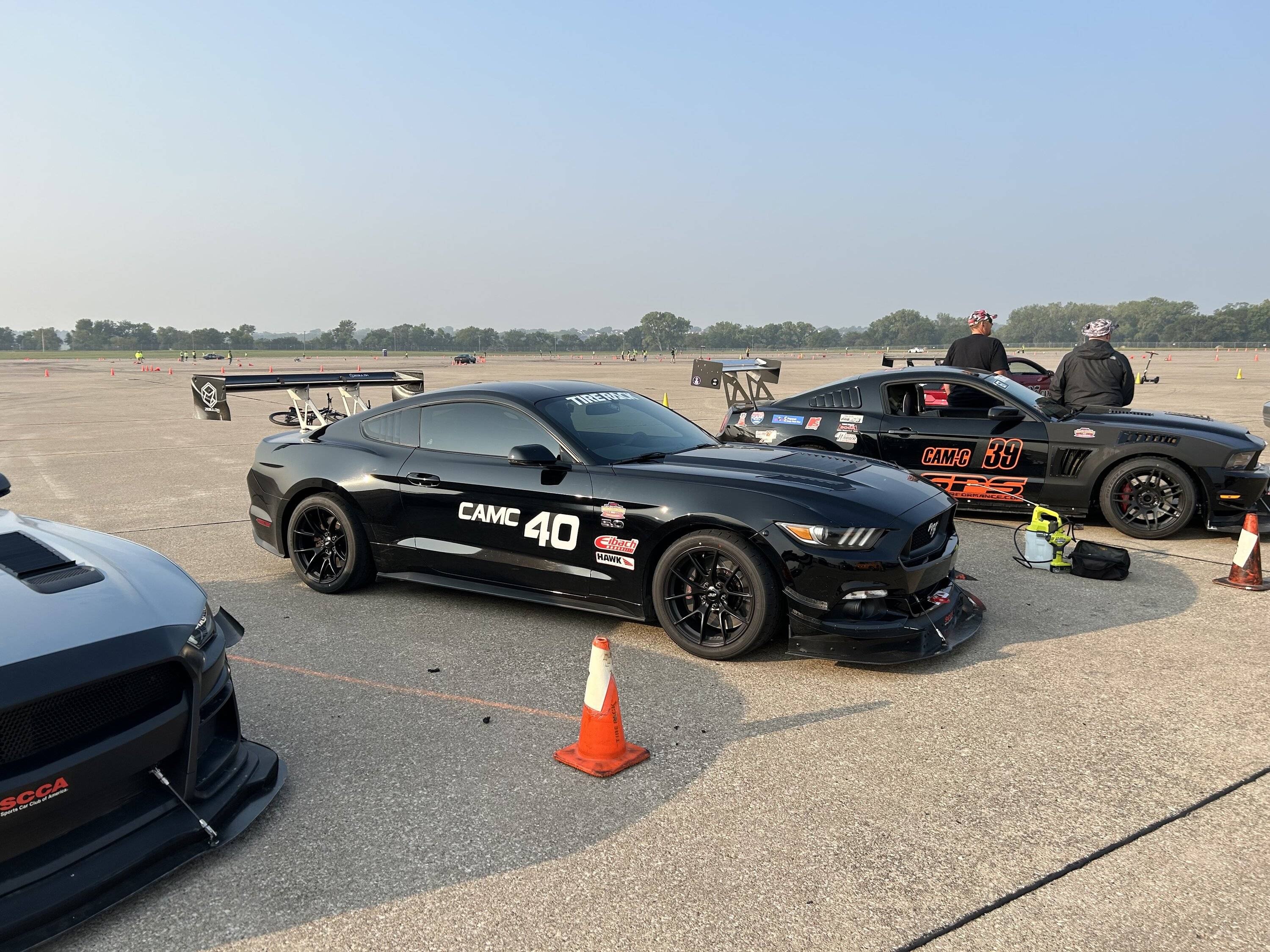

Its getting close. Got tires mounted, splitter and pit bike are off to trailer hitchhike up to Lincoln. I may be on site Sat night or sunday (no ProSolo for me this year). I’ll be paddocked in the RTRT area, as usual.
See some of you in grid in a few!

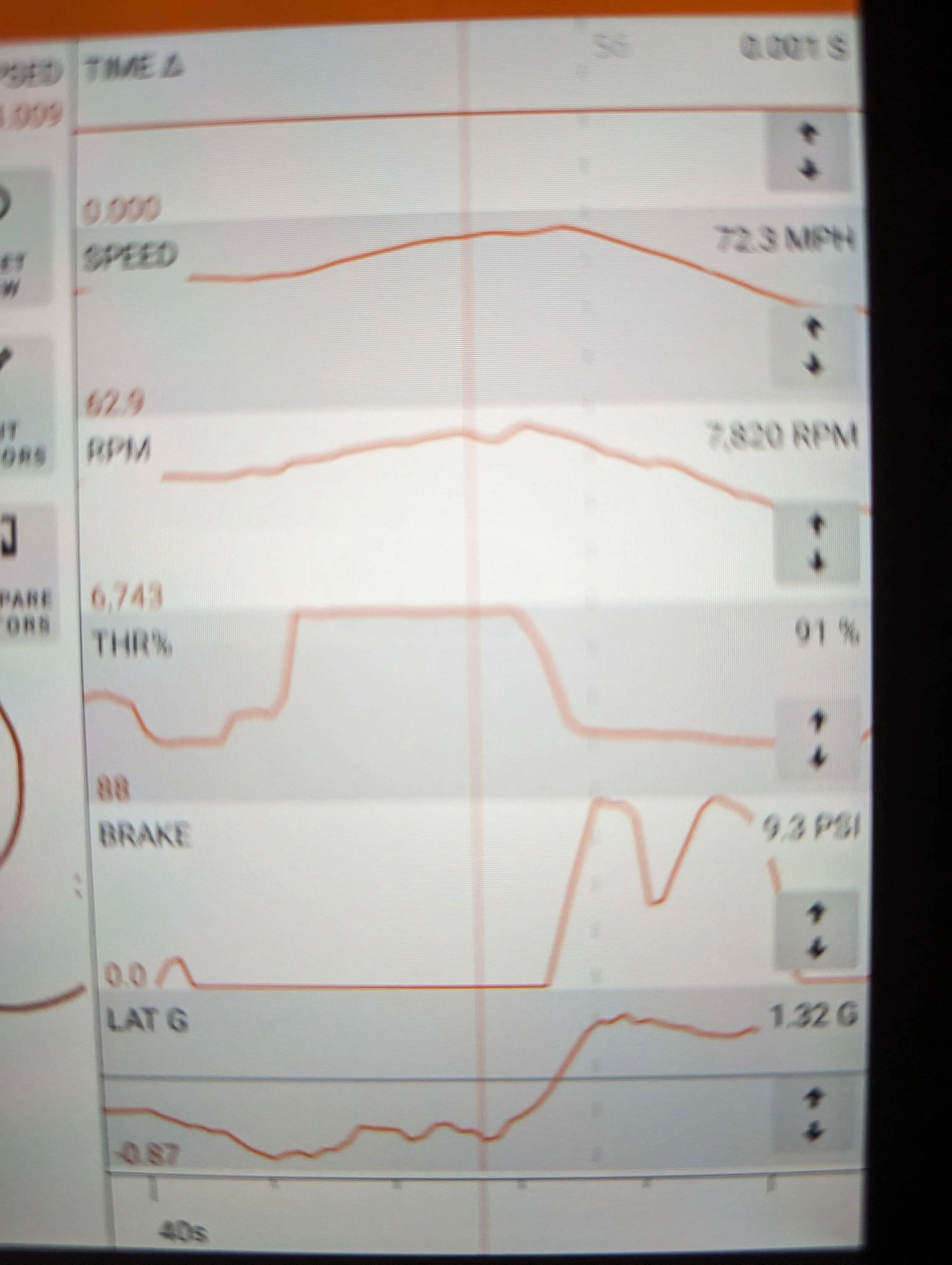

Btw - what's your max in 2nd and were you hitting limiter on East between exit of the 270 sweeper and turn into walloms ? My car was doing something that felt like hitting a limiter just before getting to the brake zone there (it felt almost like hitting the brake) but Solostorm data shows I wasn't at max 2nd gear speed or a limiter.

Picture of the Solostorm log off the tablet - throttle is all the way to the floor (disregard 88 value - I never calibrated it - it's all the way down to the floor), braking doesn't start after later but there is a dip in the rpm - it's not a limiter as the actual value (lower left) is way below the max (upper right - 7820 rpm at the finish) - any theories what could have happened ?
This was the exit from the fast 270 degree sweeper and if car was positioned properly, straight run to next, relatively slow speed corner.

My 3.73s, 18” wheels, rev limit, and ‘16 MT82 will do 64.0 in 2nd and I hit that on that 270 stretch and again into the finish.
That and the finish are also long sustained left handers, so they’re also a fuel starve situation. I think I starved into the finish at 1/2 tank. Not great. Those spots were worth time. I’ve even fuel starved on the practice course before.
Next time will run 3/4 tank both days to be sure.
Would it be delayed like a second / two after exiting the corner (like above) or instant ?
I was at slightly over a quarter.
If you're down to a quarter you're almost certainly seeing fuel starvation. There's going to be pressure in the lines for a bit. At Peak G the fuel pump runs dry and pressure in the rail starts to drop.
I know fuel = weight, but if you want to run that low you really need some sort of swirlpot to reduce fuel starvation issues with the stock tank setup.

When I had my lithium battery, my car did something very similar with a half tank on a long left hander. The cause ended up being the battery, not the fuel level. Just something to consider.
