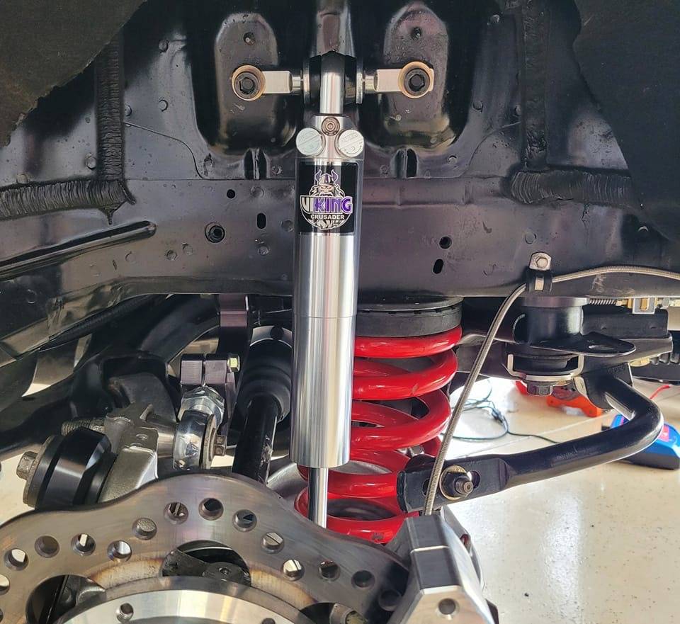

This thread is very concerning to me. I will be replacing my factory shocks with Viking inverted drag shocks soon. They will eliminate the factory aluminum upper mount thst bolts to the body and use a T-bar in it’s place.
I wonder if these can be bolted on and then welded in place for reinforcement to the body? Maybe even add the shock brace in the trunk?

Here is how the new shocks that I have on order will look and mount like with the T-bar mount. I’ll reach out to Kelly at KellTrac to see if they can be used in conjunction with the BMR shock mount for extra reinforcement of the threaded inserts and report back. It would be best to weld in the BMR mounts, but I also think bolting them in would be better than nothing, that is of course, provided they can be used with the shock.

I just heard from Kelly and he said not to use anything with his inverted shock offering. He said the T-bar integrated mounts were as good as it gets. I’m sure glad I reached out to him before ordering the BMR mounts.
