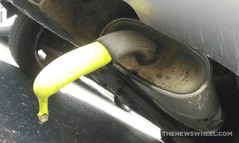

I'm curious if blocking the inner tip that's branched off the outer one really does anything, versus just sticking the outer noodle in as far as you can
i think this is dependent on the type of mufflers/tips you have. in my experience with the roush, ive only been able to jam the noodles in to about the point where the tip itself begins to bottle neck down. so prior to the point where the noodle would get to the welds you see in the pic i posted. therefore, both noodles need to be in the tips. ive had the noodles blow out of the inside tips, meaning there was sufficient back pressure and therefore noise. it's kind of an all or nothing deal- if even one of the 4 tips does not have the noodle in, it will be loud enough to defeat the purpose of using the noodles at all.
i suppose if you had one narrower but longer noodle that you could shove all the way down near the muffler, then yes, you would not need to block off the inside tips that branch off. i had already spent enough time playing around with my noodle and just left it as using one for each tip :cwl: :cwl:

maybe this can start a new competition, see who can launch produce out of their exhaust the furthest.
