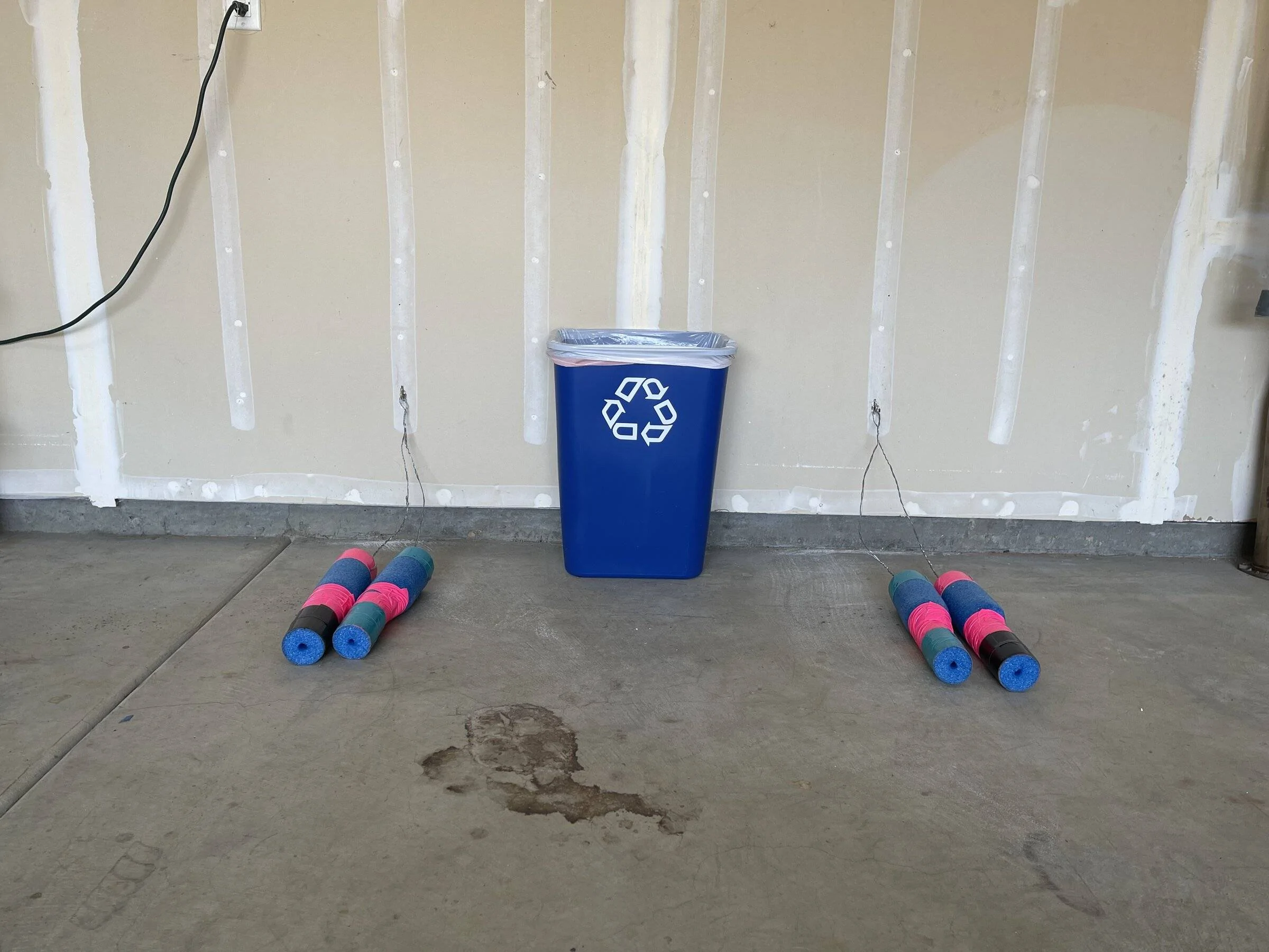

I did a similar thing, but made it automatic.
I just back into the garage the night before I work a day shift, plug em in before I leave and then drive away after 15 seconds or so. Sounds stock with the noodles in.

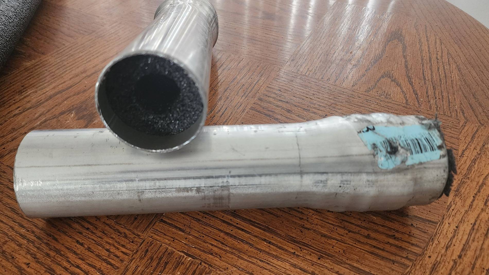

New here and thought I'd add my trick that seemed to work for my Borla S type cat backs for my 4am starts. 2 Inch pipe expanded to just under 2.5 inch on ends to plug in where the muffler joins the tip. Holds in without popping out on startup and doesn't touch the chrome part of the tips. filled center with water pipe insulation with 1 inch opening. super easy to plug/unplug.
