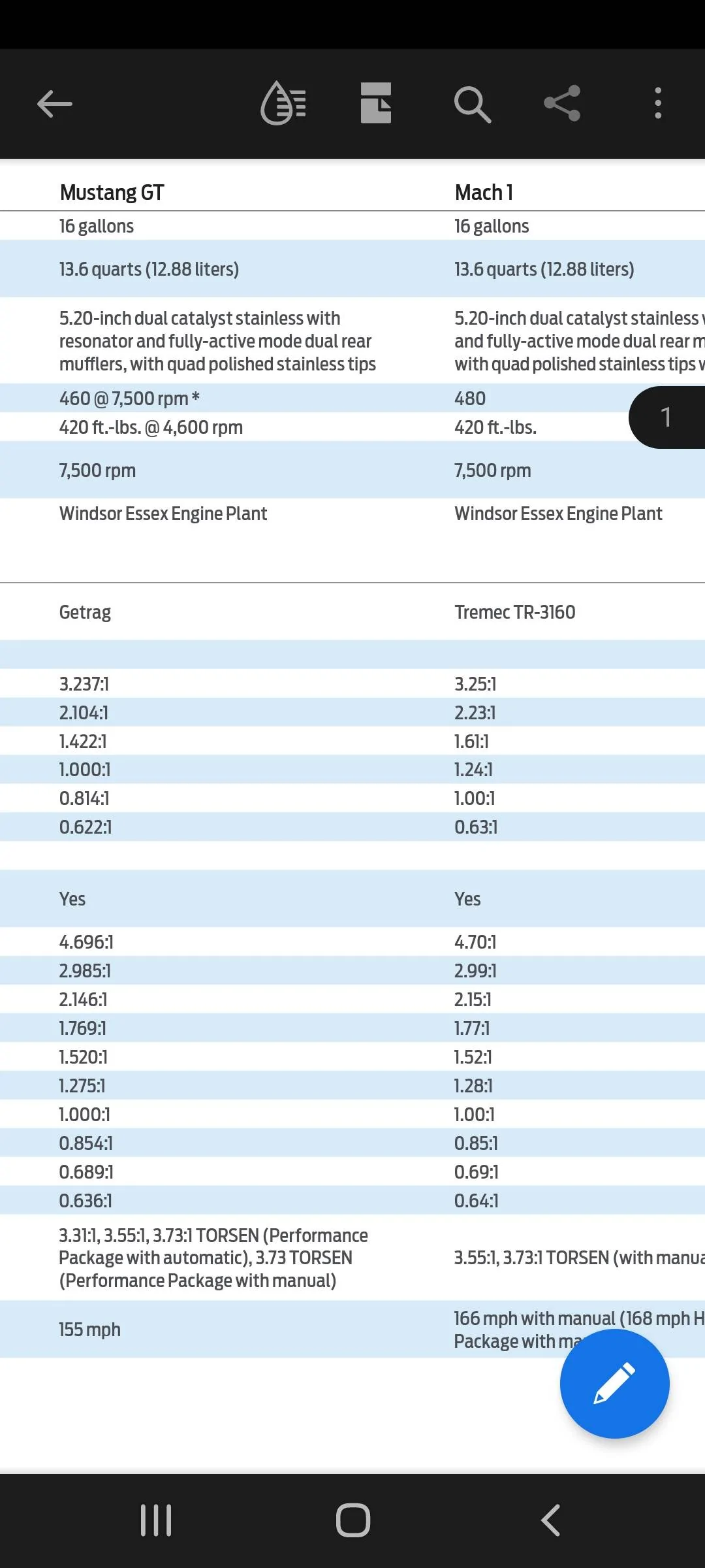

2022 Mach 1 thank you so much for that. Has me thinking about the rear end gears. I failed to mention that my '14 had 3.73's with the MT82 but only when I swapped out to 3.2x (can remember if it was 3.27, 3.23, 3.21) did the traction issues improve. As well the drivability improved in that I could now use 4th gear mostly around town, where with 3.73 I had to shift to 5th quite a bit.
Now considering that I may need to do similar on the Mach 1

@NJMike
Note that if you are using that table as a comparison to your 14 MT82, it won’t be a good guide.
I think your 14 MT82 had ratios closer to the 3160 than the above table would suggest (but I don’t have the exact values sorry) :like:
