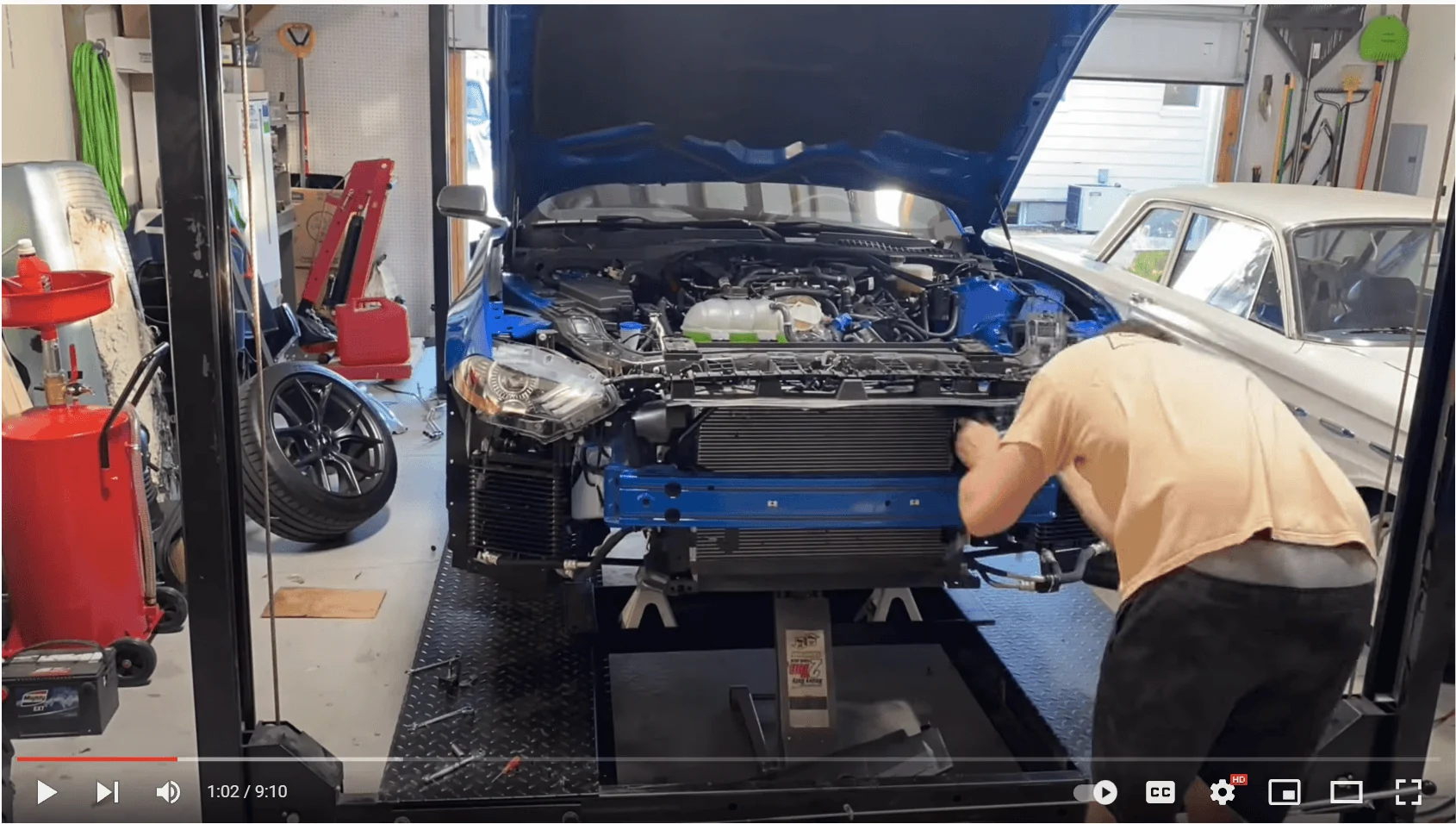

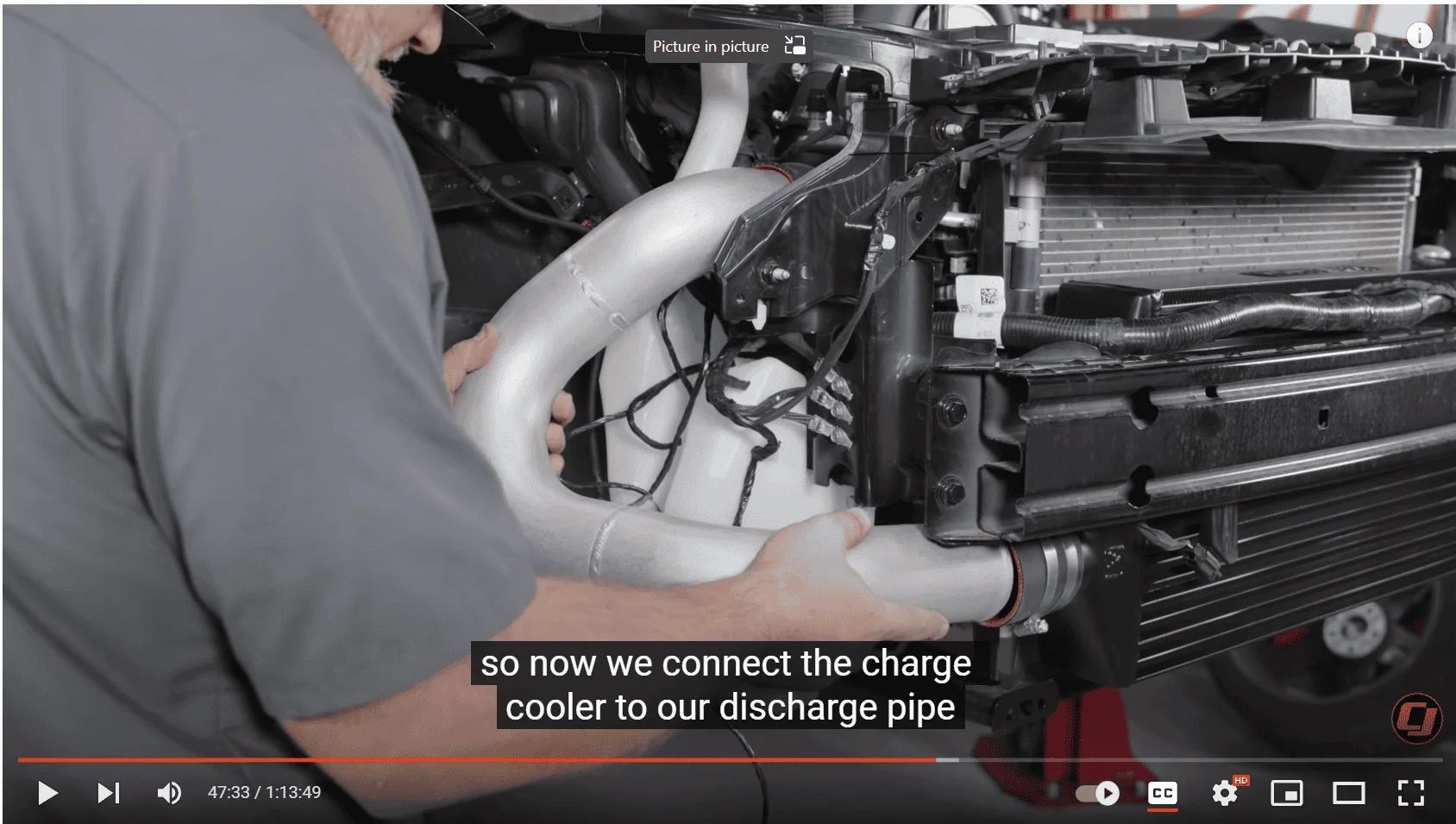

Well, I think I answered my own question about the Votech kit. The charge piping that goes into the cavity where the windshield wiper fluid tank lives will interfere with one of the Mach 1's auxiliary coolers. The top screenshot is from CJ Pony Part's Vortech install video and the bottom screenshot is from Trucknroll's twin turbo install video.
