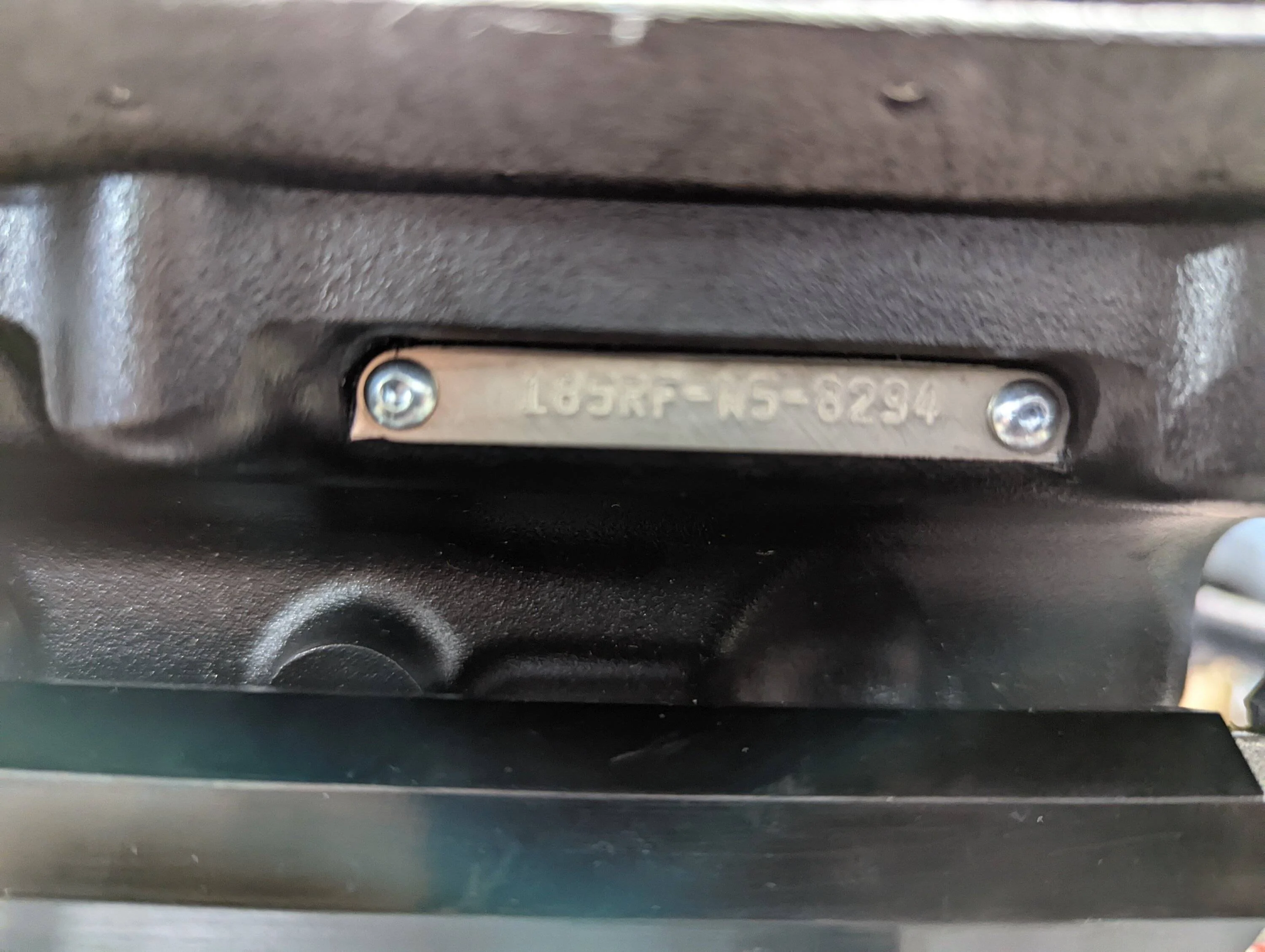

I picked the car up from Chapman Ford Horsham PA on October 29th. On November 30th or December 1st I dropped the car and all above parts off at the dealership. The technician (James) began to assemble the Whipple head unit along with the injectors and other pieces that accompany the head unit. Of course he also removed the front bumper and much of the front assembly that is necessary for the install. On Friday December 2nd he needed the ID to register the unit with Whipple for the warrantee. He was having a problem locating the serial number on the unit. It was late on Friday and JDM was able to give me the location spot.

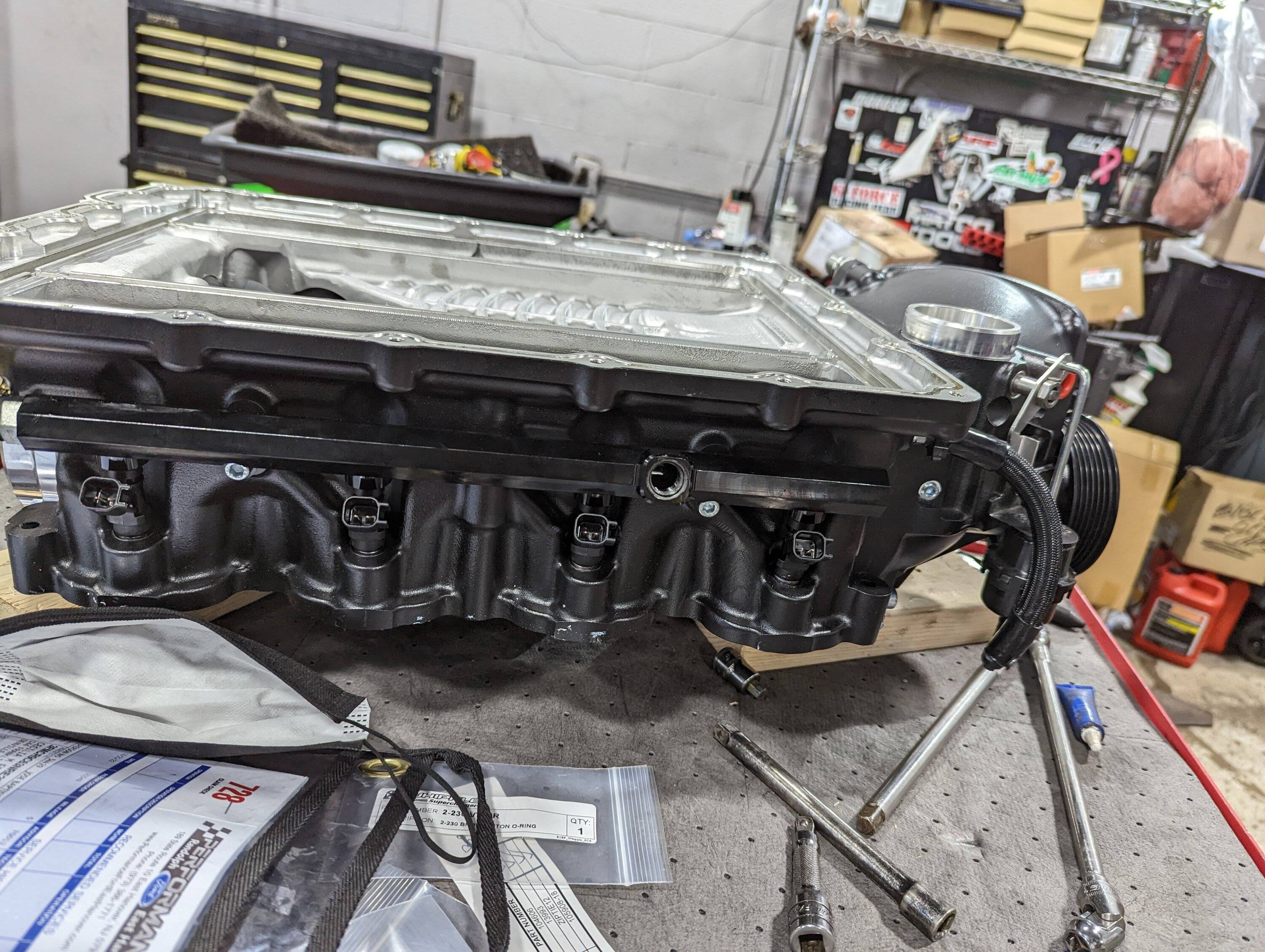

On Monday December 5th I received a phone call from James advising that he felt the head unit was not the correct part as the bolt holes on unit did not align with heads properly. It was only one bolt that was not in the right spot, but an obvious issue.
I contacted JDM to discuss the issue and after some back and forth including photos, JDM confirmed the serial number on their invoice was not the same as the ID on the unit itself. They contacted Whipple and we learned that the head unit serial ID was for an F150, not a Mustang. Please note the packing list was for the F150, but didn’t say “F150” on it, and the instruction manual in the other box with the airbox, fuel pump etc. was for a Mustang (not a Mach 1).

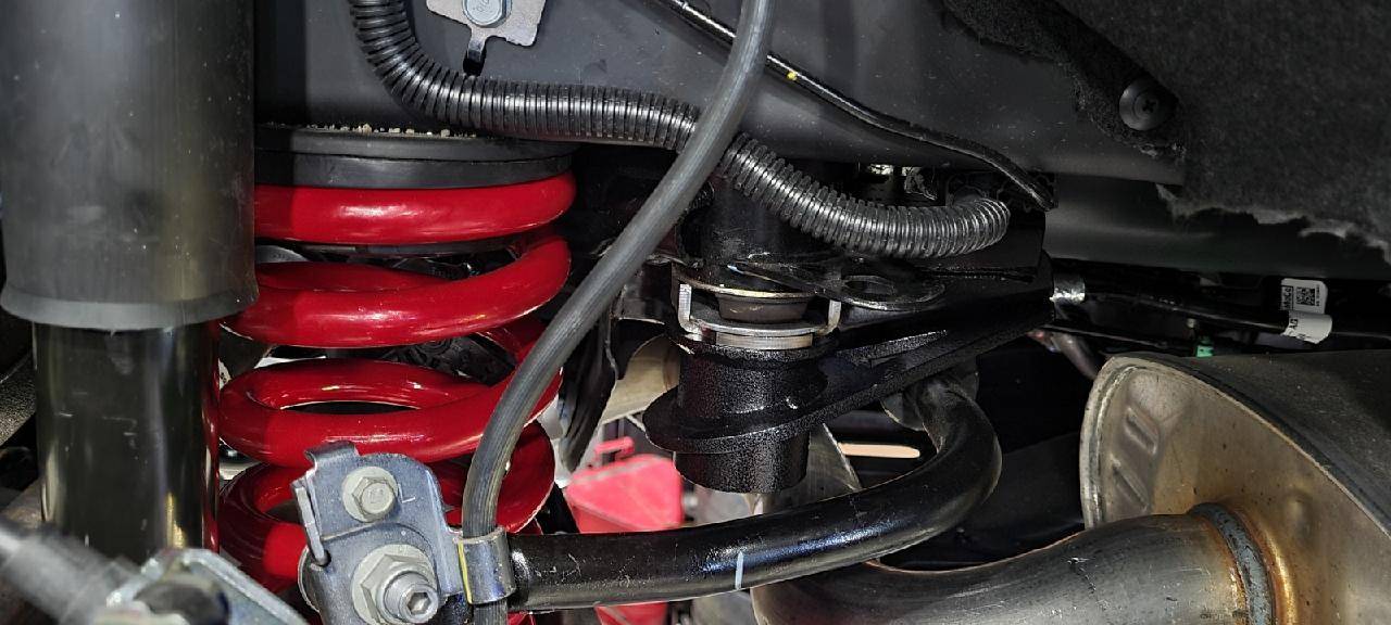

On December 21st the rear adjustable toe links, rear camber lock out & vertical links were installed along with the rear springs, subframe lock kit and cradle bushing lock out.

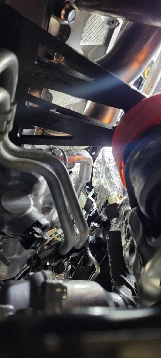

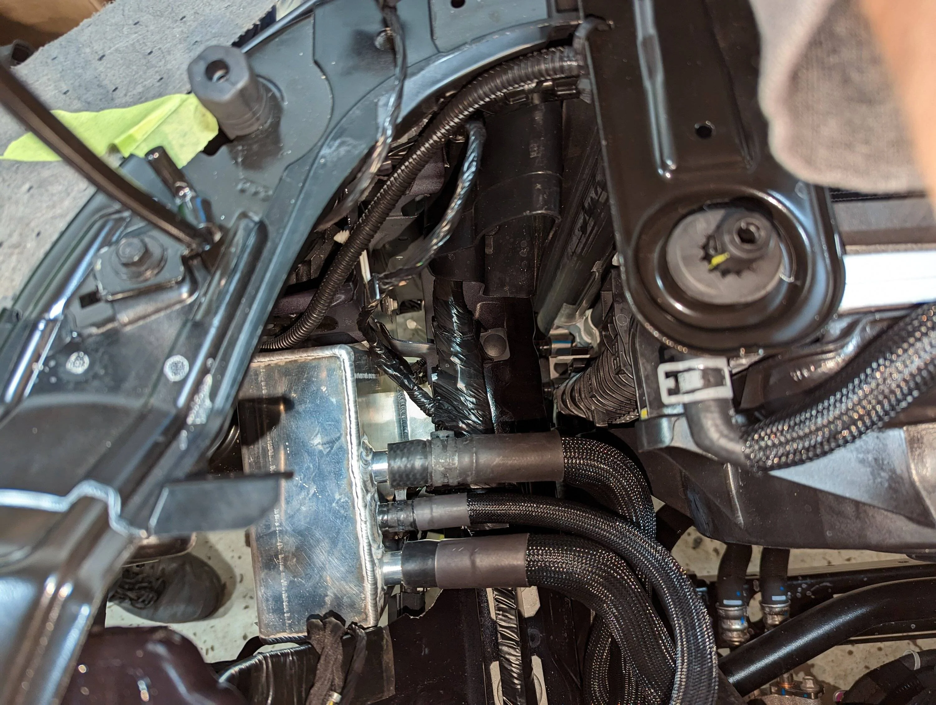

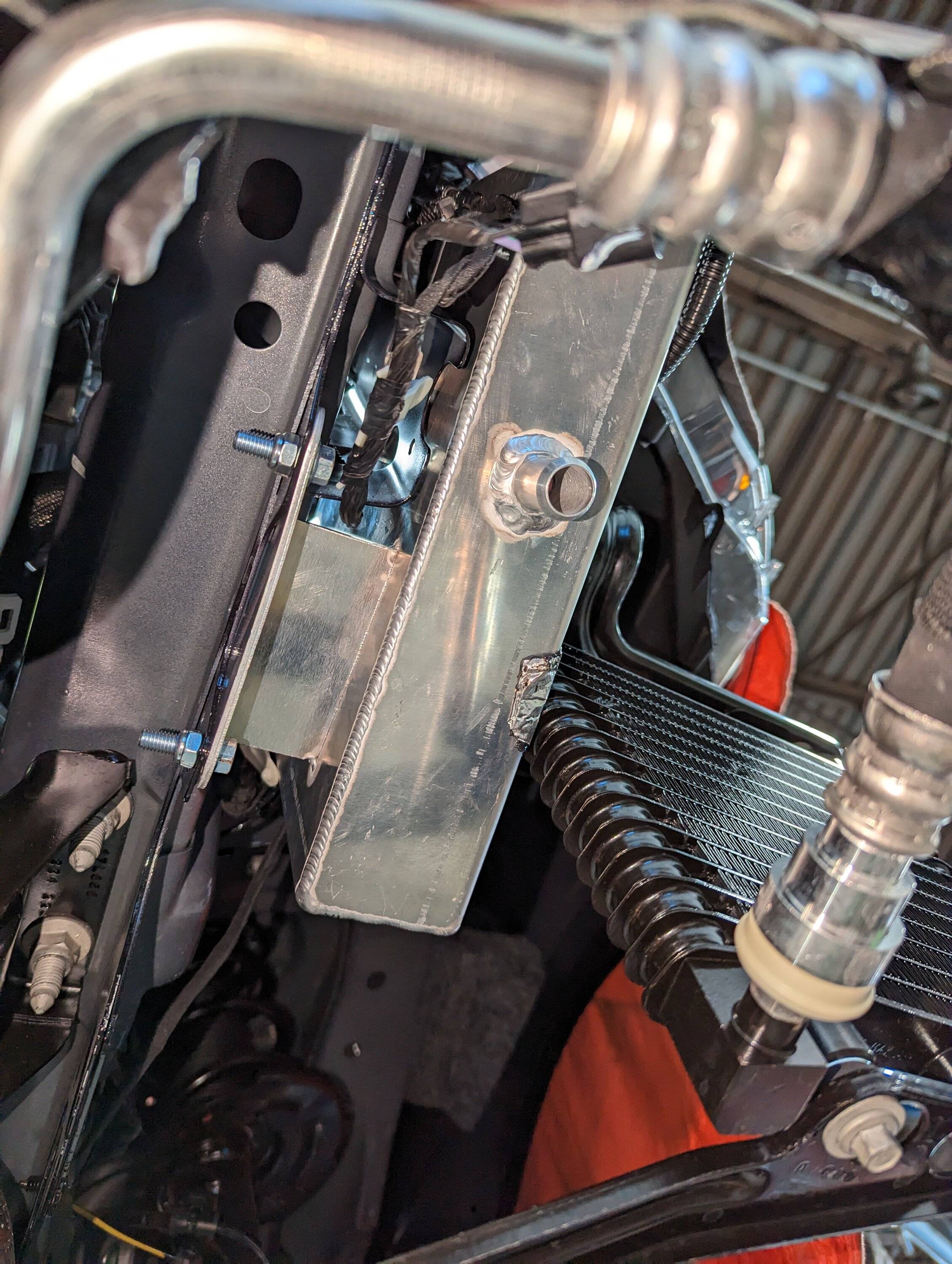

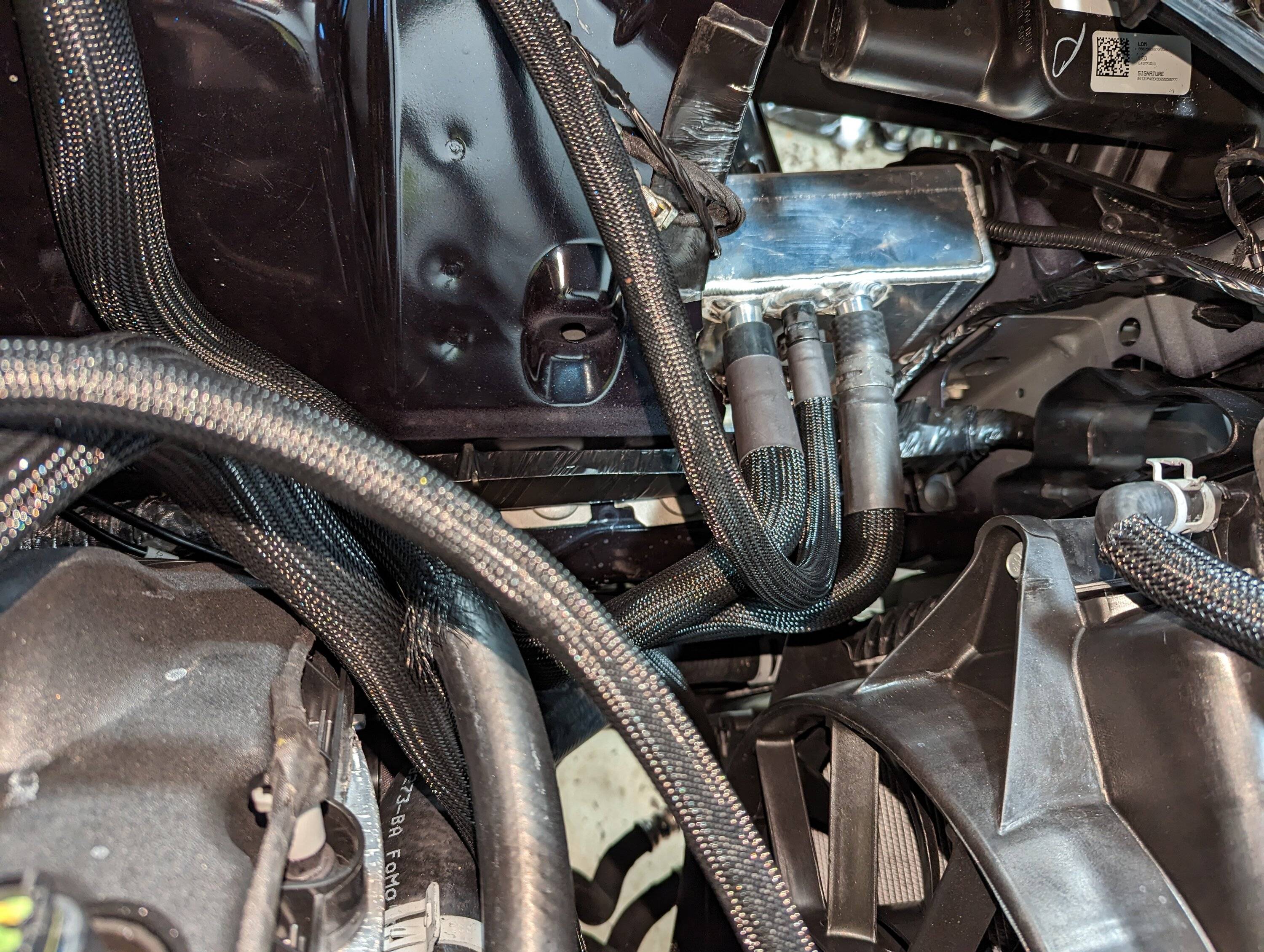

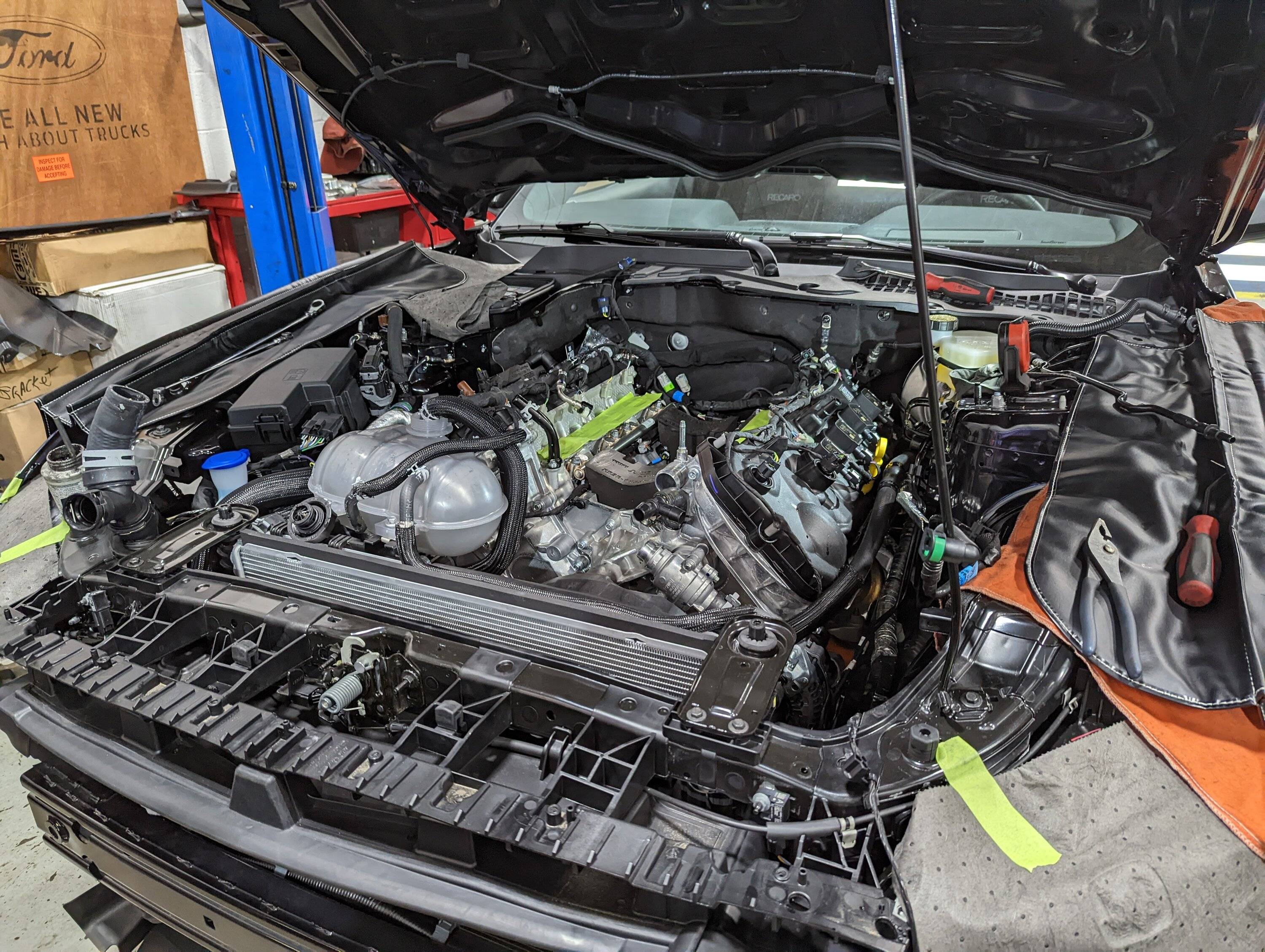

Tuesday December 27th I was advised the Whipple was installed and James got it started, but coolant tank was the incorrect part. After exchanging some photos and such Whipple felt the tank was the correct unit, so James proceeded with the install. They felt he had the tank upside down, so he flipped it over and the brackets all matched to the places where they should but not without issue…

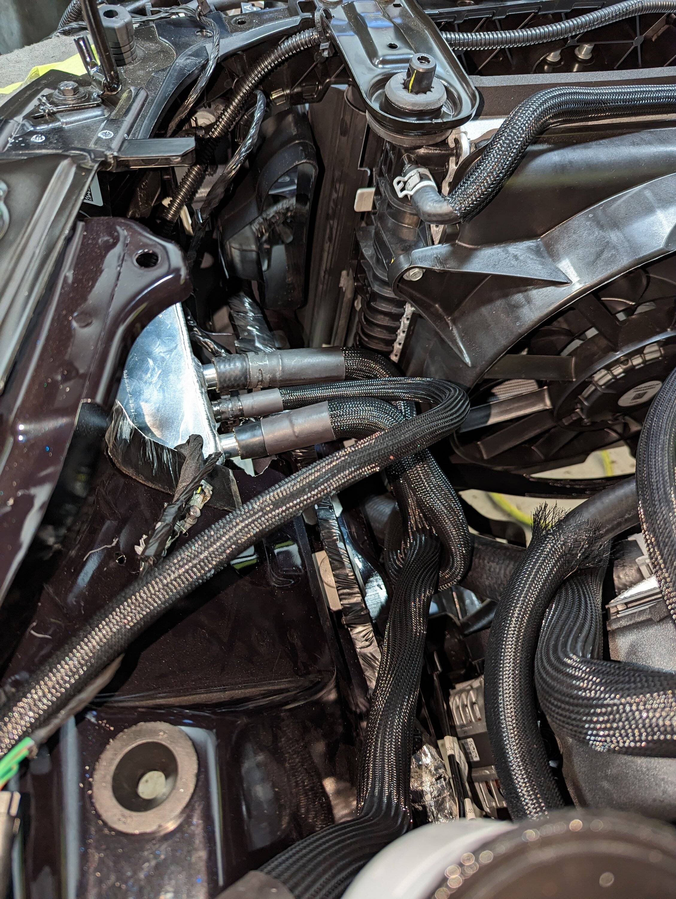

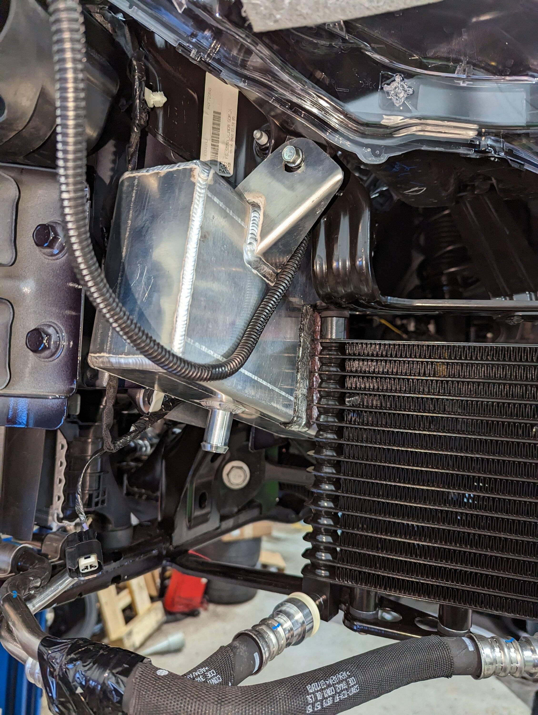

In the above pictures of the oil cooler it may be hard to see but the (Whipple) coolant tank is touching the oil cooler. James said not a huge issue but he doesnt think they should touch and the coolant tank isnt right. The tank location causes the hoses to be in the way of the Whipple provided airbox. The hoses sit too high.
Coincidentally James called Whipple again to discuss the positioning of the tank. As they pointed him to the instruction booklet, it became evident the booklet is for a Mustang and there is supplemental booklet for a Mach 1. This was yesterday December 29th.
I went to check it out with James and the airbox does not fit, he showed me that in order to drop the airbox in, we would have to trim the bottom edge of the airbox and fabricate another bracket to move the coolant tank a bit allowing room for everything to fit. While Im not a fan of this approach, there really isnt much else we can do at this point. He said he would sahve some of the plastic from the airbox and close it up again where he shaved from. More pictures and details coming later. I am supposed to take it home today.

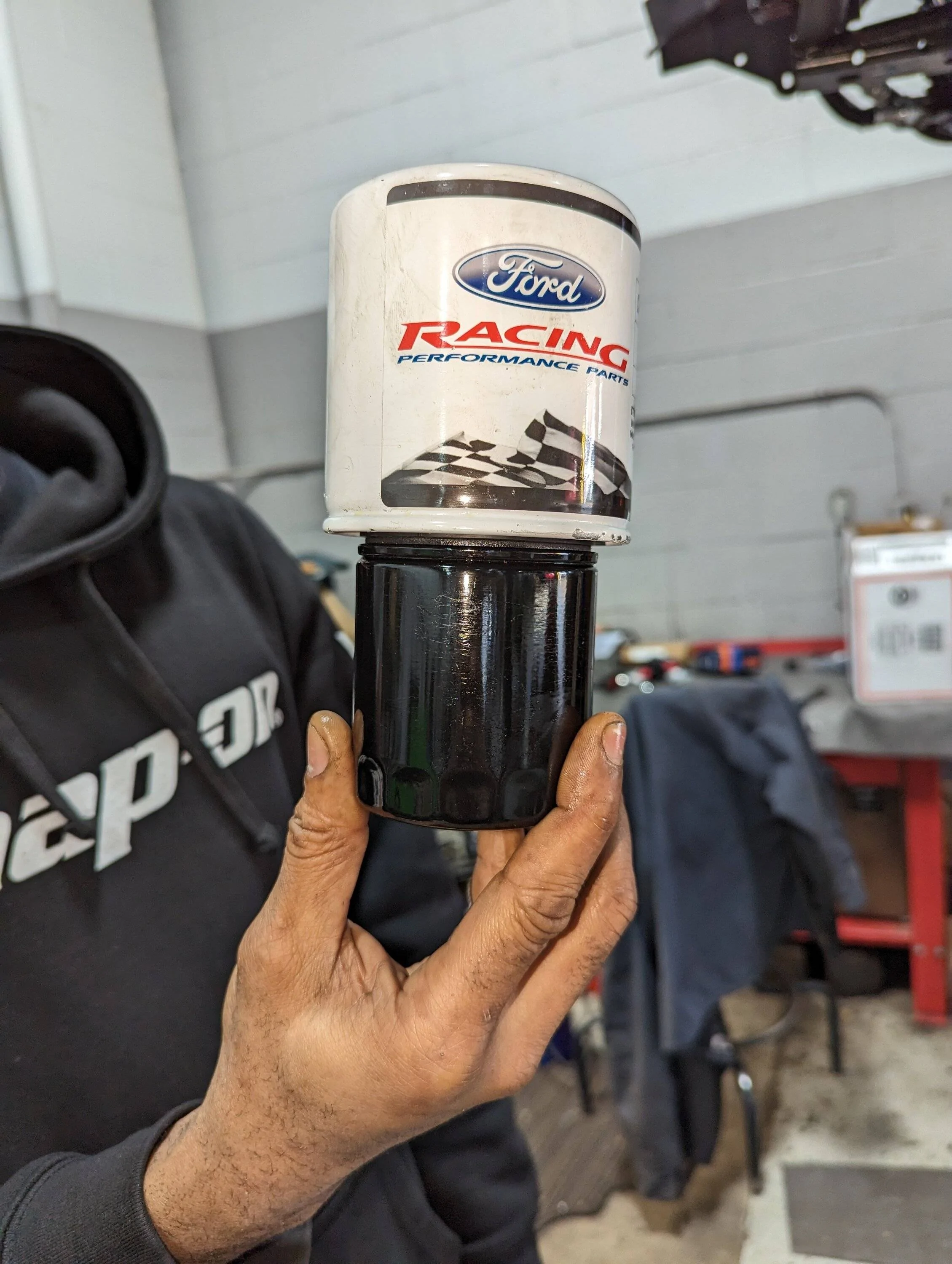

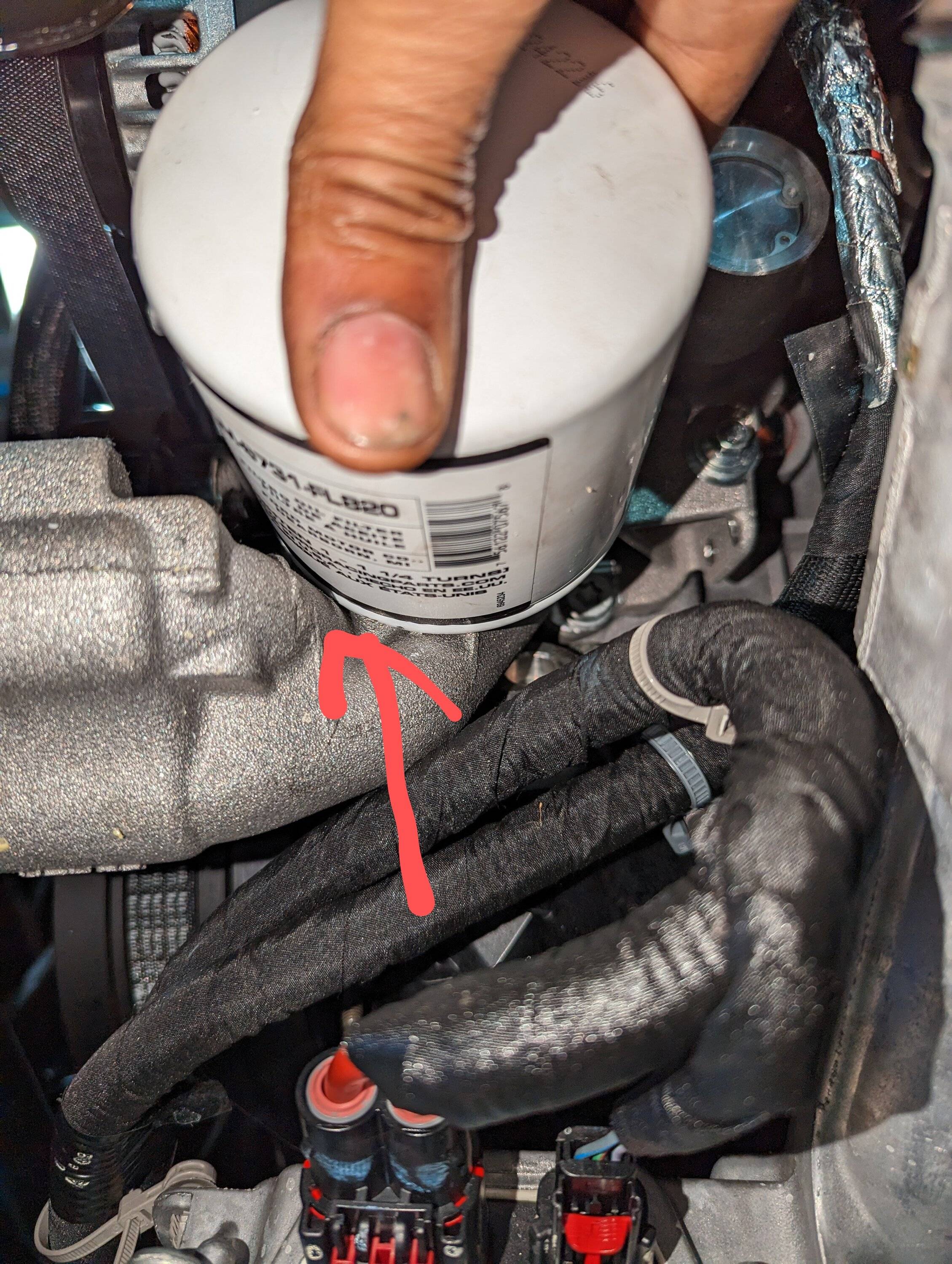

Just remembered the Whipple recommended oil filter does not fit. It is too "fat" for the space and runs into the oil cooler housing.
Here it is compared to the stock filter (black).
JDM advises they use the stock Mustang filter on their boosted coyotes and it works with no issues
