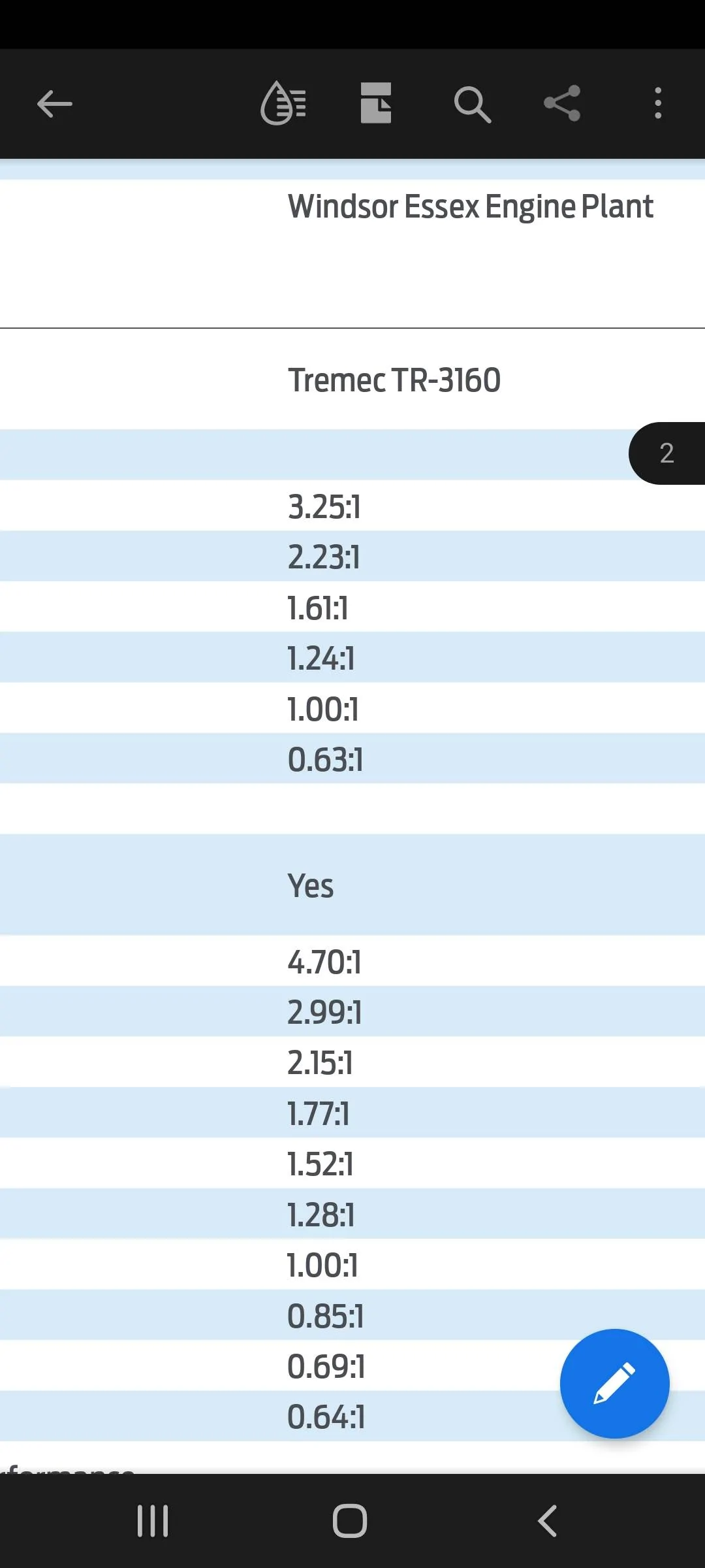

my understanding is that for the M6, centri is the answer, and whipple/PD for the auto. I do know some folks with the whipple w/ the M82 and they say 1st/2nd gear are just about useless.
Looks like the opposite would be true. The gearing on the 10 spd provides a ton more tq multiplication.
Also you'd want the PD advantage on low end tq to overcome the lack of gears. The nice thing is with a PD your always gonna be in you peak tq band on each shift.
The centri would have the benefit of the higher tq multiplication of thee 10 spd to help it get going and the tighter gear spacing allowing you to remain in its powerband.

2022 Mach 1 do you happen to have the ratios for the MT82 in comparison to the Tremec or know where I can find that?
