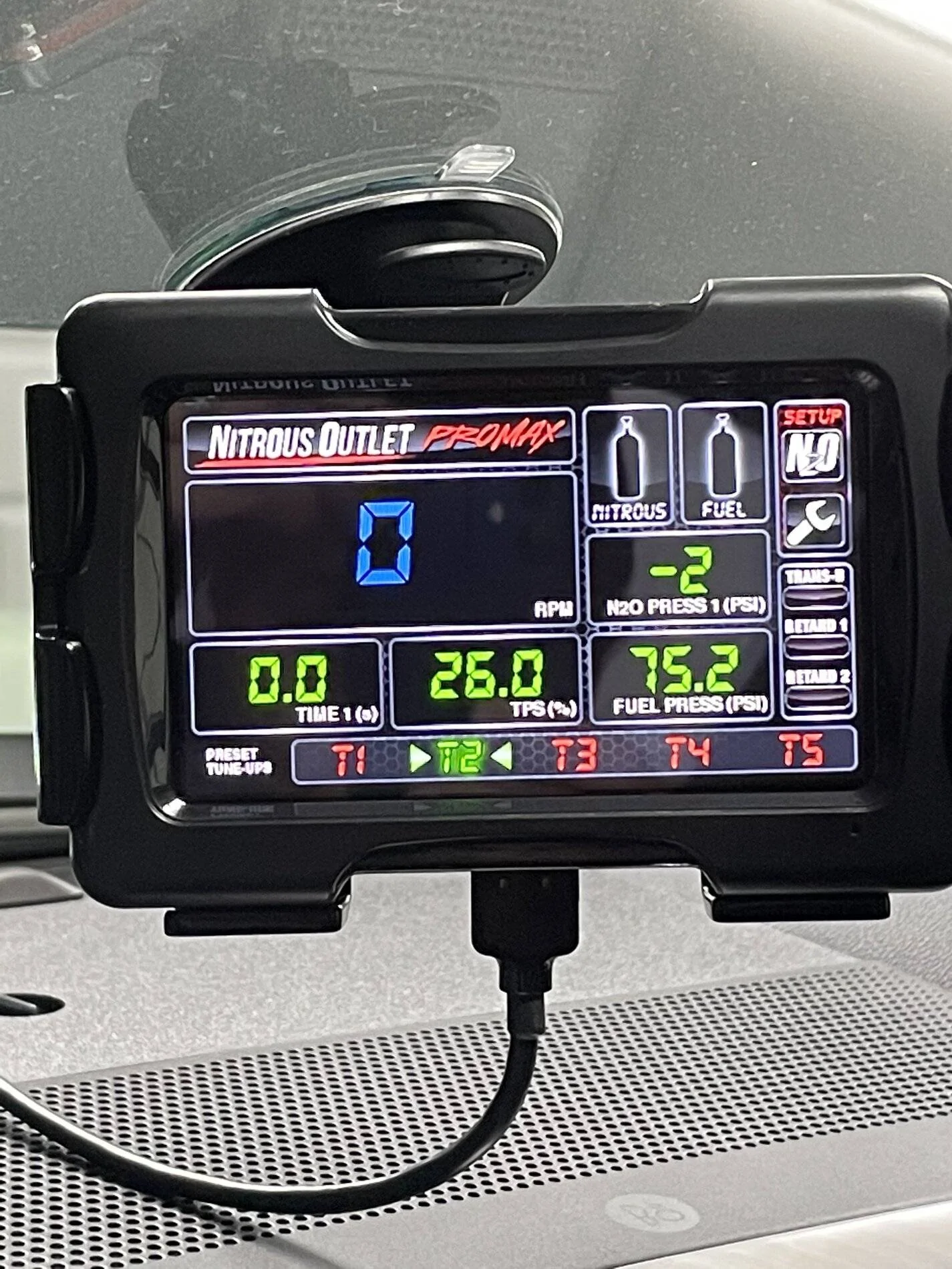

I’m going to adjust my throttle blade opening to see if that improves the condition.
The throttle body blade (87mm GM TB) has a home position at 30 degrees. This is where the blade is set when no loads are acting on it. It is held at that position by means of springs and mechanical stops.

Yes, that’s what I was referring to by changing the throttle blade home position. With no load on it (start button in accessory mode) mine read 26% before any adjustments. I zeroed it out by changing voltage settings with my nitrous controller. I’m just thinking of the process of elimination. Undoing what was done before I noticed the issue. I wish I had driven the car with the PMAS before zeroing out the TPS reading. Who knows, this issue may not have been a thing.
