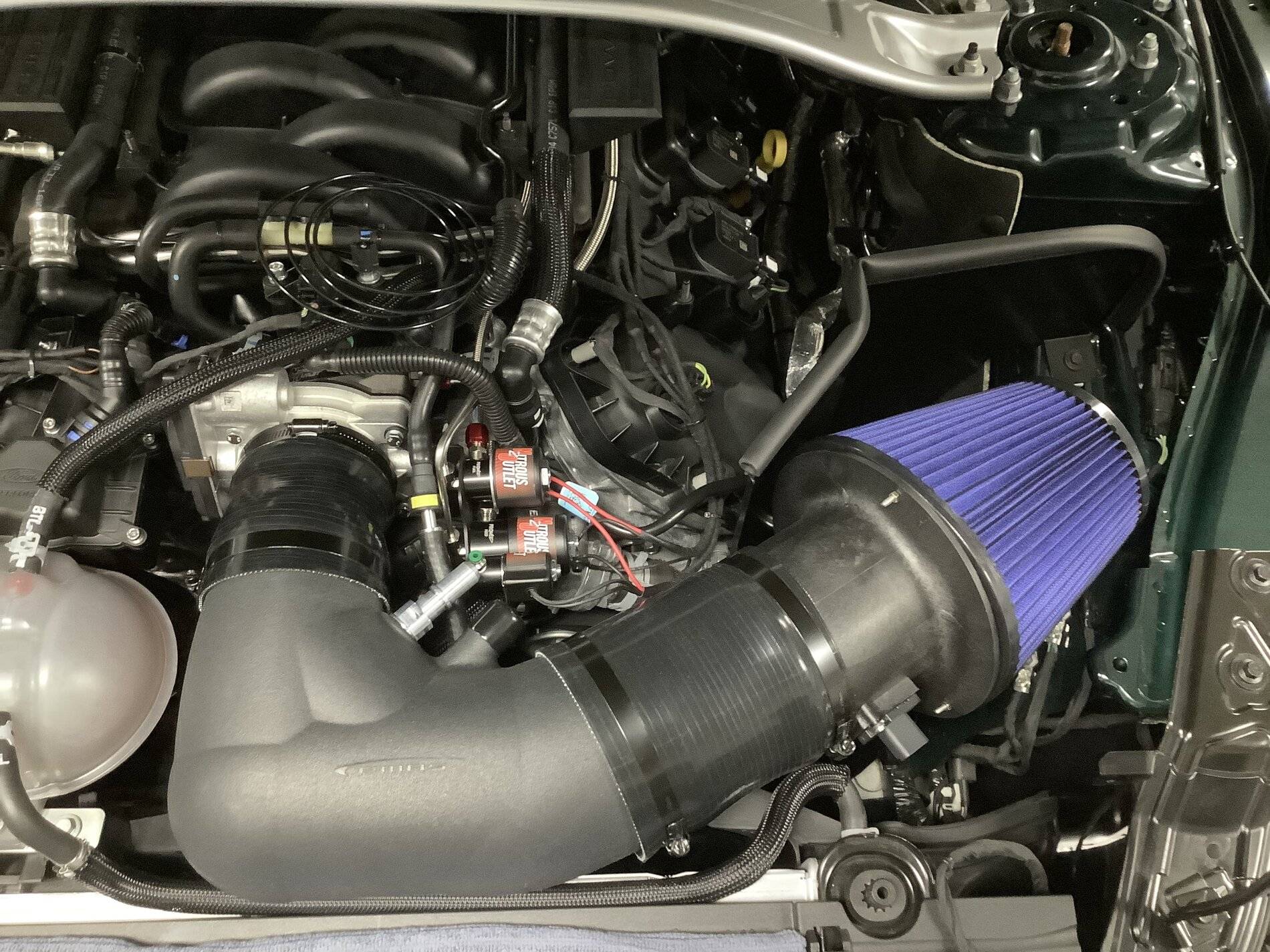

I have an idle hang issue (never a stalling issue) with my PMAS on my 2019 Bullitt. I’ve had it on the car now for about 1K miles. I am using the air intake snorkel from my GT350 air box too. Lund also told me that it was a PMAS issue with turbulent air at the MAF sensor and nothing that a tune will fix. I just pulled my sensor yesterday and sprayed it with MAF sensor cleaner and that seems to have helped some, but the condition is still present; just a few hundred rpm lower now.
How is your sensor oriented on your MAF housing? I wonder if sensor positioning determines whether you’ll have the hanging idle or low idle/stalling issues?

Yep, I was sure hoping they would take a look at it, but that’s the response they gave me. Yes, I have the PMAS supplier MAF sensor. I wish I could get hold of them to see what they say about it, but the last time I tried to call them the phone rang and the voice mailbox was full.
I take it you don’t have any issues with your idle? Can you post a quick pic of how your MAF sensor is oriented? I was wondering if this could be the reason for erratic idles. I can’t remember where I read it, but I remember reading something about clocking the sensor a certain way. I wish I had saved that information.

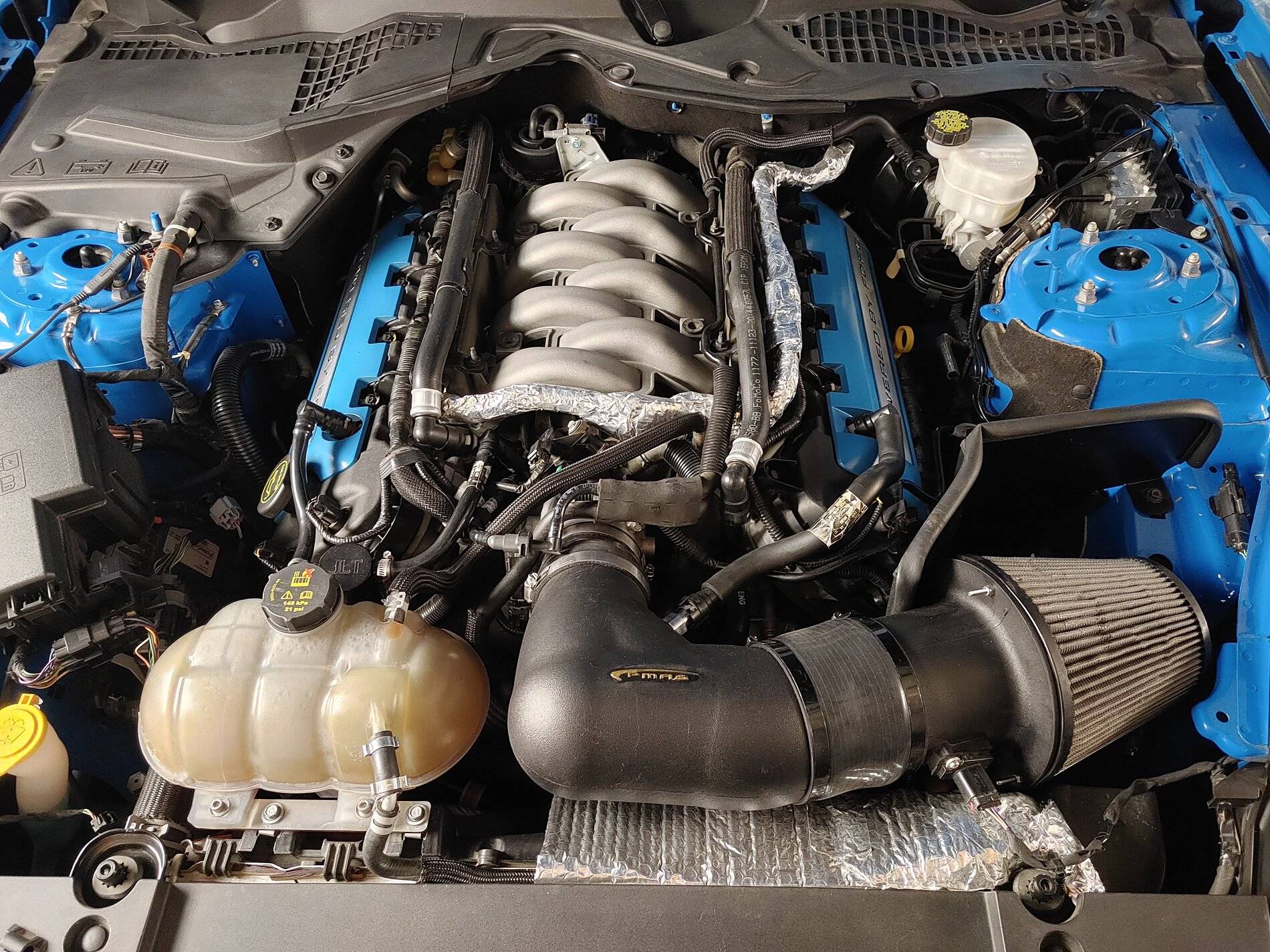

PMAS has a PDF on there website for installation. Didn't see anything about clocking.
Maybe they were talking about the PMAS MAF?

That looks like the exact same orientation as my sensor.

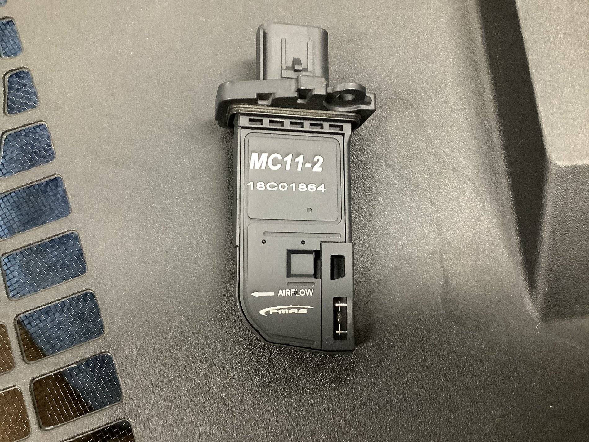

I find that hard to believe Lund said that, as the PMAS has without a doubt the cleanest MAF signal of any aftermarket CAI, AAI, whatever you wanna call it out there. Stock MAF or PMAS supplied MAF ?
This is the MAF sensor that PMAS supplied with my air intake kit.
