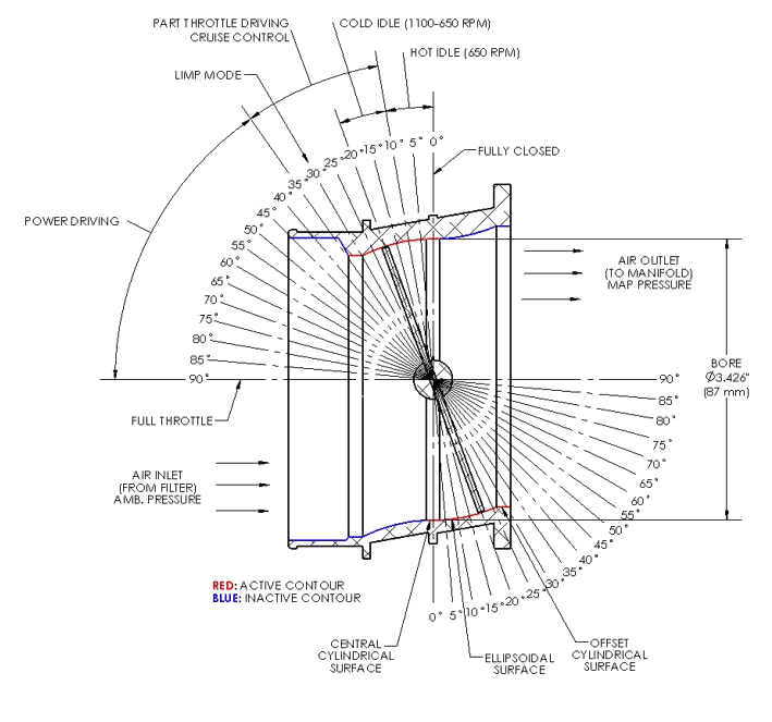

This might sound a little crazy, but I was just going through some old photos of when I was programming my ProMax nitrous controller. In the beginning, when I first powered up the ProMax, my TPS reading was at 26%. Needless to say, I adjusted the voltage to where it was reading 0% at closed throttle and 100% at WOT before the first drive and the idle has been hanging ever since. I wonder if this could have i diced the ha going idle? Should I try going back to the original voltage setting to see if that clears it up? Just trying to backtrack and see where I might have gone off-road here.
As a laymen that deals with 4-20mA signals used for flowcontrol valves, mass flowmeters, pressure transmitters etc. 0% = 4mA.
0% doesn’t = 0mA. Where as 100% open = 20mA unless of course I’m dealing with falling rate vs rising rate.
Off the cuff, the TPS @ idle shouldn’t read 0%.
Your reading of 26% is possibly the throttle blade home position which is typically 30 deg from full closed.
Keep in mind you have the 87mm General Motors S-style TB. The blade position angles at low speeds require more blade opening than a straight bore TB such as the FoMoCo 80mm

My throttle reads 10% at 650 RPM idle.

Gotcha! What does it read at WOT (somewhere in the 90+% range)?
Thanks for posting the throttle chart; it’s very helpful. I’m going to adjust my throttle blade opening to see if that improves the condition. It’s super easy to adjust the voltage. I can see the actual position in real time. I’ll start at 10% and work my way back up to 26% where it was before I made any adjustments and see what happens.
