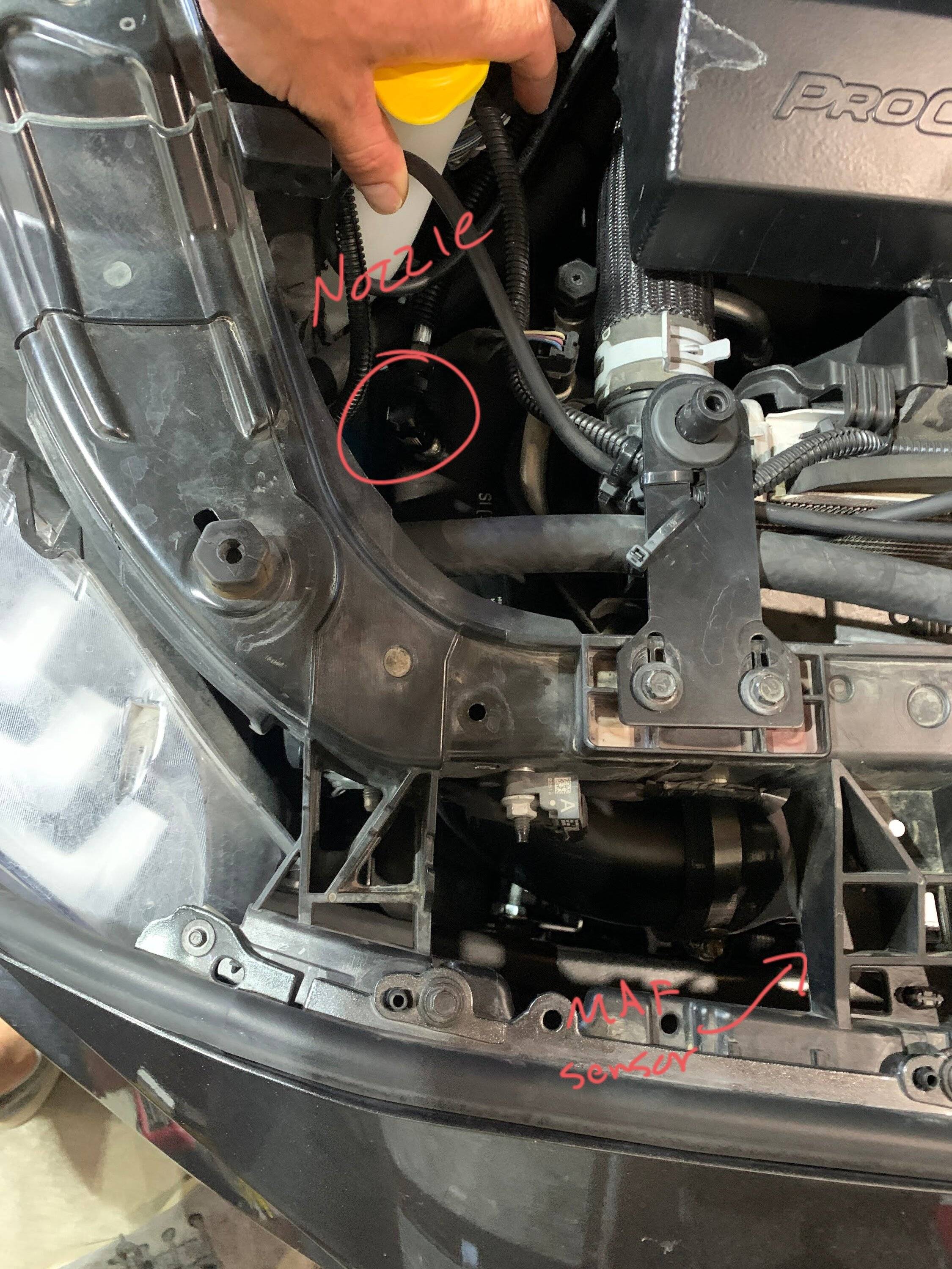

I did add a water/methanol nozzle to the car about a month back purely to help with knock prevention. You can see in the picture below, the nozzle is over 12" upstream from the MAF sensor which is in the intercooler. Is it possible that the methanol injection has found a way to mess of the MAF sensor? I would assume this would also result in fuel trims being off across the board or a code coming up which has not happened.

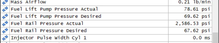

The only thing that I can see in the logs that looks off (and I just noticed this) is the the fuel rail pressure looks like it is way high. With the car warm and engine off, it was reading at 2,591 psi. When the car starts, it seems to stay north of 2kpsi even though the tune is only commanding around 400psi. I was always looking for low fuel pressure but is it normal for the fuel pressure to stay that high?
