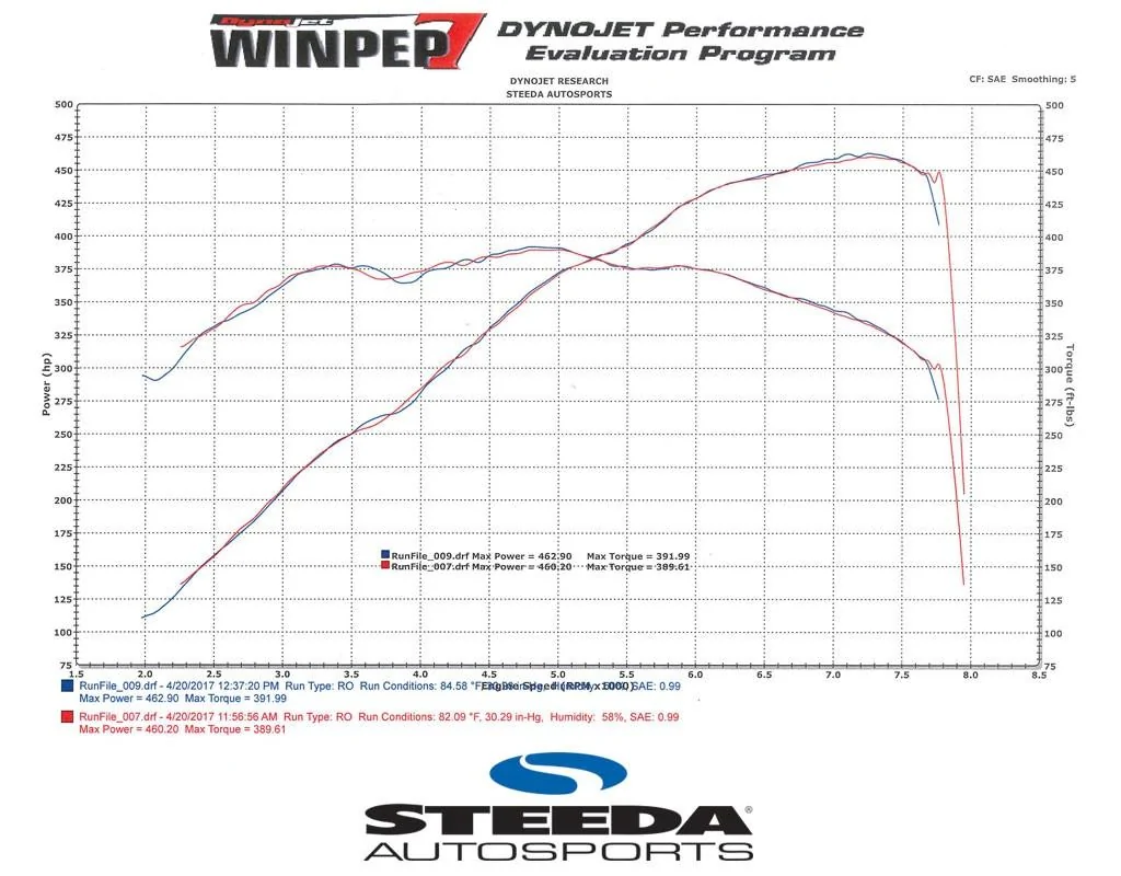

Steeda CAI, Long tube headers, GT350 intake,stock throttle body,pump gas and completely stock motor! Outstanding drive-ability!

Cat deletes on this setup or with cats?

If Steeda is getting decent results on the 350IM I might have to upgrade soon. Dyno looks good.
[MENTION=25806]SteedaTech[/MENTION], any results with catted long tubes? Curious what the drop off is.

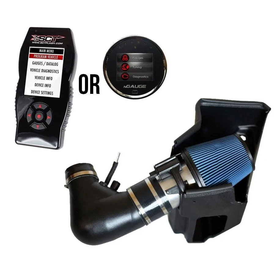

We sell a ton of Lund Racing tunes with PMAS intakes. It's a very popular combo that works very well.
If you have any questions or need help placing an order please feel free to give us a call. We're here to assist you!
Thanks, Jared
http://www.lethalperformance.com/le...-and-lund-racing-custom-tuned-programmer.html
I already have a PMAS intake and am interested in adding the Lund tune at some point. So you can get it loaded on the SCT tuner or nguage... Advantages/disadvantages of each? I know little about tuning.
You can get it tuned sctX4 or Lund nguage. Nguage just stays plugged in to obd2 port and will give you reading on all sensors and stuff , plus shift light. Very quick swap of tunes too. SCT x4 you can read everything too swapping tunes is a little more time consuming you always have to return to stock but both are great.
You can get the tune for either the X4 or the Lund Racing Ngauge. Both devices work very well. The advantage to the Ngauge is that it's small and can be mounted as a monitoring device for you to view vehicle parameters and such. It's got advanced datalogging features as well. The X4 is just a larger device that most people don't mount and toss in the armrest or glove box.
Let us know if you have any other questions or need assistance placing the order.
Approx 5 to 10 hp drop

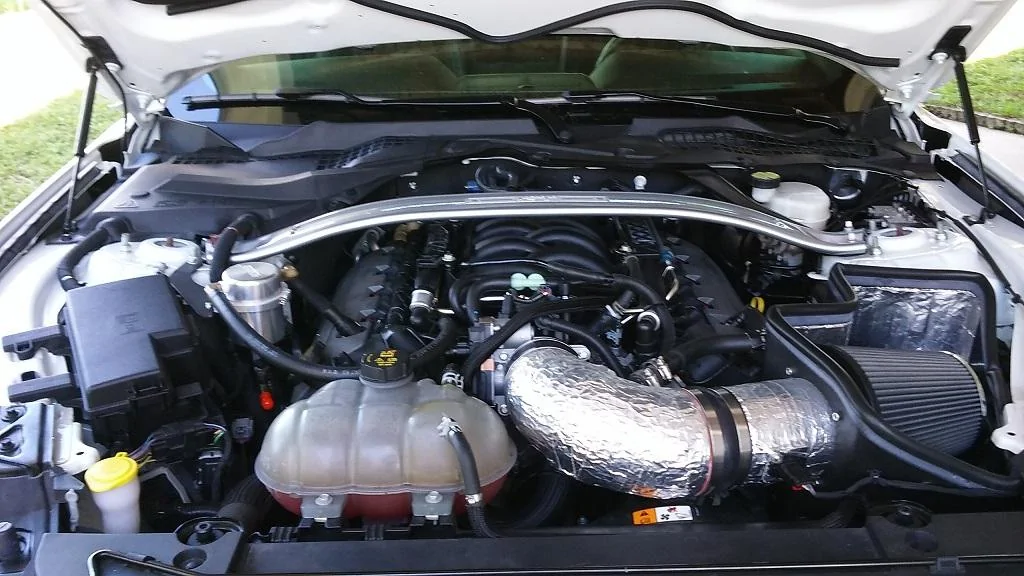

I choose to go with the Steeda CAI back in the fall of '15, no restrictor and their tune with SCT X4 tuner. Love it!
The Steeda air tube has a sweeping bend rather than the abrupt PMAS bend, seems less restrictive to me...
The IAT dropped 6-7 degrees from stock. I added the insulation and got another degree drop.
The Voodoo IM & TB swap is about a week old now, tune was done at Steeda on their dyno. Excellent drivability, track results to follow soon...
