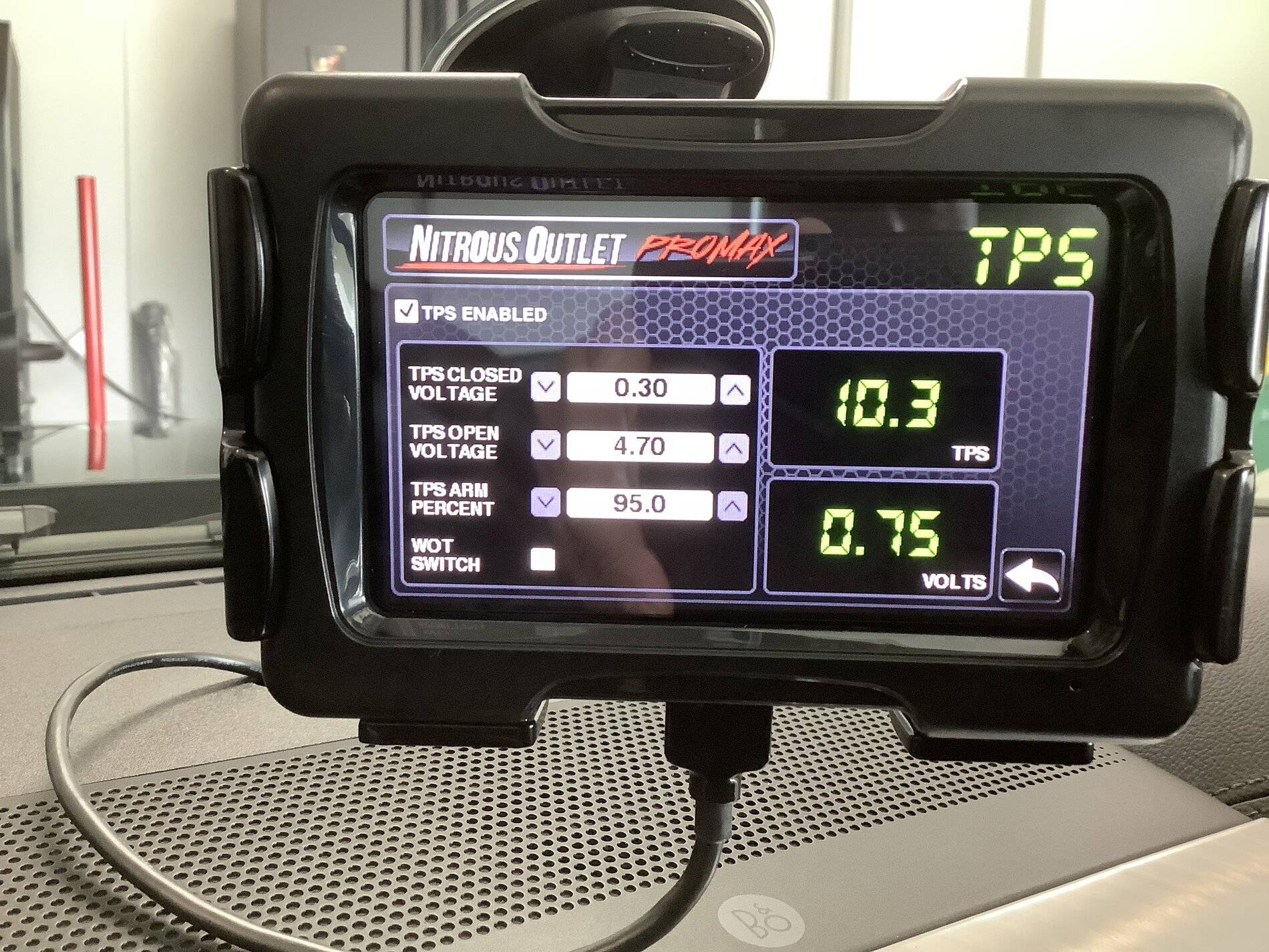

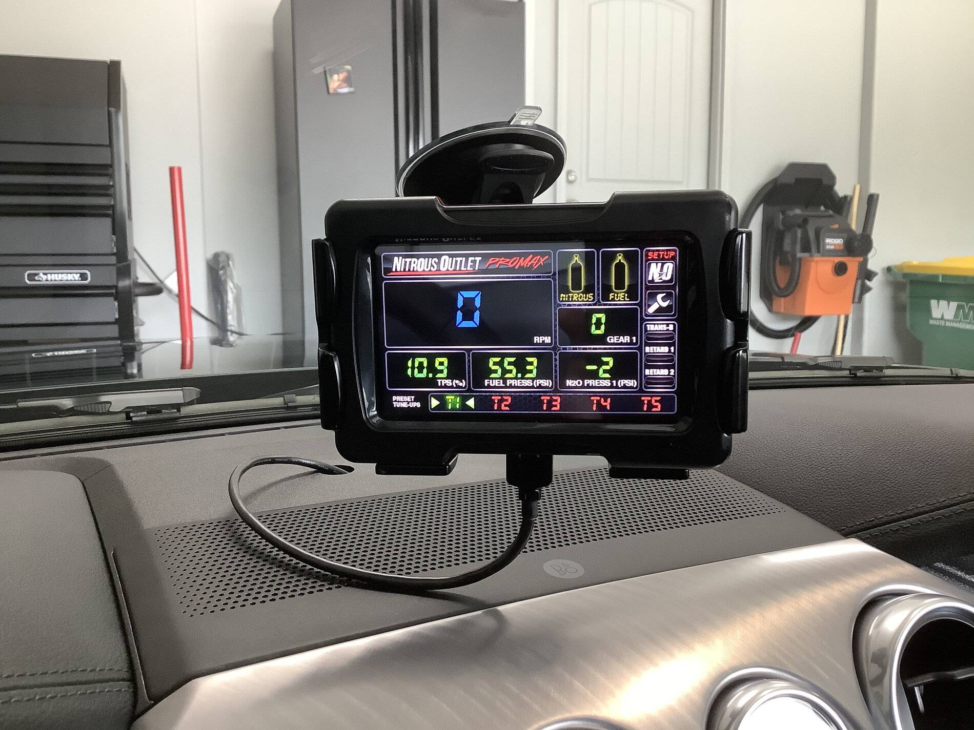

Ok, here’s what I got GregO..
Before adjustment. Disregard rpm, as I didn’t let it settle down to normal idle speed after cold start.
After adjusting TPS voltage.
NGOT8R
Jul 19, 2020
154
9,407
7,903
Adrian
2019 Bullitt
Video #1
Video #2
Looks like I may be good here after the adjustment! I’ll know for certain once I take the car out for a nice drive.
