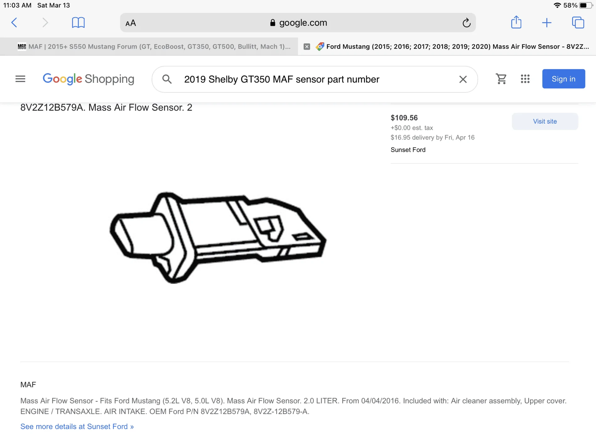

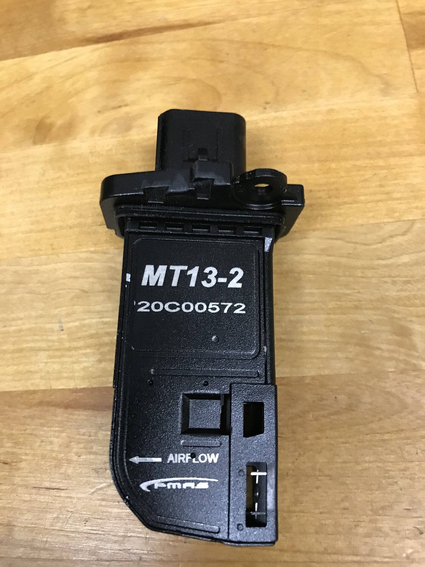

This is the MAF sensor that PMAS supplied with my air intake kit.
Your picture of the MAF sensor is stenciled as MC11-2 whereas my PMAS no tune MAF sensor is MT13-2.
That’s enough to raise one’s eyebrow.
I think you have a GT350 No tune MAF sensor on your hands. Not the GT 5.0
Yes, I took notice of that, however; the MC11-2 is showing to be the sensor for the GT350 PMAS air intake kit. My guess is that they each use a different resistor; possibly due to different air flow rates between the GT and GT350 intake manifolds. Something else that I didn‘t think about before is, I’m using the 20* angled coupler between my throttle body and air intake tube for clearance. I’m wondering if this could also be causing additional turbulence? It seems as though most PMAS users who have encountered issues are having really low idle or stalling problems, whereas I am experiencing the opposite. I really am baffled by this.
