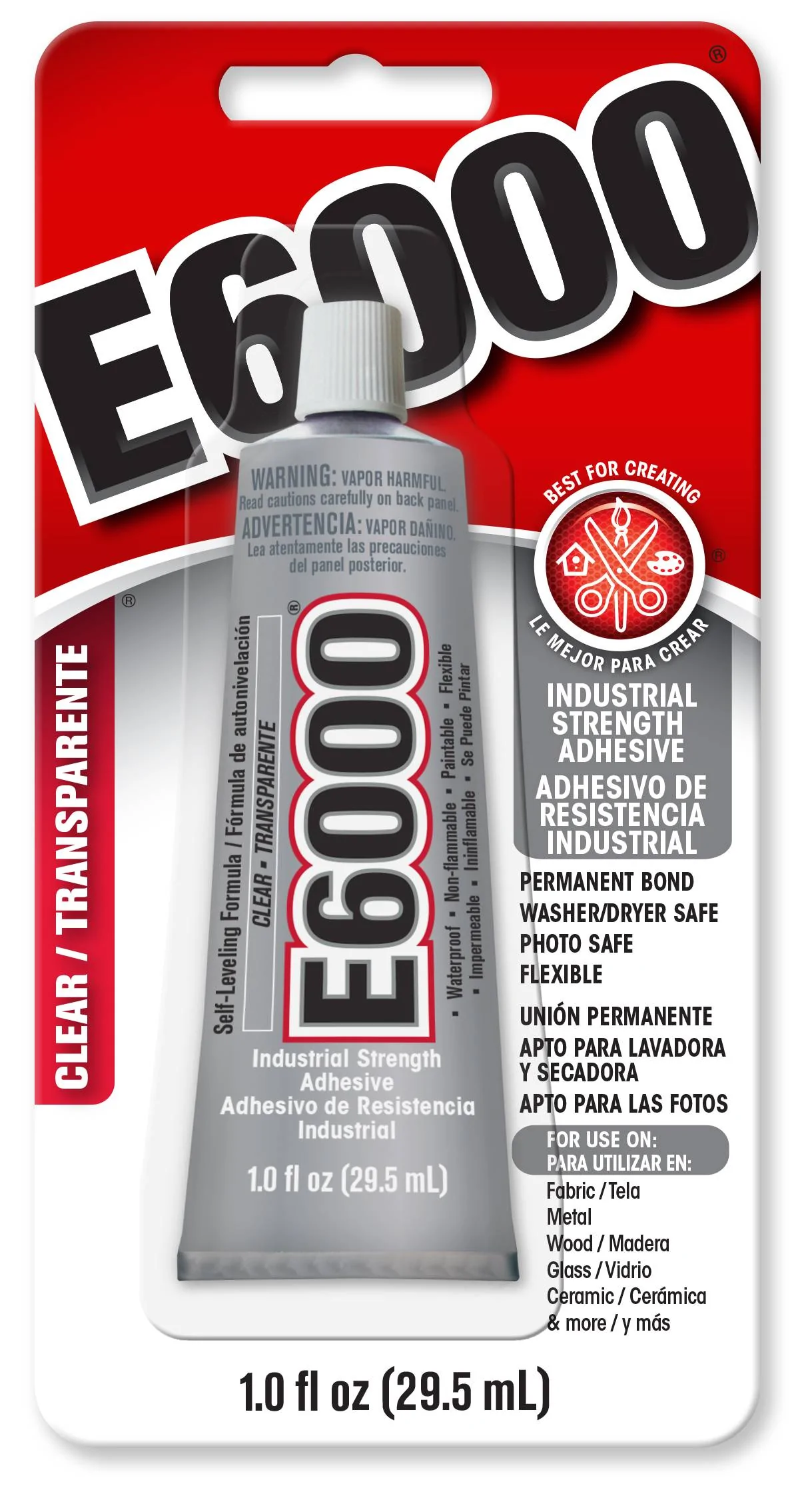

Are you using anything on the threaded connections? My snow kit came with this...
It takes a while to dry though so I found it best to install all the threaded connections with this and let it sit over night before hooking everything else up.
Yep, I have become too familiar with that stuff. But good call on the dry time, I may need to try giving it a bit more time. Its been so hot here lately that it seems to dry within 30 minutes, but it probably takes a bit longer than that for full cure.

Yeah it's been crazy hot here lately too. When I re-did my set up I noticed it was pretty dry with in the hour but I let it sit over night anyway and by morning it's rock solid unless you break the bond free. One of these days I'll probably try to go to dual nozzles again and see if that was my issue. I run so much boostane the meth really isn't needed on my set up for anything more than cooling though so I may just call it good enough.
