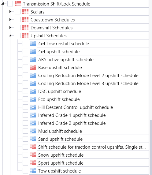

What I really want to do is retune the 10R80 transmission and its shifting. I want the shift schedule of track mode in normal mode. Currently, it seems to be heavily biased towards MPGs, I.e. it shifts up to 10th gear even at low speeds and stays there without moderate application of the throttle. In track mode, and other modes, it holds gears longer and is quick to downshift when called upon. I want to duplicate that behavior in normal mode.
is it possible to do this with PCMtec? Am I able to “copy” track mode tables to normal mode without opening too big a can of worms? I’m not as knowledgeable as you all.

Yes you can easily change the shift points. Copy and paste if you want the sport mode in base.
Problem is most if not all Ford tuners lock the tune. So you would need to learn how to tune the engine as well. If you don't have a tune then simple.

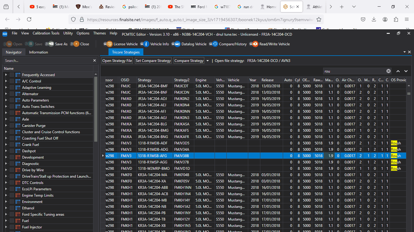

They have stock Roush tunes on the website for download.
Unless Roush started locking the tunes it will download and read them.
