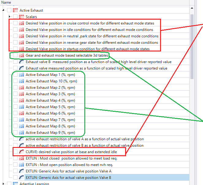

If you look at the picture below you'll see the green items which you're mentioning. These items are present in HPtuners as well, and I had already set them like you're showing above. But although in, say, Normal mode the valves were configured to be 100% open at any rpm, somehow at idle they weren't. At idle they were always about 60% or so in Normal, and perhaps 80% or so in Sport.
That's because of the items marked in red. Both the 'neutral & park' table and the 'base and extended idle' table were set, in my car, to 0.6 in Normal mode and a bit higher (perhaps 0.8? Can't remember) in Sport.
I've adjusted all of these tables as well, and lo and behold, the valves are completely open at idle now. 😁 :sunglasses:

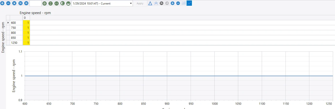

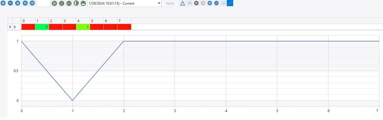

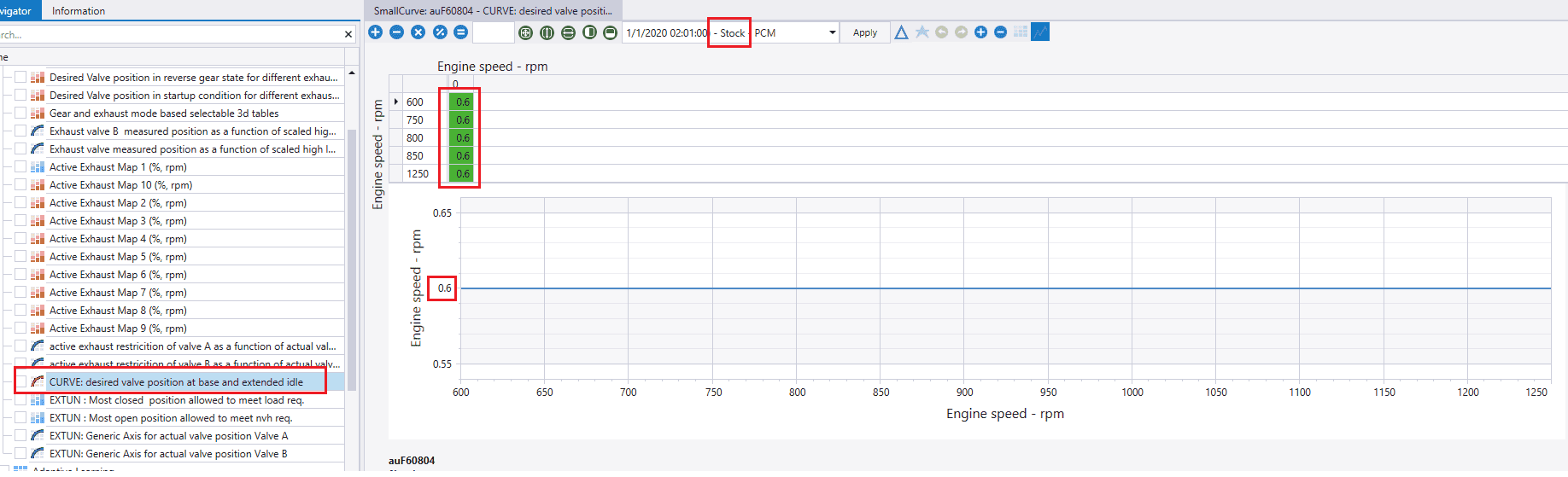

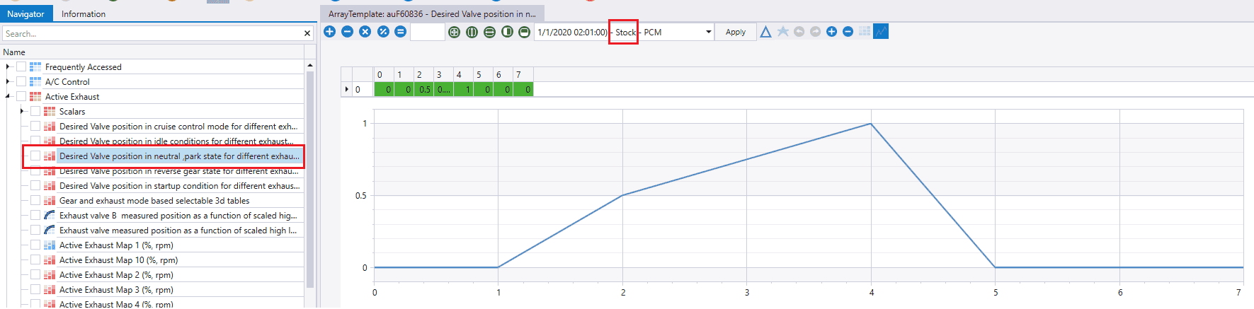

This was my problem. Changing these two tables did the trick.
Those ten mapping tables probably do their thing as well, but at idle these two appear to take precedence.
I changed it to this:
and this one:
which I changed to this:
