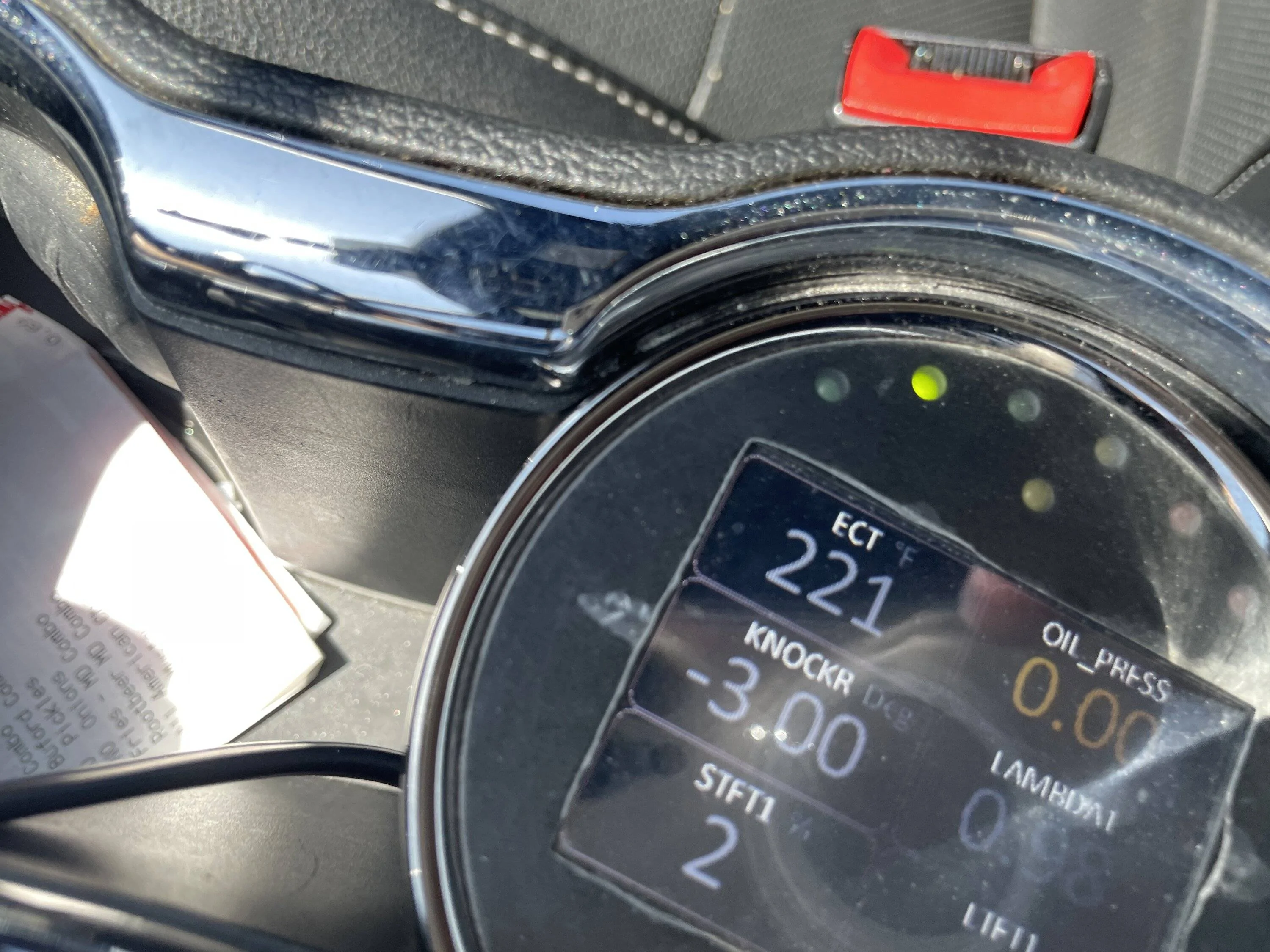

The coolant temp is inferred, The gauge is in the normal range.
@tdstuart
You did not log CHT in your posted logs. Engine coolant temp is logged and tops at 207 for a few seconds in log e85 2
I'm wondering if your CHT sensor is not working correctly. Can you log that parameter and post it.
Also on the bottom of your log is a bunch of channels that are all showing 0 delete them for a faster poll rate.

Here was my coolant temps at 241cht
