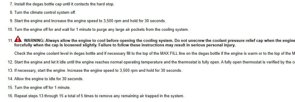

I think it's just air pockets in the system. This is from the service manual, try it and see if it gets you squared up.
