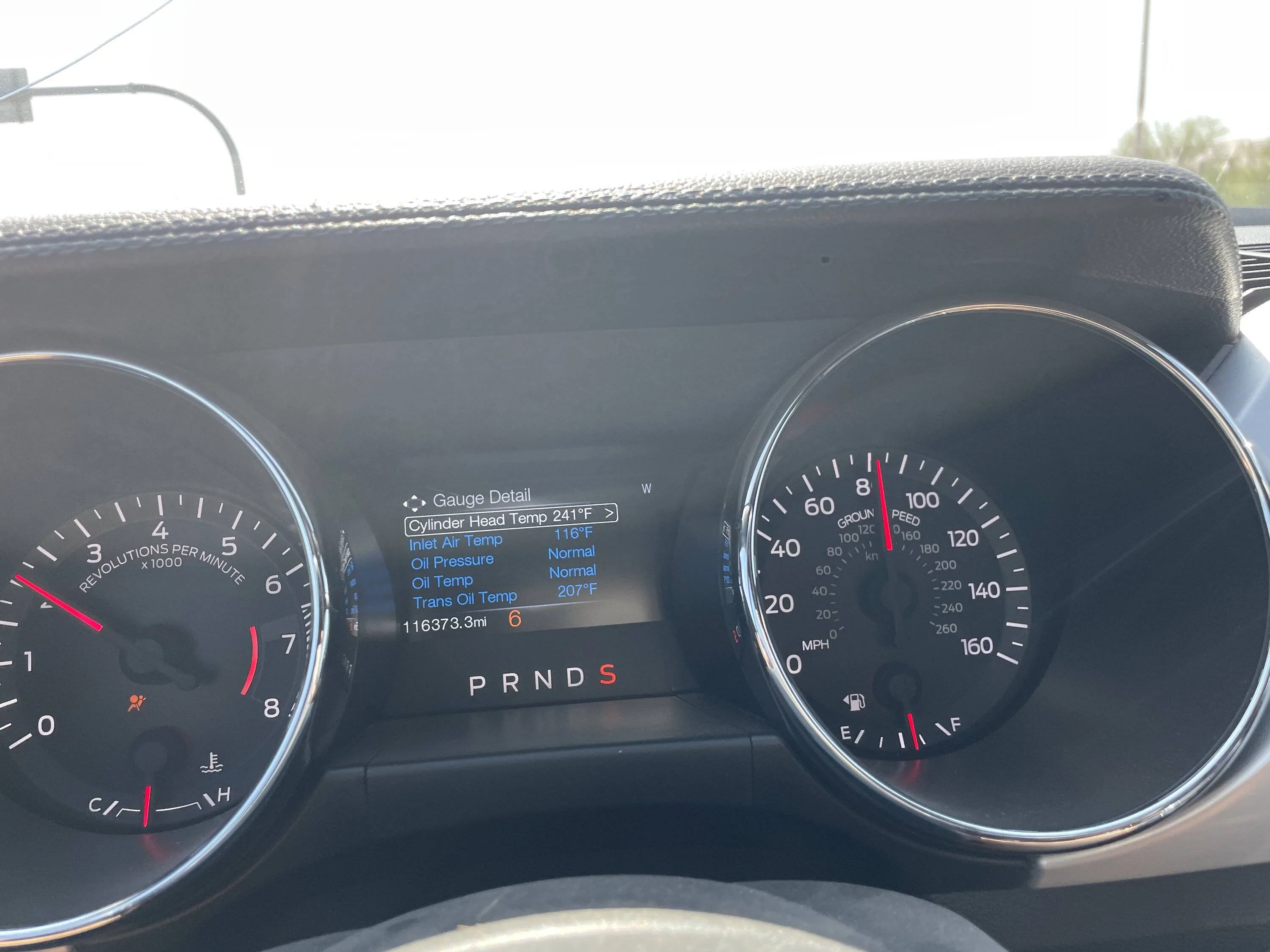

Cruising at 80mph with A/C on got up to 243CHT

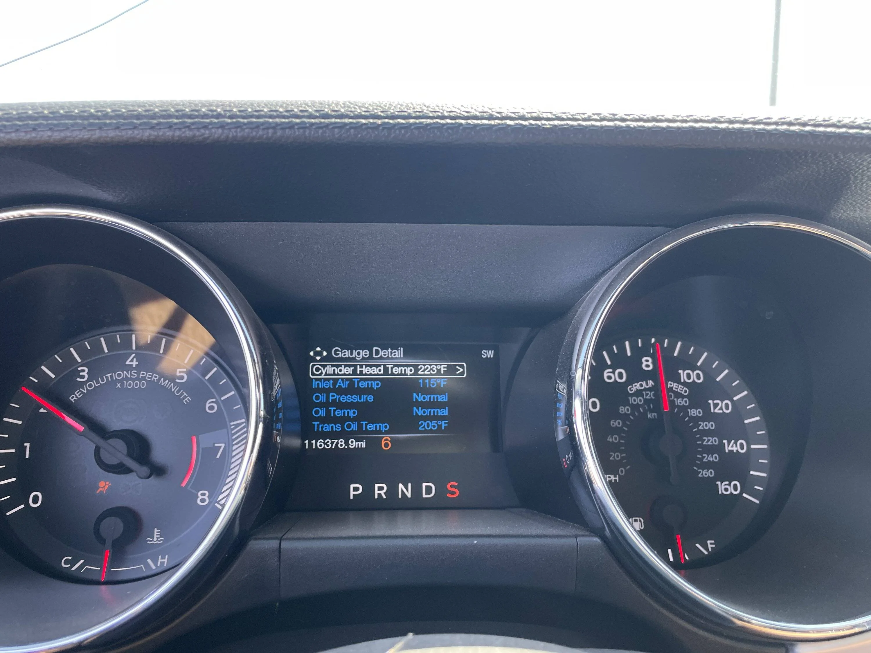

After turning the heater on full blast it dropped to mid 220s
