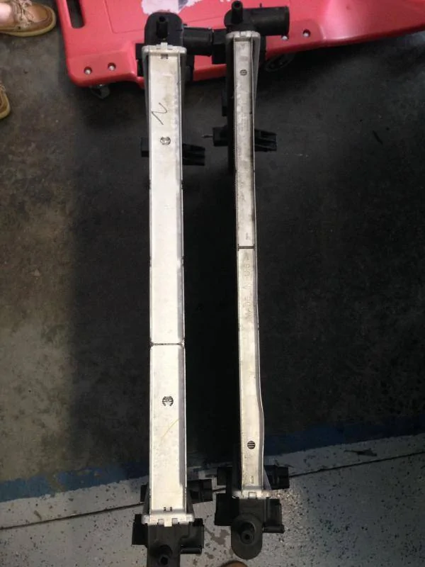

Looks about right on the radiator.
Looks like you have the upgraded radiator, I would install it and if the problem goes away, all is good. If it keeps overheating you have other issues.
Your bottom hose is hotter than the top? Air flow issue or clogged radiator.

No that’s not my photo. I have a stock radiator.
But ya maybe a clogged radiator.
