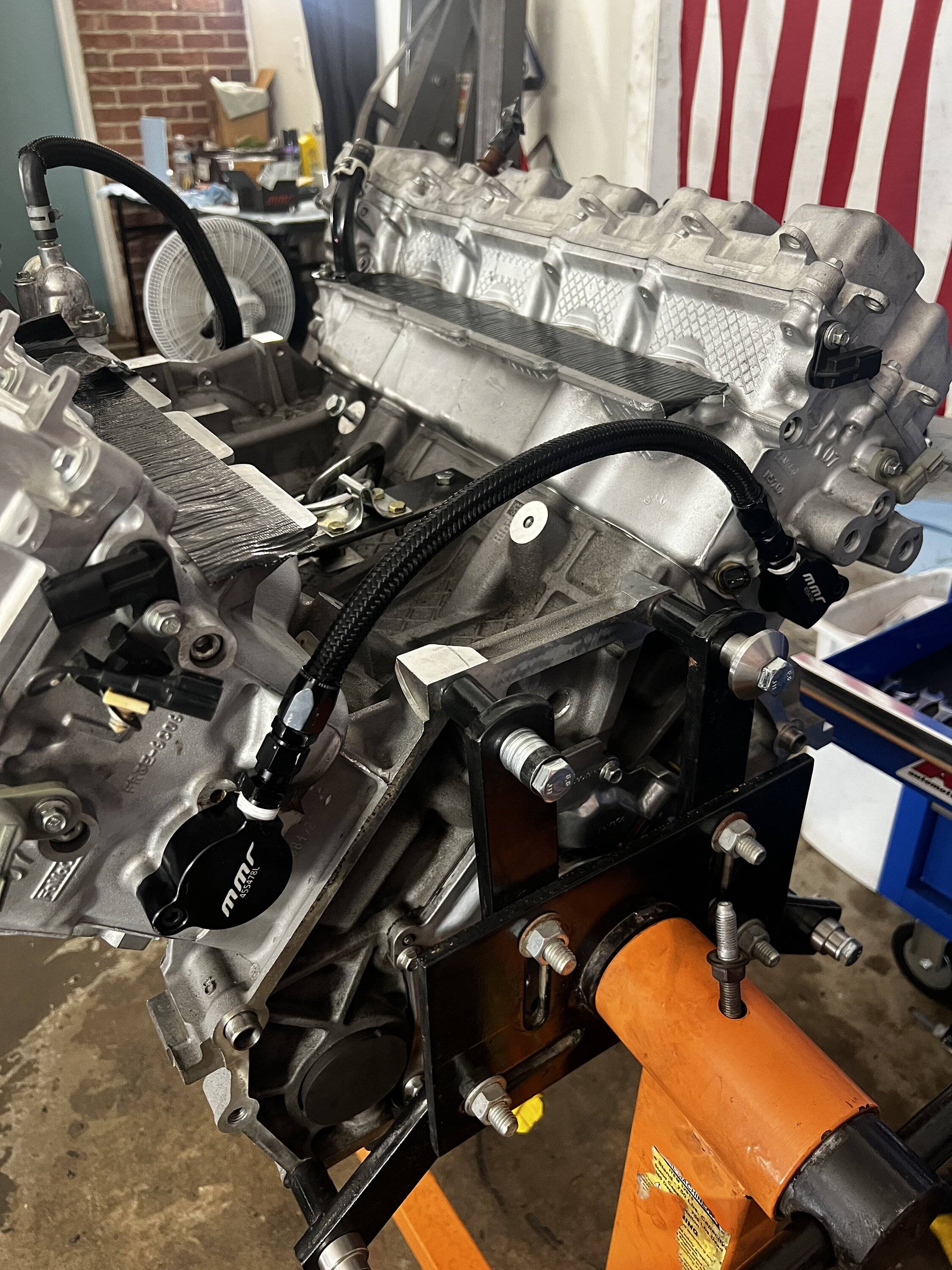

@GregO
Here is what the mmr cooling mod looks like. Not my photo but this is the braided hose with an fittings for gen2 so exactly what I have.
