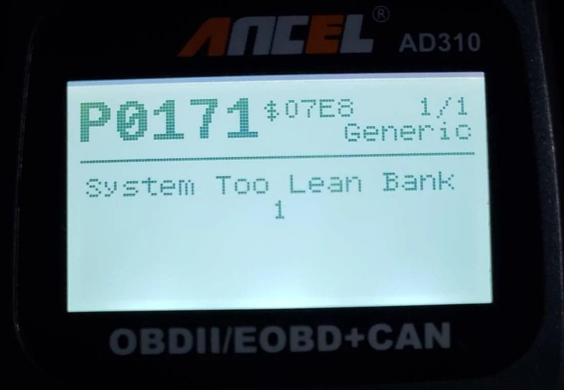

Car threw a CEL at me. No performance failures, no change in drivability or feel. The whole time I was dogging the car I was watching the gauges. Temps and pressures were always "normal" and in the normal range. Yet I got a CEL so I got worried.
I was in Orlando at the time. I cleared the CEL and kept driving. I eventually forgot about it and kept on dogging the car. Ran out of gas and couldn't find e85, so filled up with 93. As soon as I turned on the car, the same CEL came on. I left it on this time until getting home so I could check it (that picture above is actually from when I got to my parents' place since my programmer was reading nonsense codes).

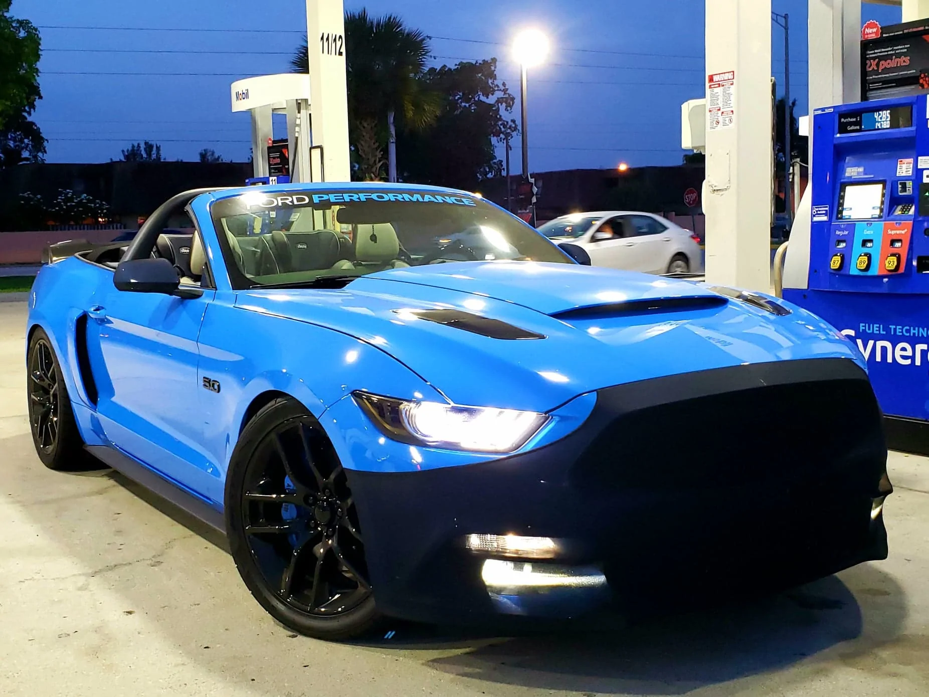

On the way home had some guys try to race me so I obliged, doing more pulls to 125mph or so. Car never behaved weird or poorly. The only indication I had of anything being wrong was that CEL on the dash.
Right before my parents' house, there is a gas station with good lighting so I got off there to remove the novistretch bra rather than have to do it in the dark later.
That's when I thought I should open the hood and see if I could notice anything. And this happened.

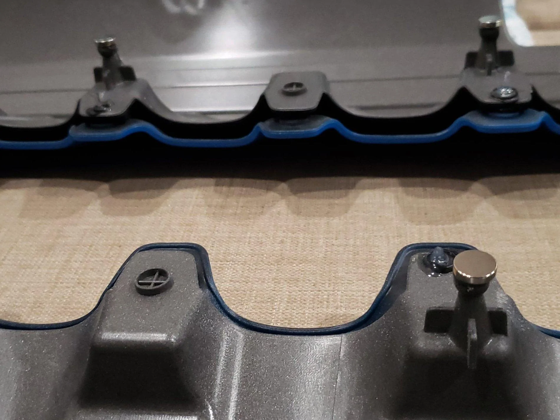

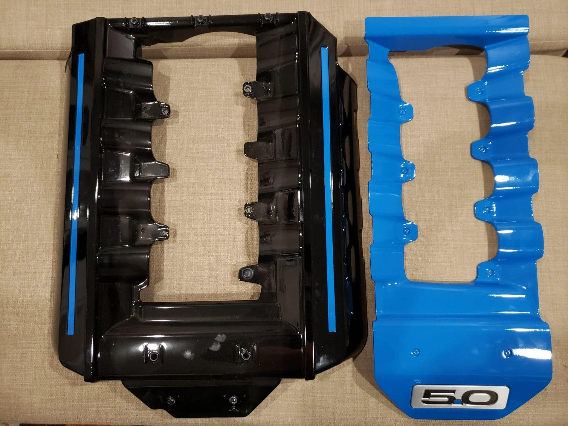

The engine cover is a OEM 2017 cover that JLT sold me custom painted to my specs. I assume they take it apart for painting then put back together with glue. However, this has been on the car since January and it's never separated like this. So it can't be just "their glue melted" because it hasn't melted before. Also, I mention in the video that "my new thing" broke. Since this is a 2018 intake manifold, the 2017 cover doesn't fit without modifications. I cut up part of the cover and put magnets on the intake manifold and the cover to keep it place.
Those magnets are on there with JB Weld rated for constant 550F heat. The JB Weld melted (don't worry magnets stayed in place so I don't have loose magnets!) - so it makes you wonder if the engine bay was running at 550F or more for a prolonged period of time.
This is how my engine cover is now. Going to try to put it back but I wonder if I'm just going to give up on using it...

Last time i had that cel was when someone didnt put the throttle body gasket back on the manifold when they put it back together. And like you the car felt like it ran great, i would only notice weird surging under idle sometimes. So if i had to guess a gasket is missing or damaged on the manifold.
As for if the heat melted the glue, i can assure you if at anytime it was over 300 degrees under that hood you would have known real quick.
I would log it and send it to your tuner, and they will tell you if its lean with 100% certainty, which I am sure it is.

I think if your underhood temps were 550+ you would have some more obvious issues.
Without you having any type of cooling failure and assuming no coolant lost, I doubt you have any serious issue with that.
A good indicator would be to check your cylinder head temps. They should hover 205-212 or so maybe a little higher if you’re really hammering it.
I think the more likely scenario is the glue has been slowly deteriorating and you generated a LOT of heat doing 130+ pulls. It’s also July in south Florida and you had a lot of air moving under the hood at those speeds. Chances are that did things in for you, not the CEL’s and engine overheating.

Datalogging will be the first thing to determine if the car is going lean continuously or intermittently. Flex tunes (assuming its a flex tune since you are changing fuel types) often need additional attention from the tuner to make sure they are correct. Last the O2 sensor on bank 1 may be going south (bad). E85 is not very friendly to cars not originally set up to run E85. You may wish to research and speak with E-85 users to find the best resolve IF the O2 sensor has failed due to E85 presence. Additionally E85 is hard on plugs as well. So you may wish to change them out annually according to people in my group that run E85 exclusively. This is why I prefer 93. Bank one btw is the passenger side.
As for the cover issue, I would call into question the way the JB weld was mixed. You can't gauge the engine temp by an adhesive failing. And as mentioned lose the bra and install a clear one. It only reduced airflow.

Monitor LTFT's. Properly tuned and at operating temp they should be zero at idle, through the RPM band and at WOT. vacuum should be 15" Hg or lower (larger number) at idle and 0 at WOT during your pull or very close to it. Datalogs will show more if there is an issue.
