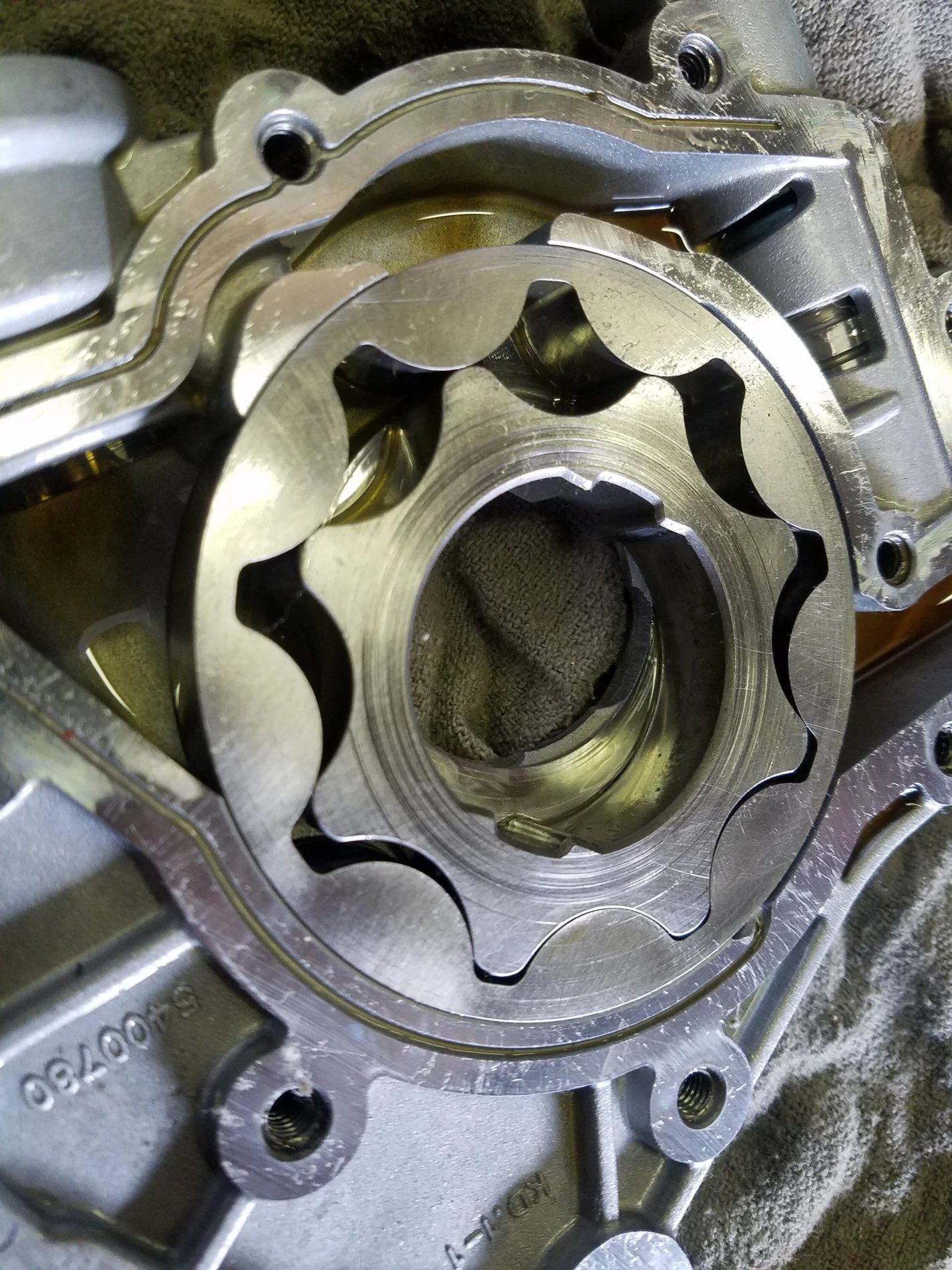

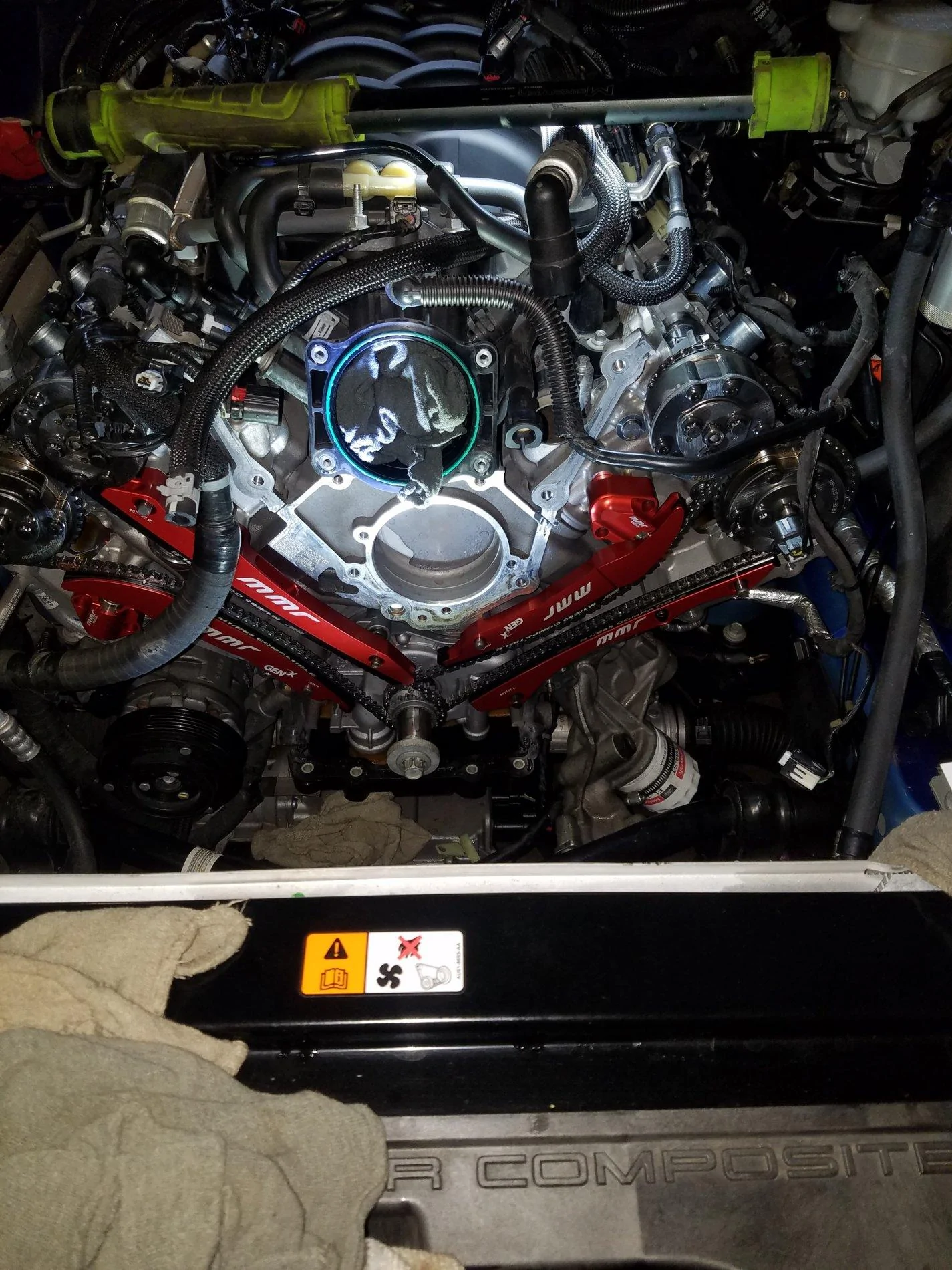

Installed my MMR billet gear set today. I have 7500 miles on a 2016 GT 350 so I decided to change all gaskets. I have a lift in my garage so I dropped the k member down about 5 inches and lifted the motor up off the mounts about 2 inches process was pretty straight forward. I know some of you guys have done this without removing the oil pan but I have to believe that would have been a bear of a job. Waiting for my Gen 5 Whipple complete kit and will install as soon as it comes. Will use standard Whipple tune at this time looking to run 10-11 lbs boost and shooting for about 750 WRHP. Will take to a Dyno when complete to verify the build.

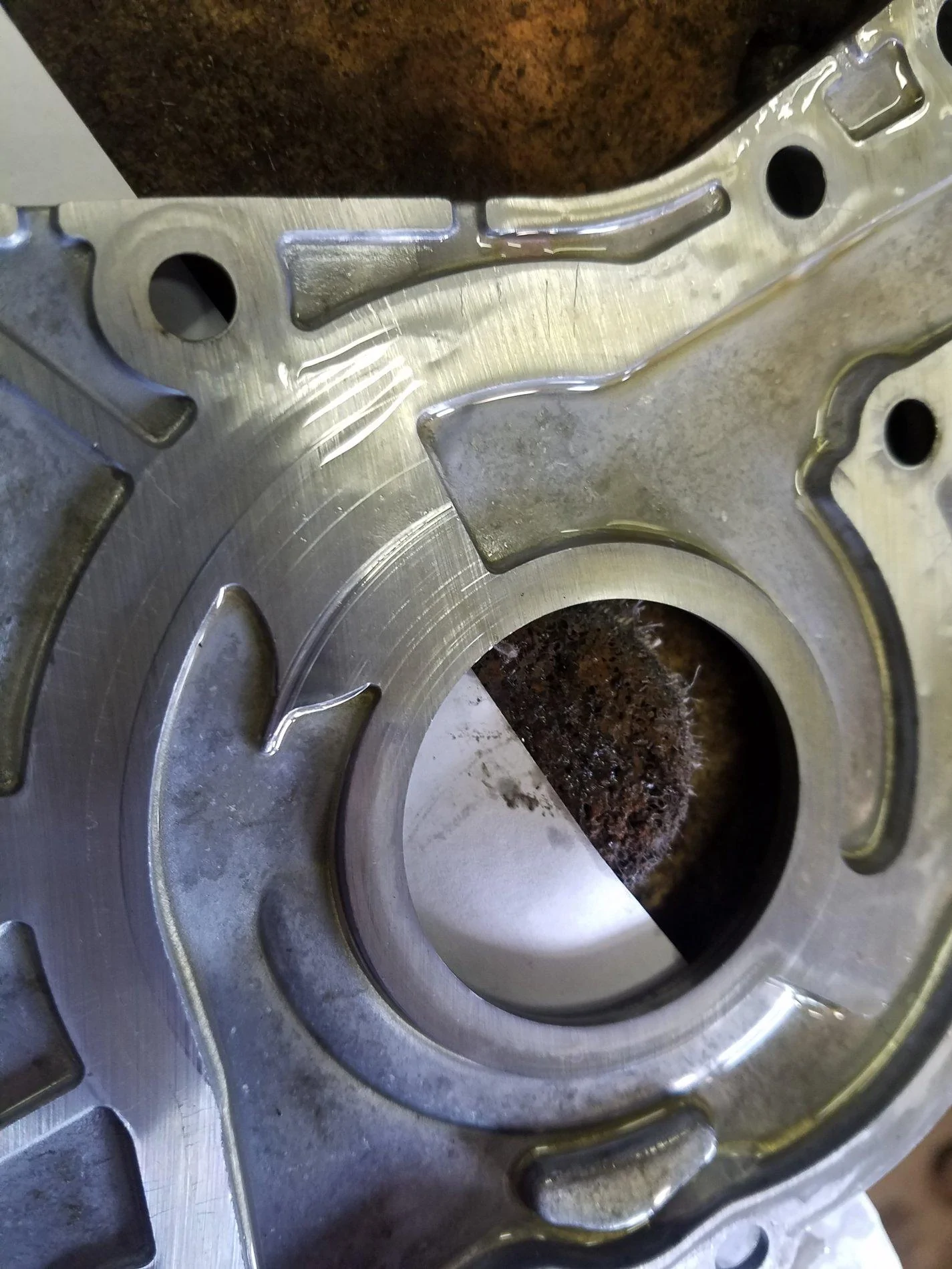

I installed the Boundry Gears in my car a few weeks ago. Was not that bad of a job, although I have access to a lift and I own a ton of tools. The hardest part was dropping the pan There are 2 bolts on the passenger side where the steering rack is located that may have you cursing But all in all was relatively smooth. Best advice I can give you is go slow read the manual and Prime the engine a ton! You will hear some ticking. upon startup and its very nerve racking But Im glad I took on the job and Im happy I didnt have another shop tackle it. I would have been wondering my whole life "How bad would it have been if I just did it?" lol
