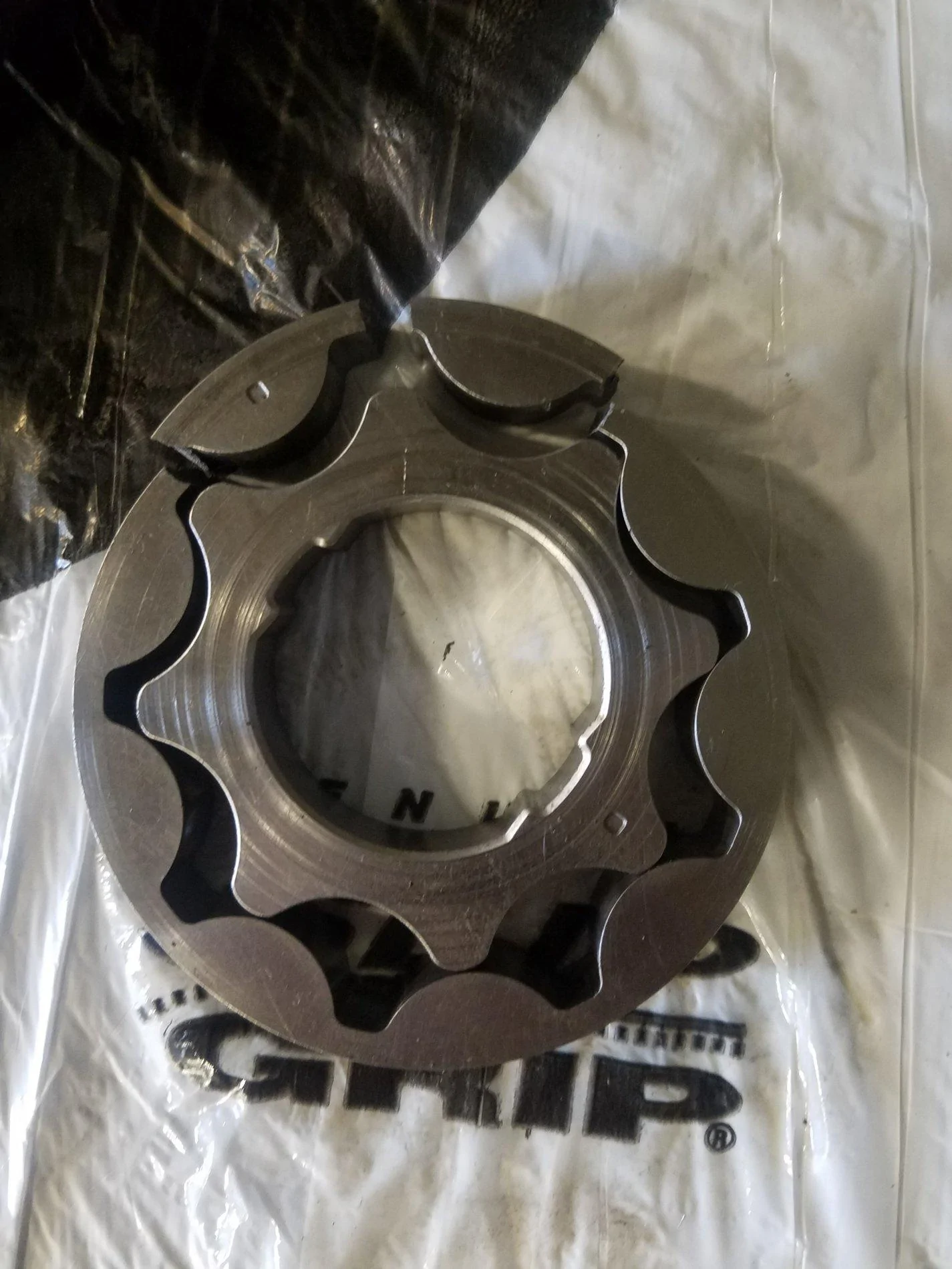

My oil pump gears and pump casing were in great shape no signs of wear, I replaced them as an insurance policy before I run my Whipple Gen 5. I did do the drop test on my garage floor from about 4 feet and the outer gear broke in 2 pieces. When I looked at the crack you could see the base metal was very porous. Unfortunately I did not take any pictures.

My Oil Pump gear Post drop 4ft also
Thanks @Paperdude2016 ! You can see the porousness in @FLATPLANE ’s pic too.

Curious why the drop of gears from 4" means something....
Lots of stuff breaks when dropped
It means its brittle. When you bounce of a limiter you get that quick direction change that can send harmonic shock through the gear and shatter it.
billet is more flexible.

You should have dropped the new billet gears on a concrete floor as well to see the difference.
So when Ford added the rev limiter they forgot about the oil pump gears?
