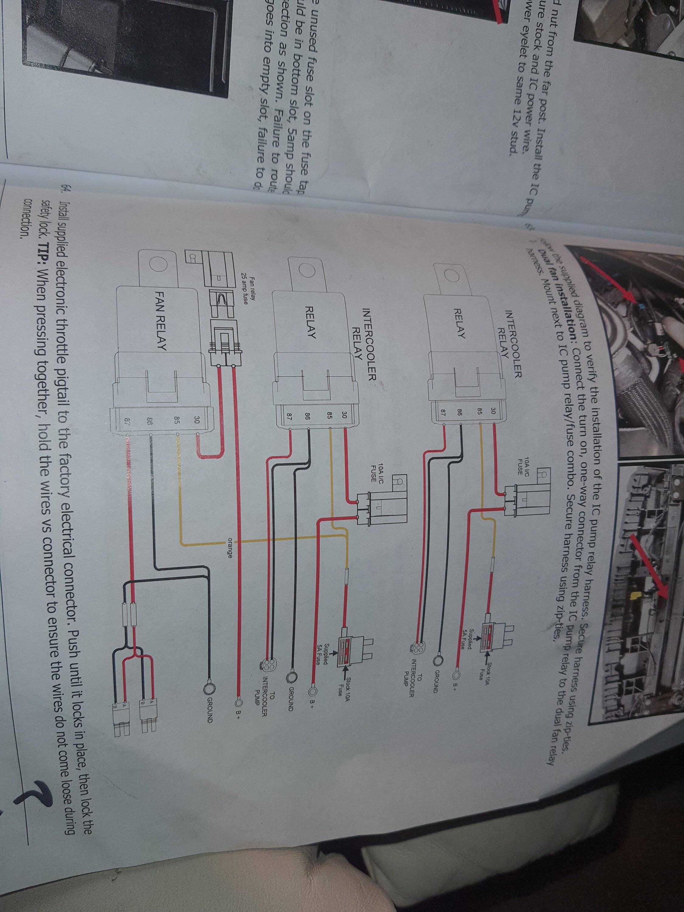

Anyone who has installed the Whipple 3.0...
Step 64 install supplied electronic throttle pigtail to the factory connector...
It's the only step without a picture or a part number.
Help!

I believe they mean the throttle body harness extension. The stock harness that used to plug into the TB will not reach the new TB location so they include a 18" extension.
That's what I was thinking as well. The directions are fairly good. You can tell that some of the descriptions they spent a little more time preparing referencing specific part numbers. This one not so much. I also found the same instructions further in the install manual #139. Been a couple times they repeat the same instructions.
Thanks for the response. Hope to have the install done today!

If it is for the extension harness try plugging it into the TB connector on the front passenger side.
