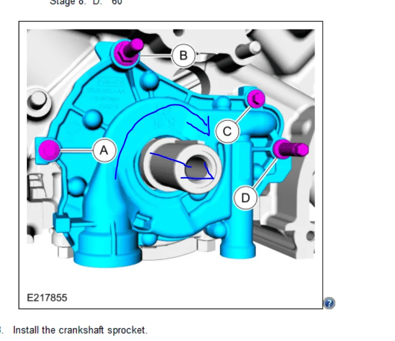

Do all the pan bolts need to come out or just the front ones in the timing cover? Looking at the picture it kind of looks like the pump can be rotated clockwise to get it off the pickup then pulled off the crank? Can anyone confirm? B and D may be studs so this may not be possible.
Just the front ones. 4 in total from memory.

You sure? How'd you get around the pickup? Did you rotate it?
For a 15-17, yes, for sure.
I don’t recall how I got the pump off but there was no trick to it. The two bolts holding the pickup to the pump are the PITA.
I used some tie wire, wrapped around the bolt to help steer it back in on install.
You’ll see what I mean when you get to it.
Wrong car buddy, the GT350 have integrated pickups. No 2 bolts. So do 18-19 GTs
Shit. I couldn’t see the specifics on my phone :crazy:
