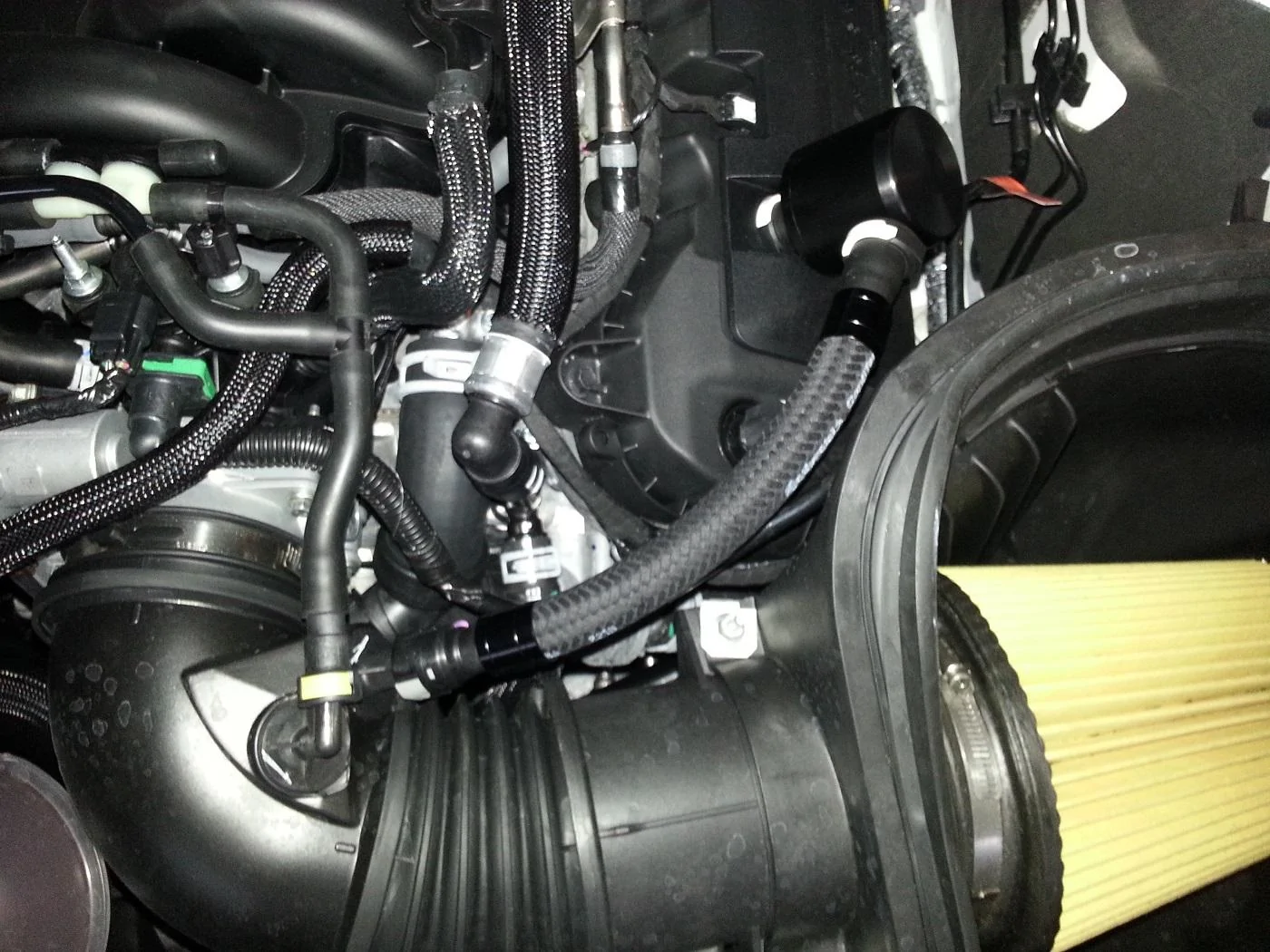

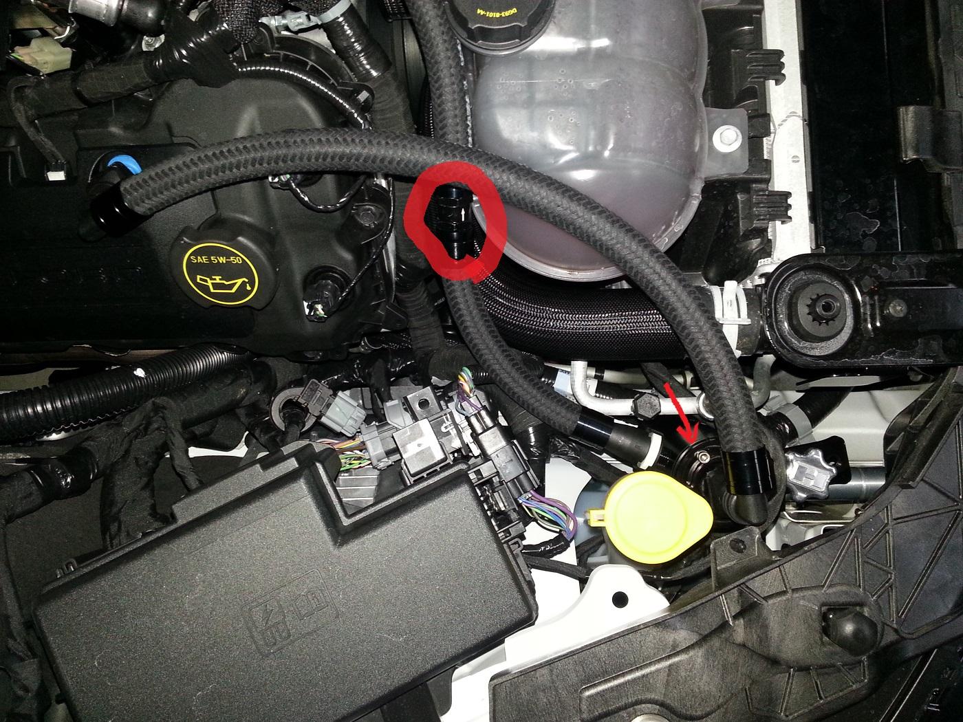

did mine yesterday, combuster your pics were a great help, UPR should use these.
I had to remove and adjust all 4 of my allen screws to rotate the can enough to be proper orientation.
used tiny bit of blue locktite as I don't want anything coming loose.

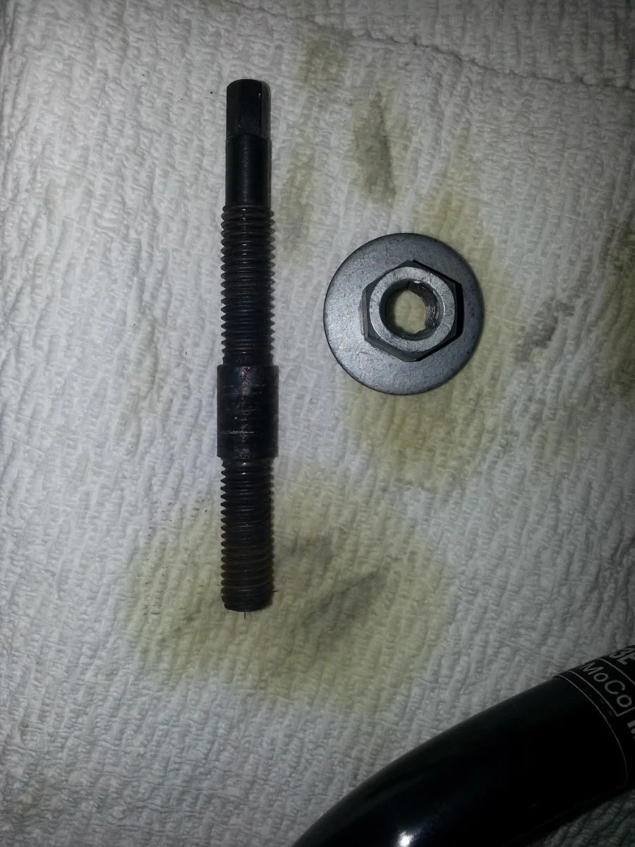

At least let us know that that 13mm nut is attached to a removable screw.:frusty:
I gave up on the install but now it kinda makes sense. Pictures do help.

"Mine had an odd size reverse hex stud with a 13mm nut on it, not sure if it holds anything. 6mm was close enough to the stud size to remove."
as soon as I saw, couple turns, that the stud was not moving with the nut I read this and grabbed the ol 6mm.

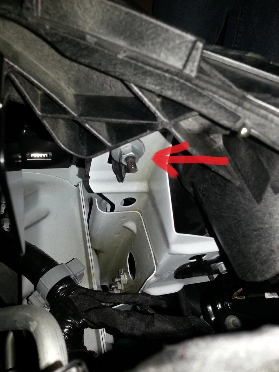

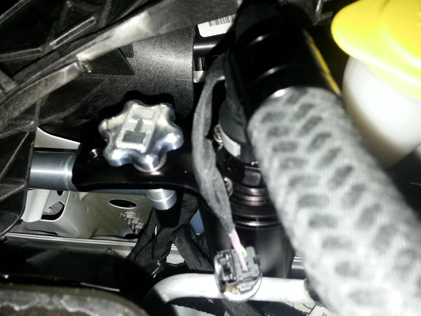

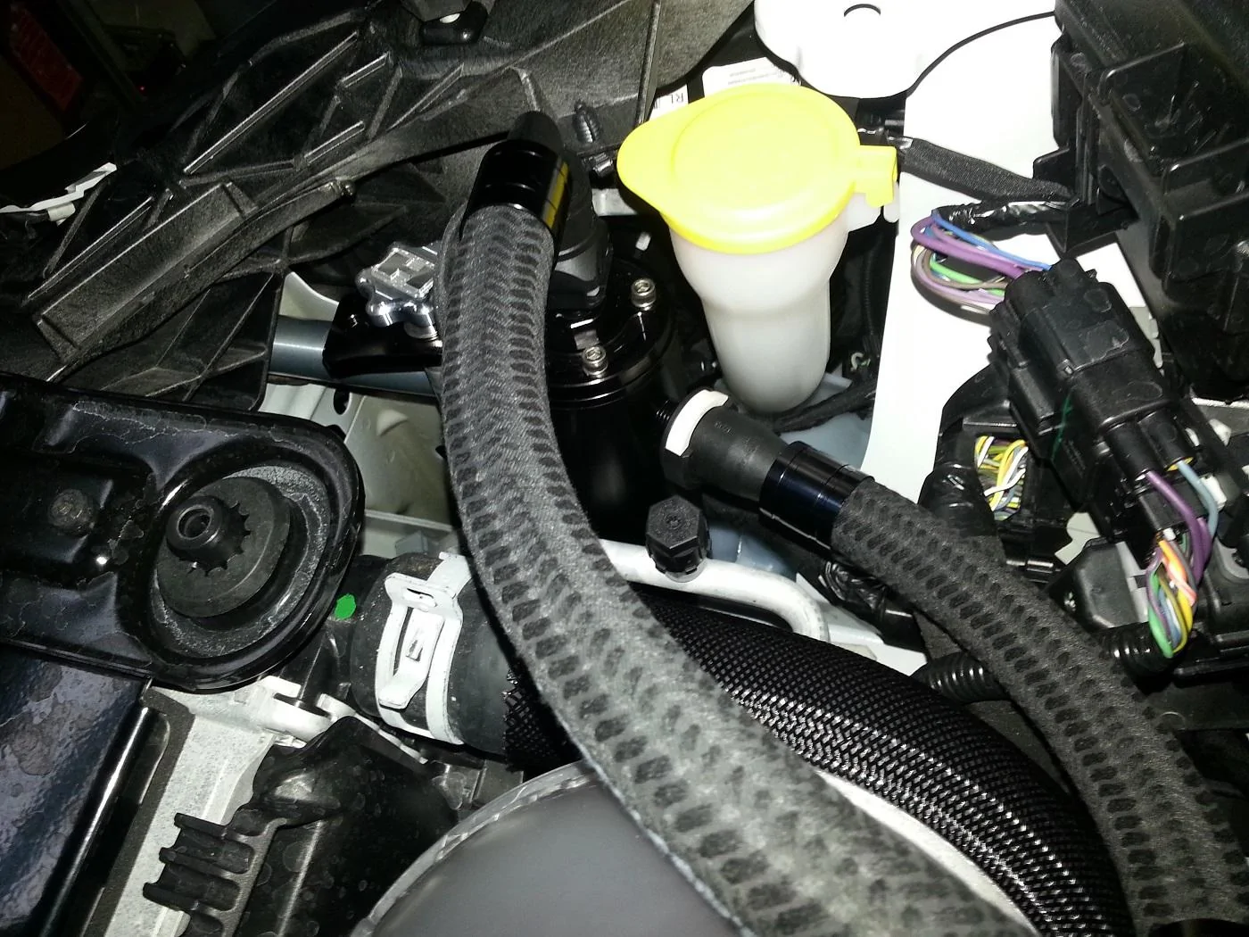

OK! I got it figured out if anyone's wondering. Remove nut/stud, and insert bolt that holds the bracket/can into the hole. Design allows fine adjustment of angle of outlet tube with 4 allen bolts. It was needed because there are a lot of wire looms in the way. Looks like a great design! I'm assuming this is the way it goes.

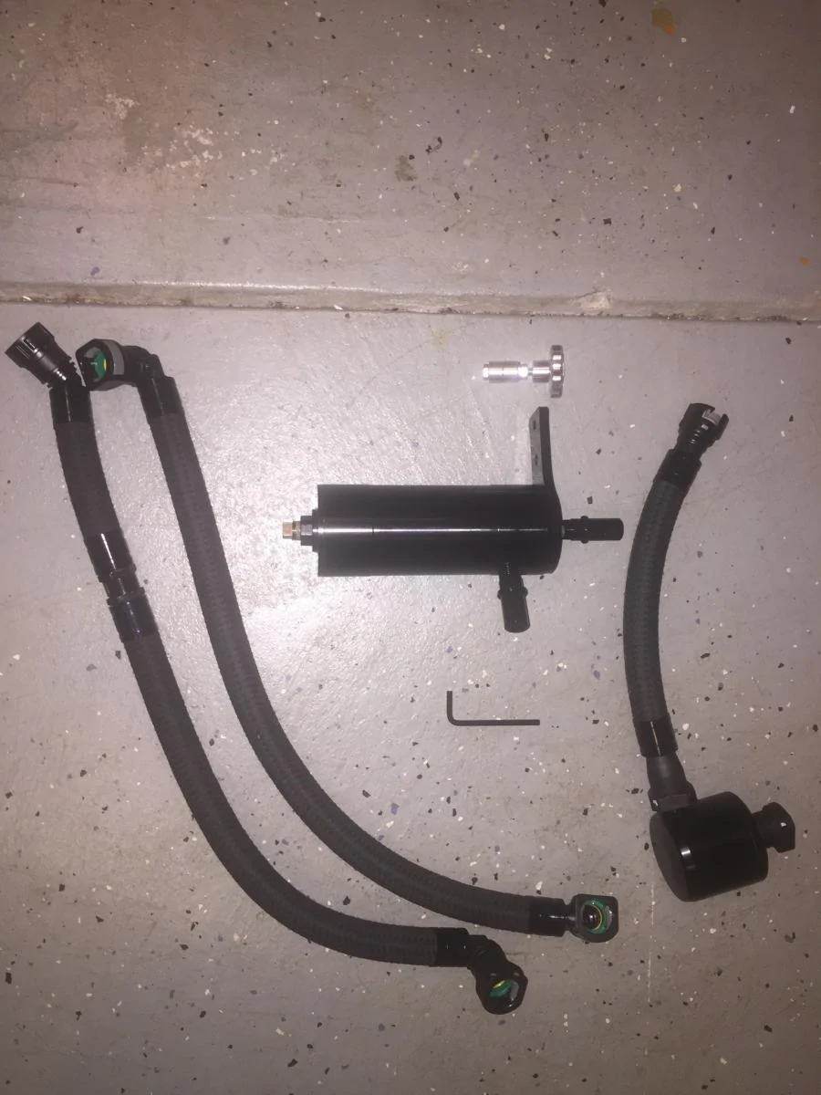

Help pls !
I bought a second had upr oil catch can for my GT350 but I don't know how to attach/ install the can. I doubt whether I received all parts necessary to do the install if I look at the pictures in this tread. When I asked the seller if he forgot to send me parts he said, no, there are no more parts, he did the install with these parts. I have attached a picture of the pieces I received.
Thanks for any advise you can give me.
