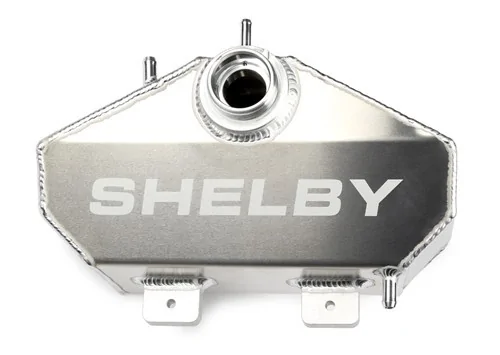

I recently replaced the GT350 Reservoir and the Shelby one has an extra hook up on the backside left looking at it. I assume this is for a supercharger. Is it ok just leaving the blue flange or will pressure pop it off? Any ideas on what to use to close it up tight? Thanks!

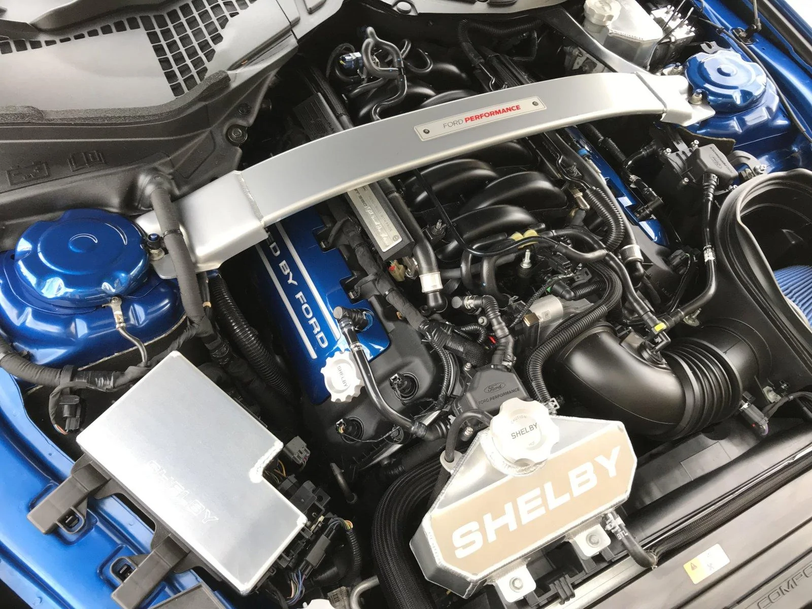

I just installed the Shelby coolant tank and the FP oil separator. They fit fine together - no grinding. Perhaps they have changed the tank design?

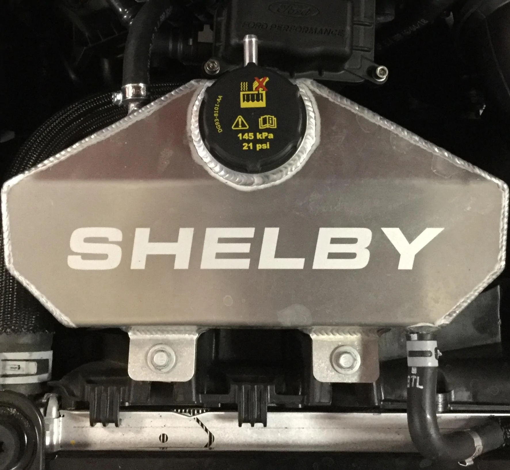

Best replacement tank on the market in my opinion. The welds are exceptional. They're made by C&R Racing. You save about $75 getting it straight from them, but it doesn't say Shelby. My Shelby tank was shipped directly from them.
https://www.crracing.com/product/mustang-gt-15-engine-coolant-reservoir-bare-aluminum
I had one on my GT, along with the FP oil separator, and I had to cut off the loop on the back. I also cut off the connector on top, and had to shorten the front hose slightly to get it to lay flat in the trough on top of the radiator. They sell a really nice back hose for it if you ask. They developed it to use on their in-house builds. Be warned though, it isn't inexpensive.
I think they moved the loop and overflow connector toward the passenger side, so they would be out of the way. They were straight off the back on the one I had.

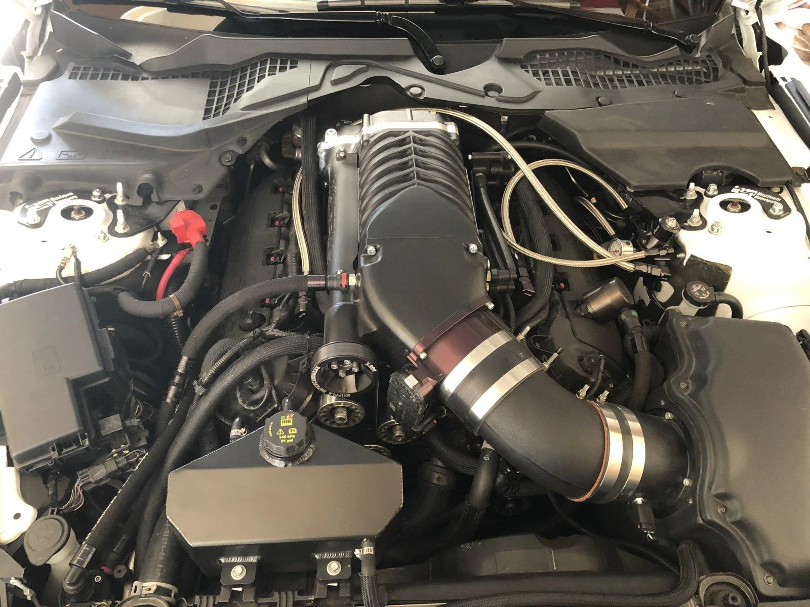

Love mine as well. Powder coated satin black for my preferred look. Best aftermarket with a Whipple as it doesn’t place hose close to the pulley.

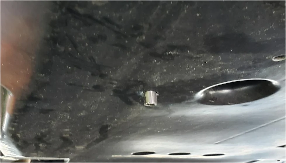

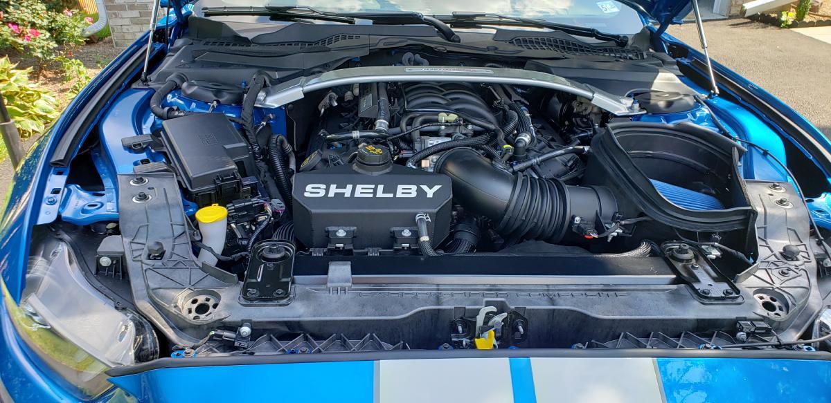

Installed this one. In the unlikely event there was overflow, I ran the tube down through hole I drilled in belly pan. After tie wrapping it all up, superglued the hose to the belly pan and then cut it off.
Only thing I do not like is that the cap does not line up at full lock.

Where did you get that one? Did you mask off the Shelby logo? Looks great.
