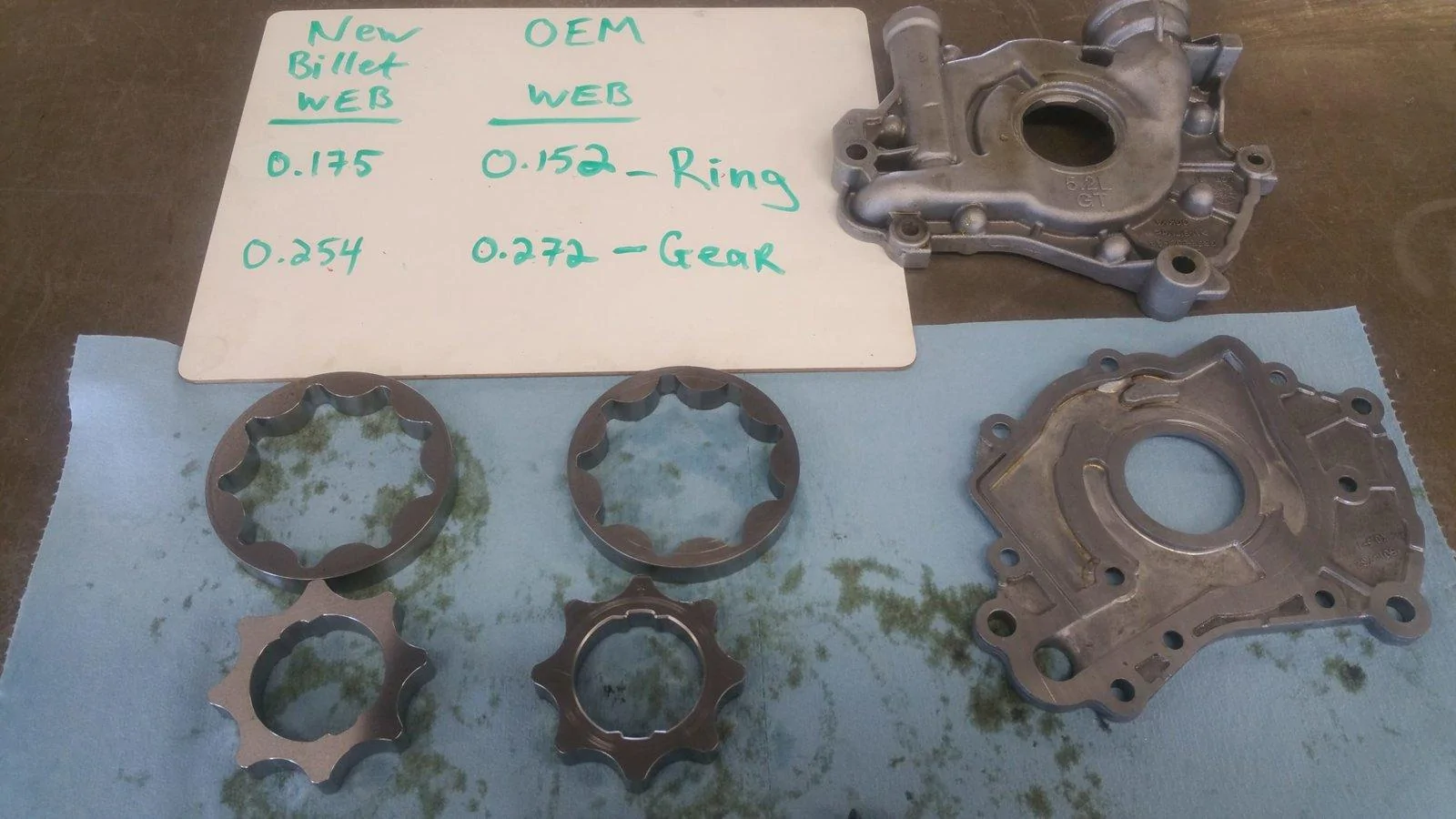

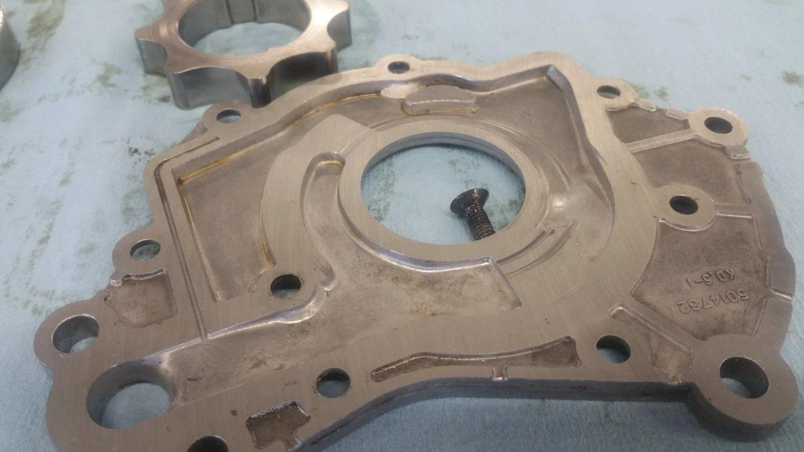

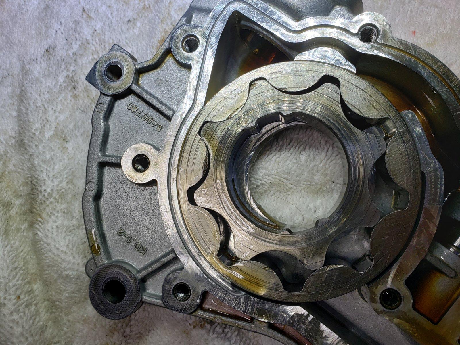

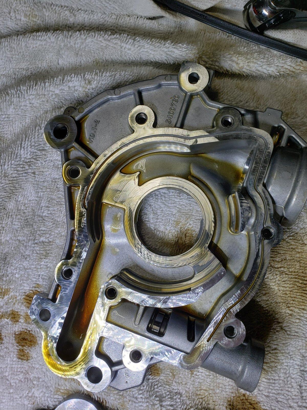

Highly recommend an OPG upgrade. Dug into mine today:
hmm are those chips I see?
Chips on the edges of both surfaces
Scarring on inside of pump housing
Big chip on the pump housing cover as well

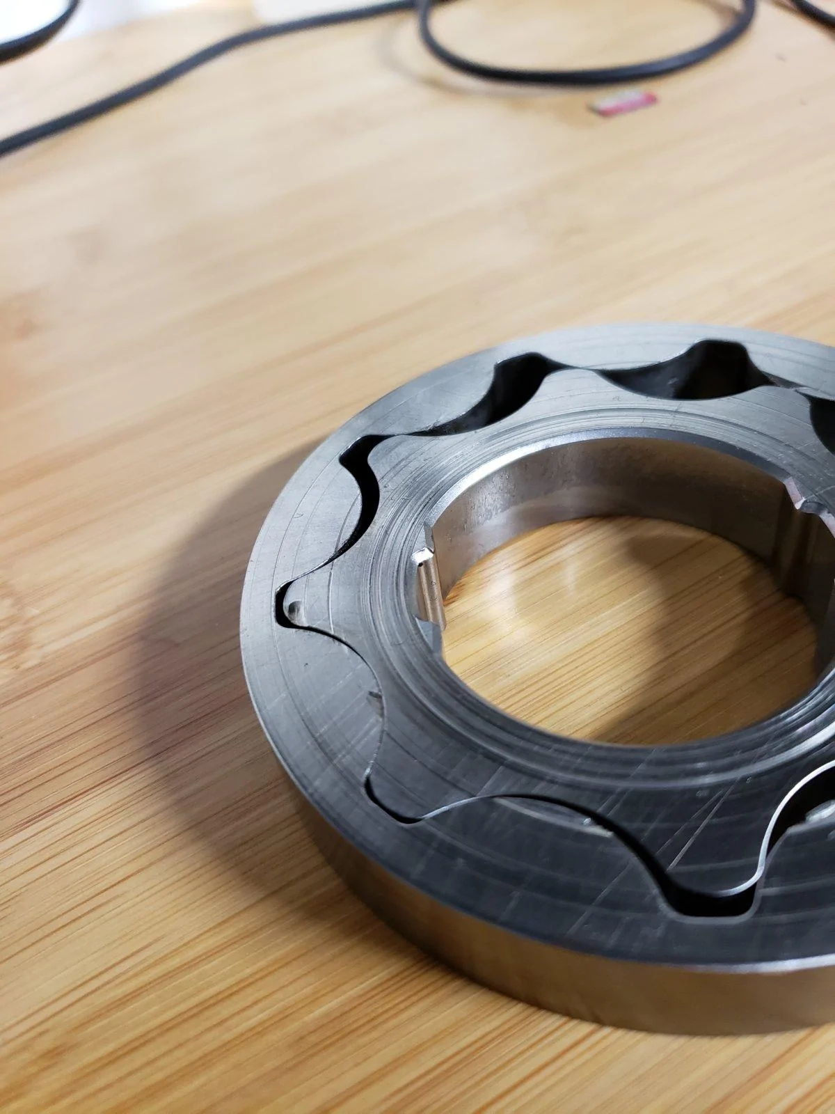

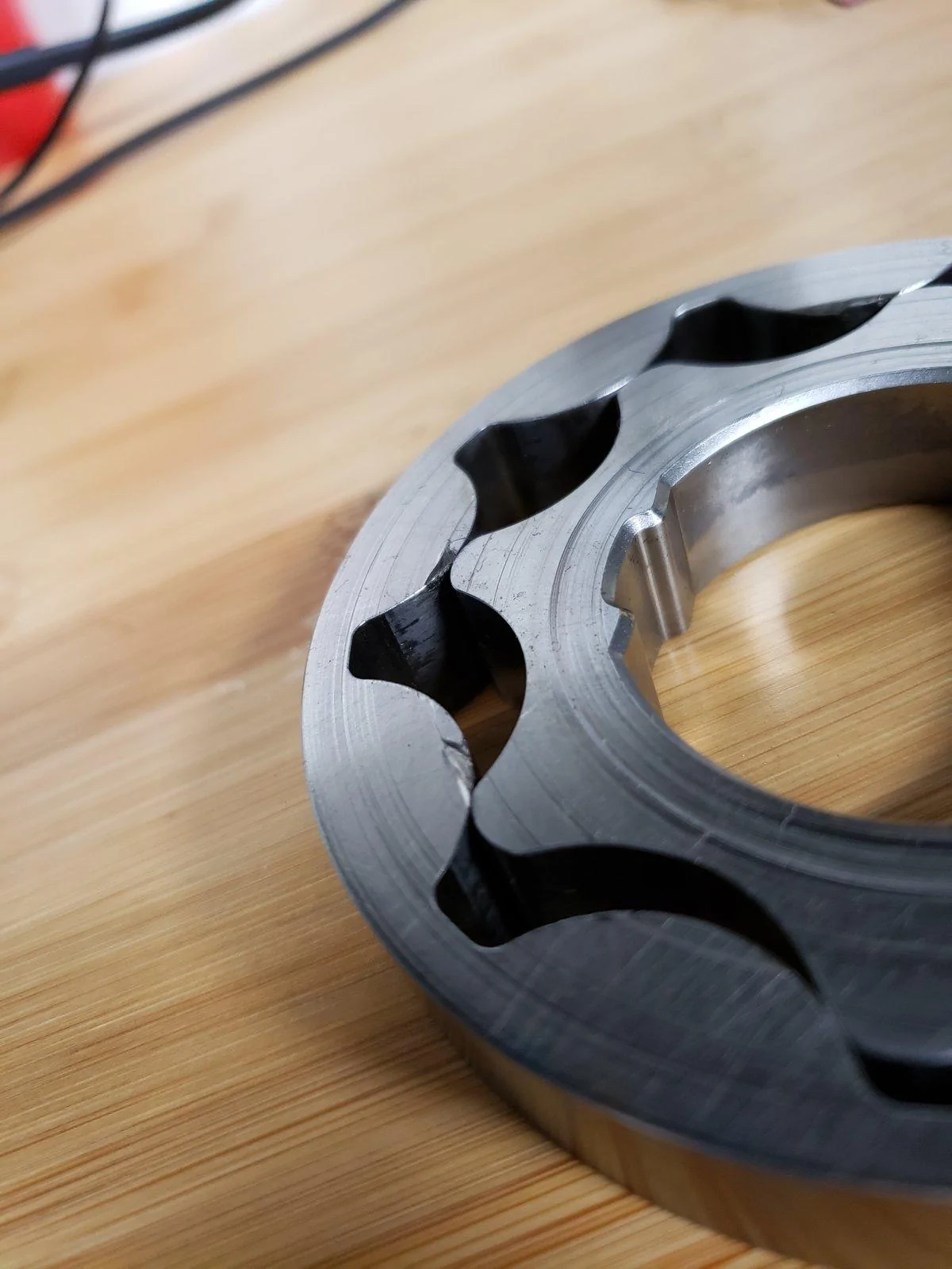

I know we basically knew this but, it’s still disappointing. The OPG is def not up to par. I’m prob not driving mine again until it’s out. Should be within the next 2-3 weeks.
These pics are disturbing to me. My oil pressure is easily 125 - 130 cold which puts serious pressure on these gears. All that to say, good oil pressure doesn’t matter when chunks of metal are rolling around inside.
In the same boat. I knew they were a weak link, but this still caught me off guard. Happy to have caught it early!

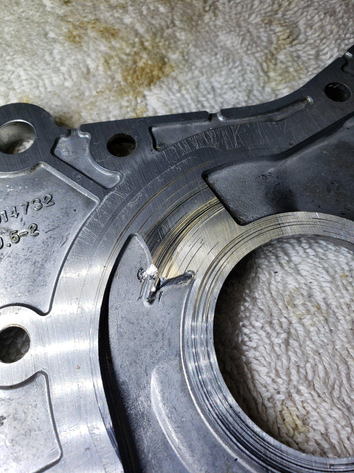

That is truly scary. Makes me wonder what mine looks like!

Following. Less info from the GT350 crowd on OPGs. First time I've heard of this on an N/A motor.
Here's a couple of the few pics I was able to scrounge up from the FB groups for comparison. Owner had 14k miles. 9k with a whipple. Some minor scoring and looks like one chip:
