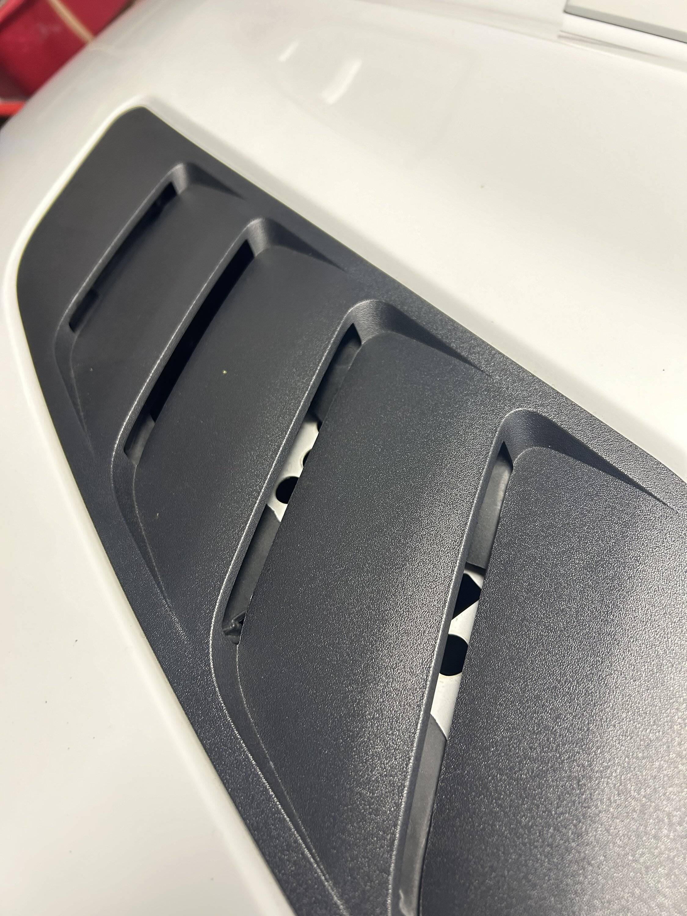

Honestly, you’d need to open up the holes in the hood as well. If not, you’re still venting the same amount of air out of the hood no matter the size of the vents.
sms2022
sms2022
Jan 22, 2024
44
897
983
Detroit
SS
2022 Mustang GT PP1 premium
Yes that’s what I’m saying. Open holes in hood and make vent grill removable.
Got it, thought you were just talking about opening the vents only.
I think it would help a little. Not to the extent something like a GT500 vent or the race louvers or trackspec vents would where the cutouts are much larger. But, more hot air out is more hot air out
sms2022
sms2022
Jan 22, 2024
44
897
983
Detroit
SS
I
i'll be opening them up eventually just to help out a little. i doubt it does much but oh well.
If you look at videos where people put the smoke wand in front of these cars, the existing holes definitely pull air so they are in a good location. I also have no real clue if it would help but based on this it seems promising. I’m going to try to fit the drip tray so it is removable as well for street driving.

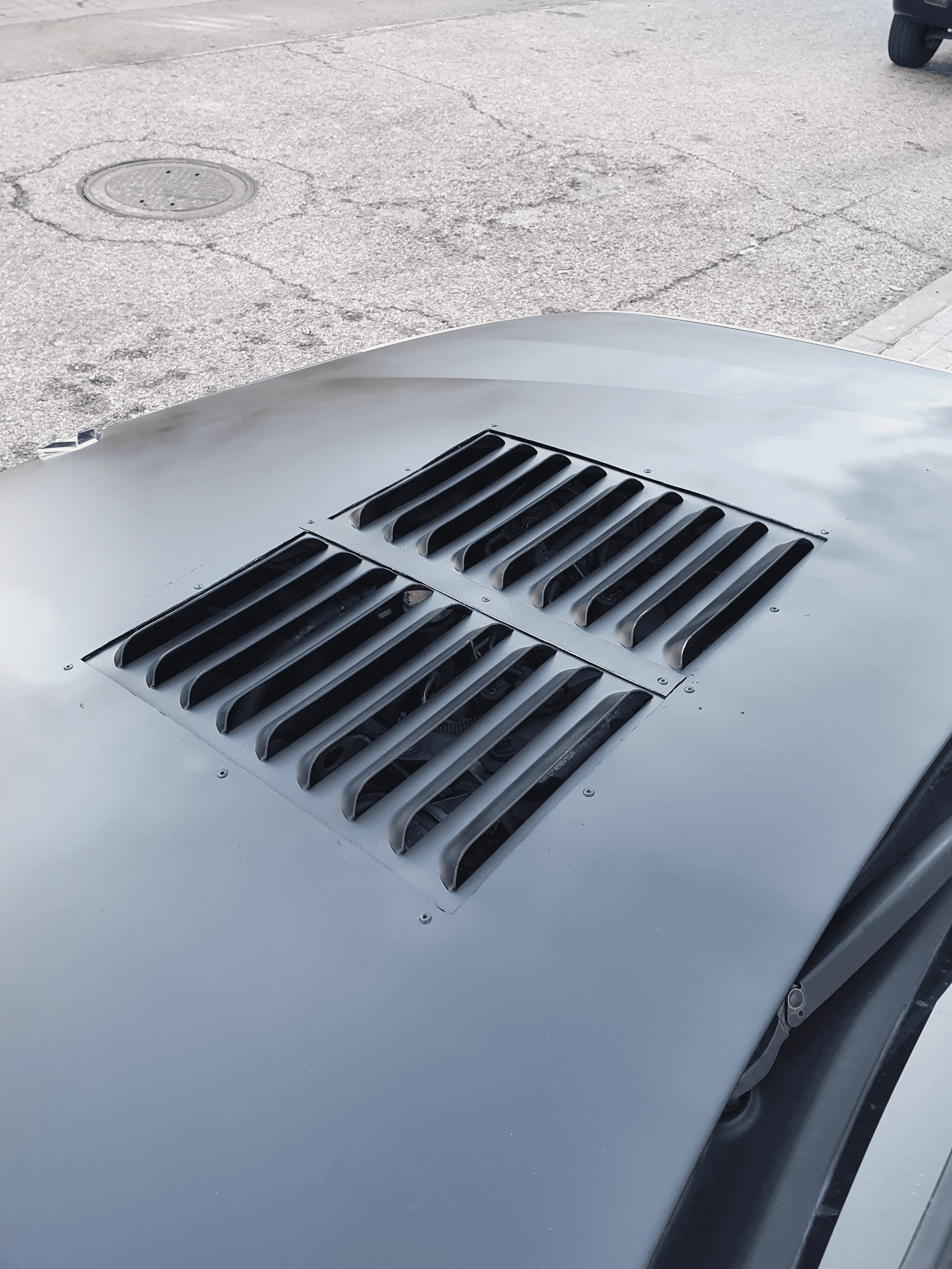

NightmareMoon
Nov 22, 2015
7,214
6,510
Austin
2016 Mustang GT PP w/ Voodoo
The aerodynamics of radiator airflow is kind of facinating.
Anyway, my guess is opening up the hood vent grills would help, even though the air gaps around the exhaust manifolds and transmission tunnels are huge by conparison anyway. Those side hood vents really are in a good spot.
This was my testing for fun with yarn. The side vents were the big winners.

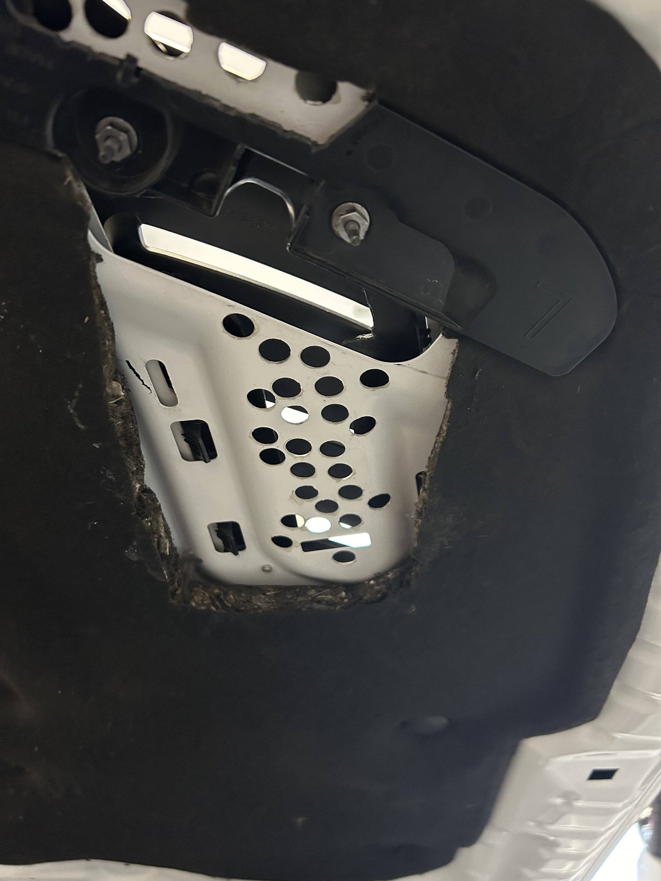

Here are pics of my 2016.
Schuvwj
Jan 12, 2023
82
49
William
2025 Mustang 60th Anniversary Convertible
I didn’t want to cut the whole section out so I step drilled holes to maintain strength. I modified the plastic top cover and hood insulation.

The aerodynamics of radiator airflow is kind of fascinating.
Anyway, my guess is opening up the hood vent grills would help, even though the air gaps around the exhaust manifolds and transmission tunnels are huge by comparison anyway. Those side hood vents really are in a good spot.
@NightmareMoon your video makes me wonder if just the side vents are adequate for track days, and skipping the big center vent.
Interesting also is how the yarn in front of the windshield folds forward, leading credence to the claim that the high pressure zone there would render removing the rear hood edge gasket ineffective.
