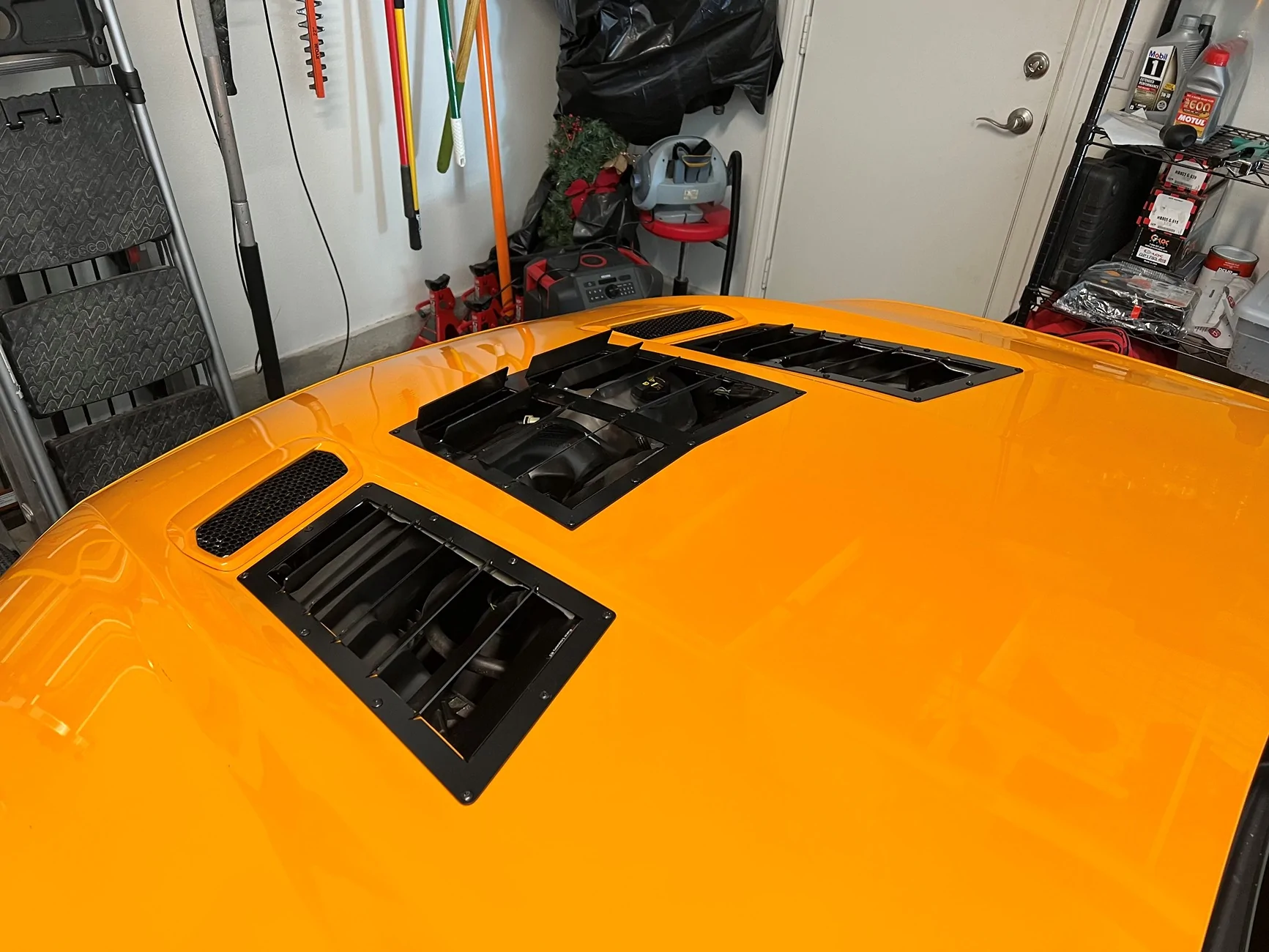

I installed trackspec vents on my car and cutting through that metal is no fun. Only thing that compared was drilling the holes to mount my BAP. That body metal is damn hard.
I would get a small thing of your paint color code if your going to cut the hood at all. There will be bare metal exposed on the cut ends and its nice to at least have everything the same color under the hood/resist corrosion.

i went with Race Louvers because they have actually gone through the trouble of wind tunnel testing to prove out the concept. Air that enters the grill is allowed to exit the engine compartment through the hood rather than from the engine bay under the car. Along with increased air flow through the radiator due to the pressure on the back of the radiator being lower ( increased delta ) the air flowing over the top of the hood is increased thereby increasing front downforce.
As far as opening up the grill I have not done so. Ford has designed the grill area to provide sufficient air intake. Opening the hood up increases the airflow even more. I think back to the days when NASCAR used to use tape to block off the grill to increase front downforce. It was interesting to see how small of an intake area they actually used to cool the engine. I think that a better track to take is to seal all of the areas around the radiator that allow air into the engine compartment without passing through the radiator thus again increasing the delta. Think in terms of managing the airflow instead of just throwing more air at it and probably increasing drag.
For the average street car driven normally this is all probably not necessary as Ford has designed the car for just such conditions. However, the efficiency of the cooling system can be increased with these types of modifications. I have not seen my cylinder head temps get as high as they had been able to since installing the Race Louvers. Yes, I would install them on another performance oriented car. There is no downside to increasing the efficiency of heat removal.
