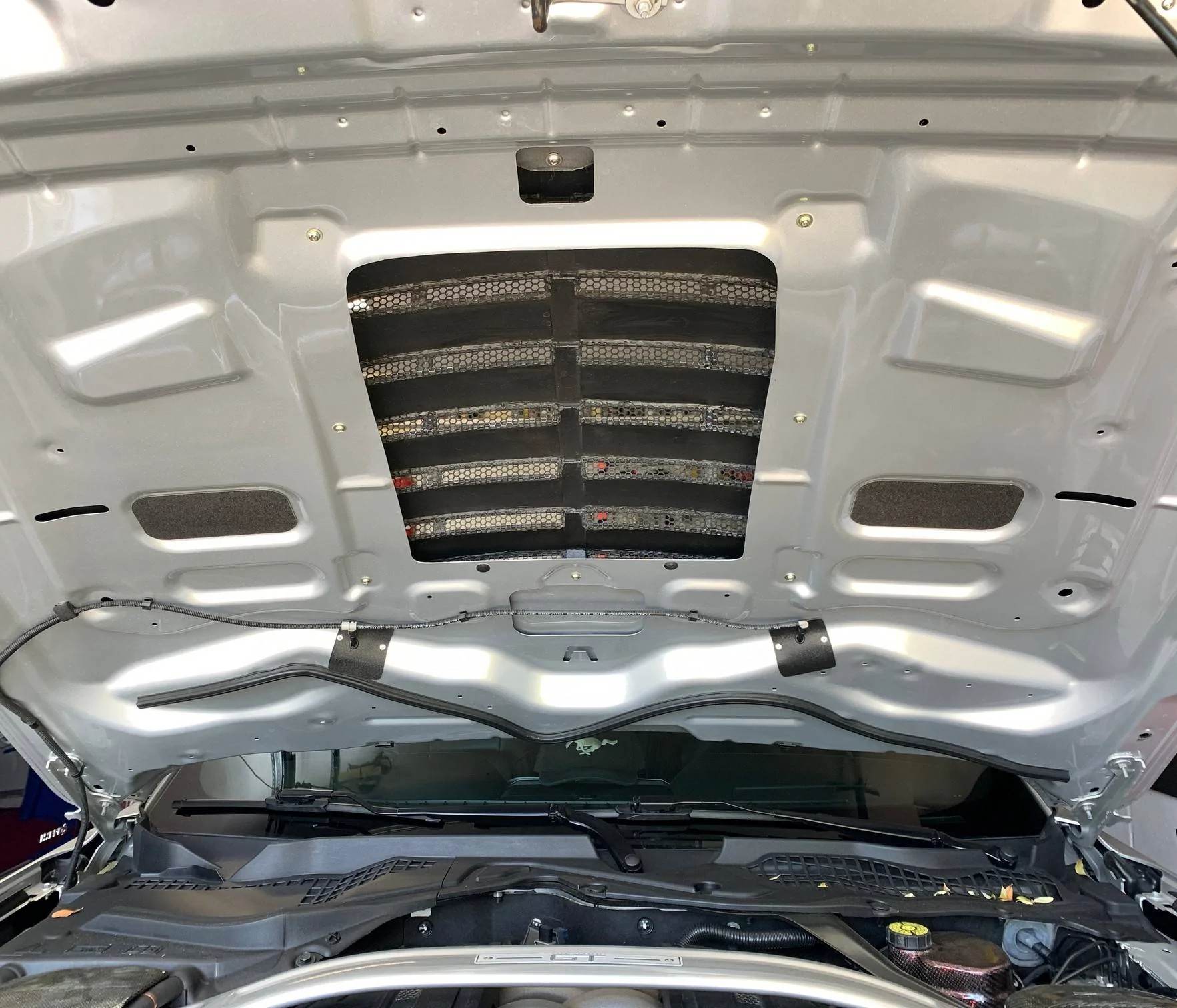

I started to design a set of hood vents. Hopefully they will be easier to install.
My plan is to cut the hood openings larger to match the opening in the vents once the plastic drip trays are removed. This will be virtually unnoticeable to the untrained eye if done correctly with the stock vents in place.
Hood blanket will be cut on three sides around the vents, leaving the rear in place so it can fold. I will come up with a system to pin it back to expose the opening or forwards to cover it (cold weather driving).
Plan for the new vents is to take the grilles out and make the drip tray easily removable. Will also cut access holes in the hood blanket for bolt access.

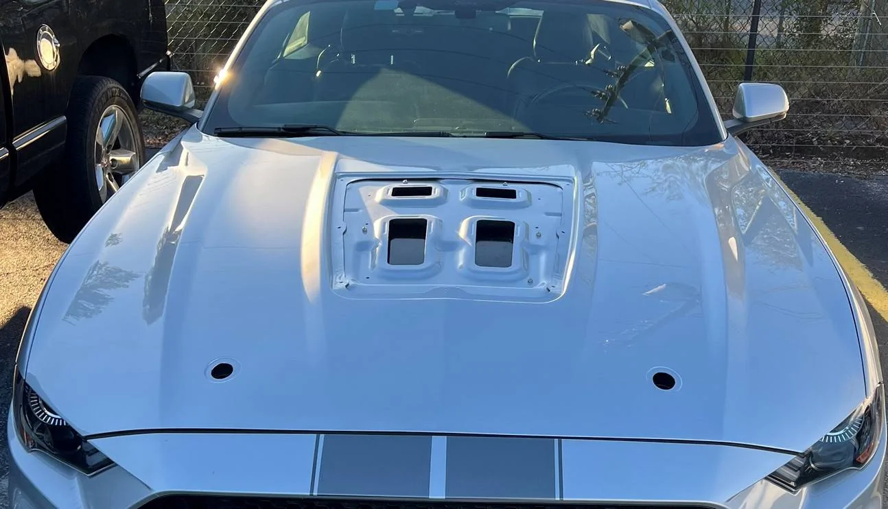

I performed a similar string test on my MP Concepts GT500 style hood, and got similar results for near the back extractor louver. (The front louvers did much better than the back louvers as well.) The back edge of the MP Concepts hood is a little bit further ahead of the windshield that some, generating a back louver neutral flow up to about 60mph.
That said, I since increased the size of my hood sheet metal opening increasing the airflow substantially out the extractor louvers.
Before:
After:
MP Concepts GT500 Style Hood with Honeycomb Grill and Significant Sheet Metal Cutout.webp
It worked...especially in stop and go traffic, there's evidence of success as I now observe significant wavy air currents billowing out the extractor at stop lights and on interstate stop and go situations. So, my reason for obtaining the GT500 style hood is working to my satisfaction.
Note that I also did not put insulation on the underside of the hood so that heat would transfer through the metal and radiate quicker into the atmosphere. Of course folks with similar CF material may have issues without insulation.
