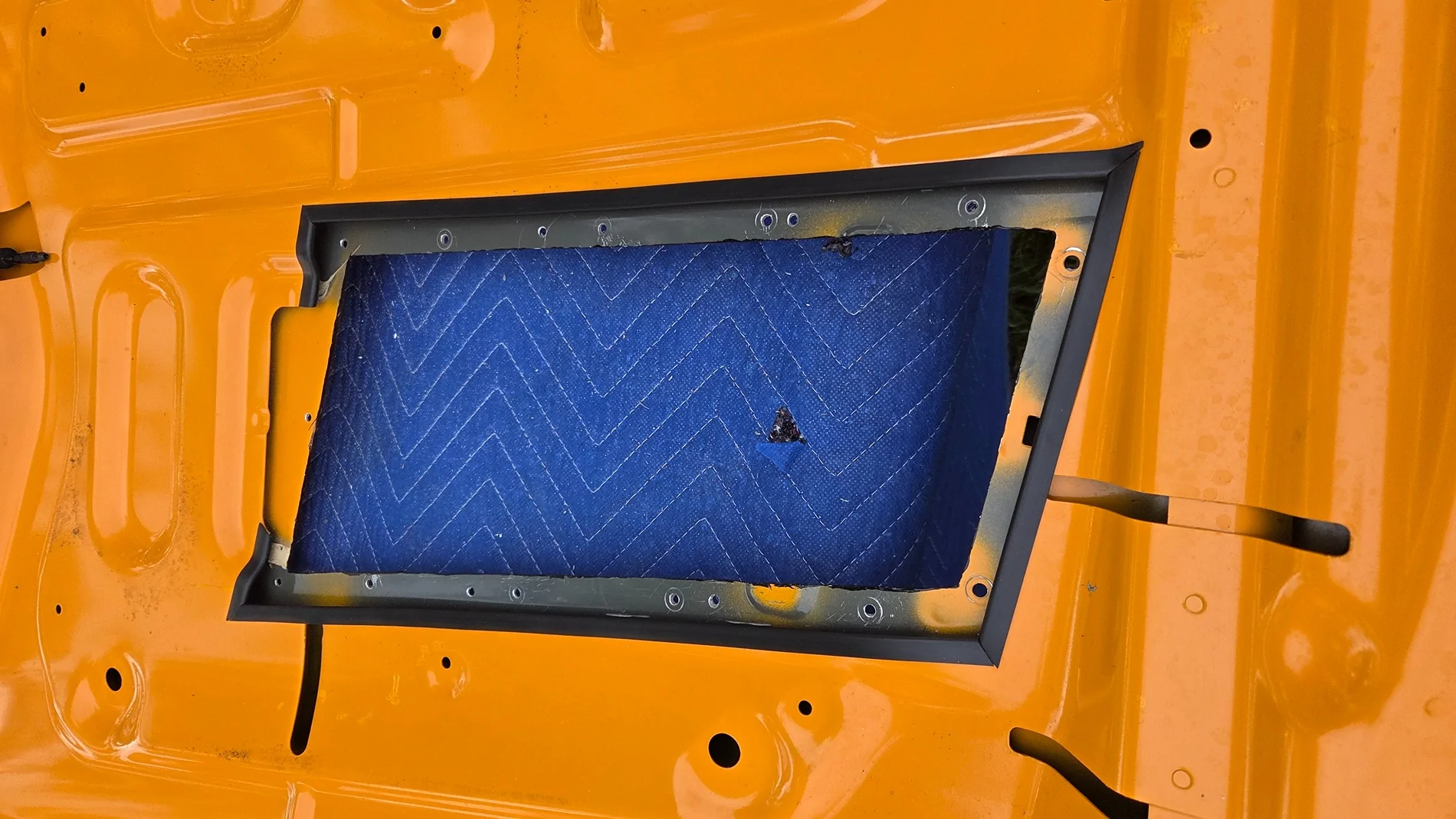

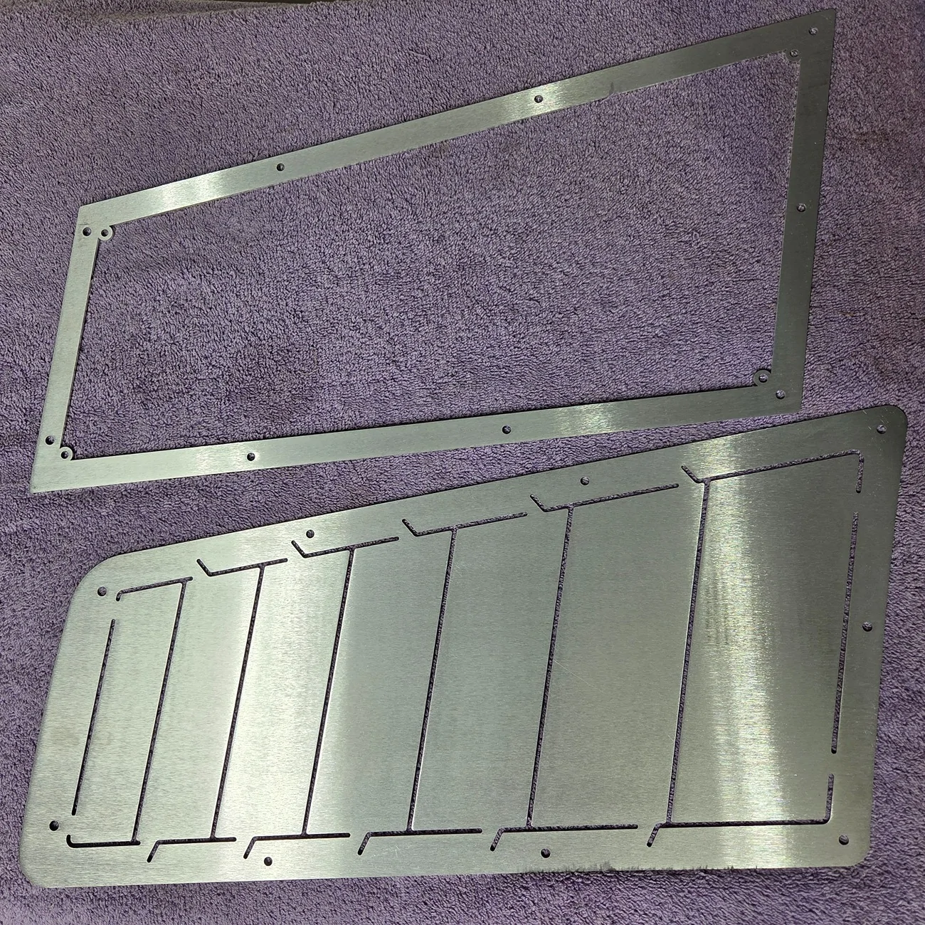

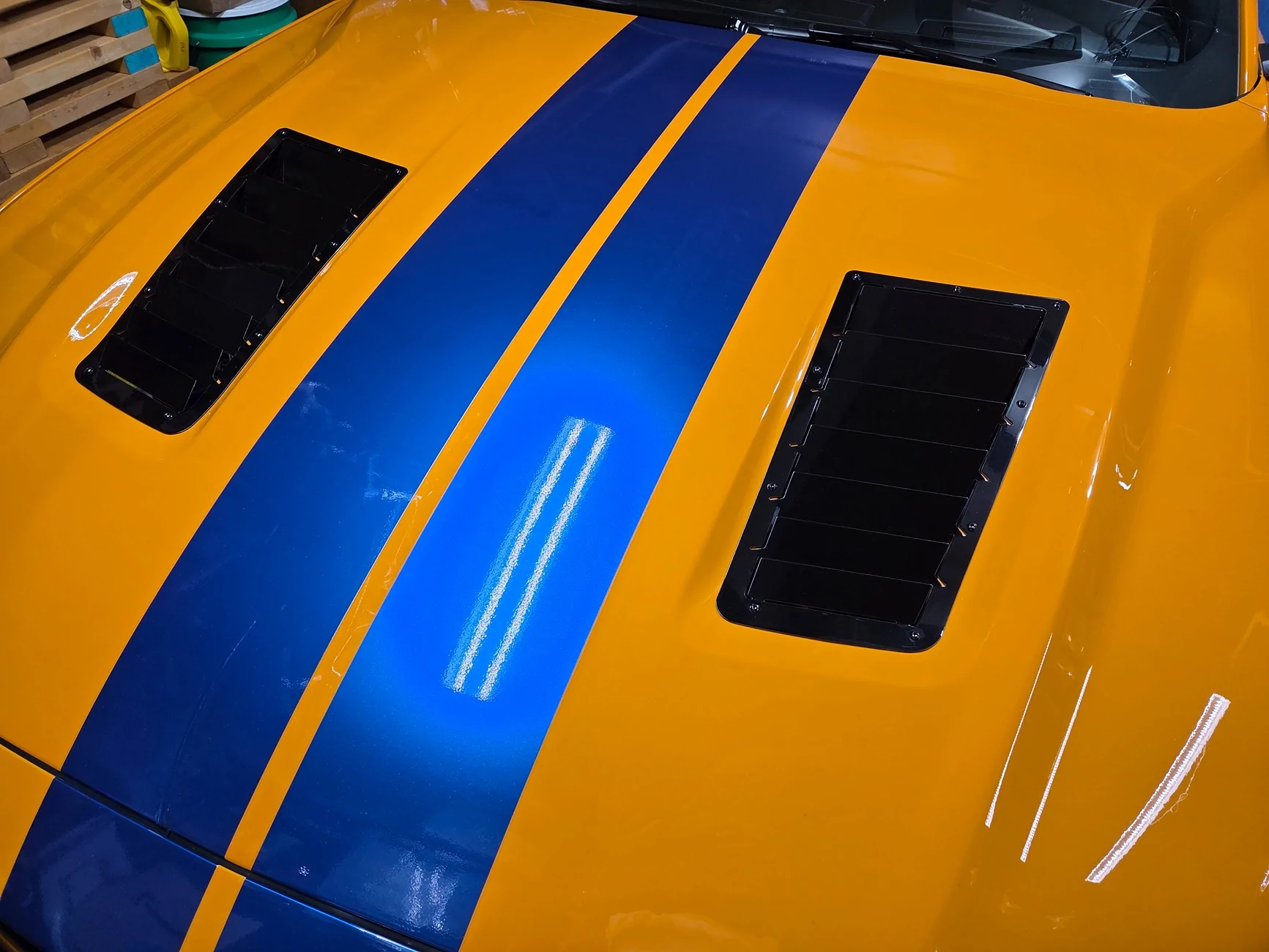

I designed my own vents. I wanted functional cooling but also close to OEM appearance.
Requires cutting both layers of the hood. I also made a drilling template so I didn't have to futz around with a big and flimsy paper template.

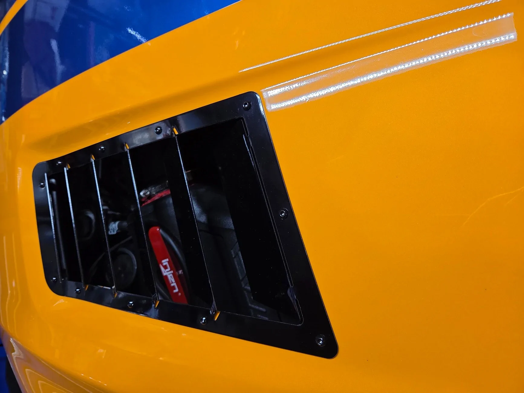

Optical distortion or another option, can't tell from the tight closeup?
That photo is of the first 6-louver version. I added it to show a view looking through the louvers into the engine. I have since added a 7th louver, which are the other 3 photos.
