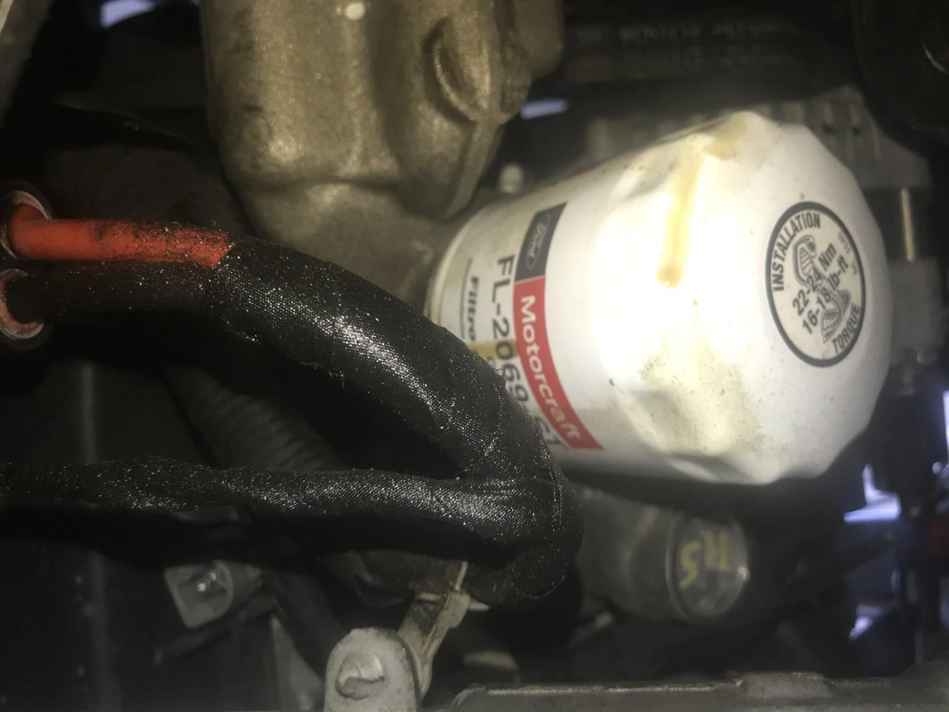

I had my oil changed on my 2016 gt350 at my local dealership. I usually change it myself. I figured I would give them a shot because it was actually cheaper than me buying everything online because I can’t find motorcraft 5w50 and the filter at any of my local stores. They changed it about 3 weeks ago. I went to warm it up this morning to drive it to work and noticed oil on my garage floor. So I ended up pulling it back in the garage and driving my truck to work. I raised it up when I got home from work to look and see what was wrong expecting the worse. Only to find my filter was super loose. I really haven’t driven it much since the oil change because I went to the beach. I lost about a qt but it could’ve been a lot worse. I haven’t had nothing but issues with my local dealership.

Avoid the dealership like the plague. Ford dealerships do not hire the caliber of technicians that should be working on these cars. After all they work most of their days on normal consumer level vehicles. I have not had one visit to either of the dealerships in Houston without them screwing something up. Whether it's leaving out interior clips, leaving things loose, putting scratches in the paint or all of the above.
Either do your own work or find a mechanic you can trust.
