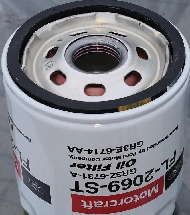

AND another thought...we all know the 2062/2087 is not made from the braided hairs from the mane of a Unicorn that only lived in utopia because it’s used on many other vehicles, BUT, the spin on 2069 bears this sticker, which makes me think it possibly was made JUST for this car!!
Things to ponder!
OK...back to my beer and rearranging my new tool box.
Actually, the view of the FL2069 that makes it crystal clear that the filter was made specifically for the Voodoo is this one:
The red coating is thread locker.
I have wondered about applying a dab of blue Loc-tite to the threads of the filter
I have 3 of them in my cabinet and after closer examination I see the red stuff on the threads but czn not tell if its loc-tite or heat marks from when they cut the threads.
Anyone else use anything to lock these filters ?
Do a search for Vibra-tite VC-3. The product on the filter looks like VC-3, although it could be a competing product. In any case, it's oil and vibration resistant, perfect for this kind of application.
All the better reason to made sure the threads on the mounting stud are clean and dry

If you put oil on the gasket and torque to proper specs its not going to come loose. Those I've read about were either put on with a dry gasket, not properly torqued or not put on properly from the factory. Let the flames begin!
