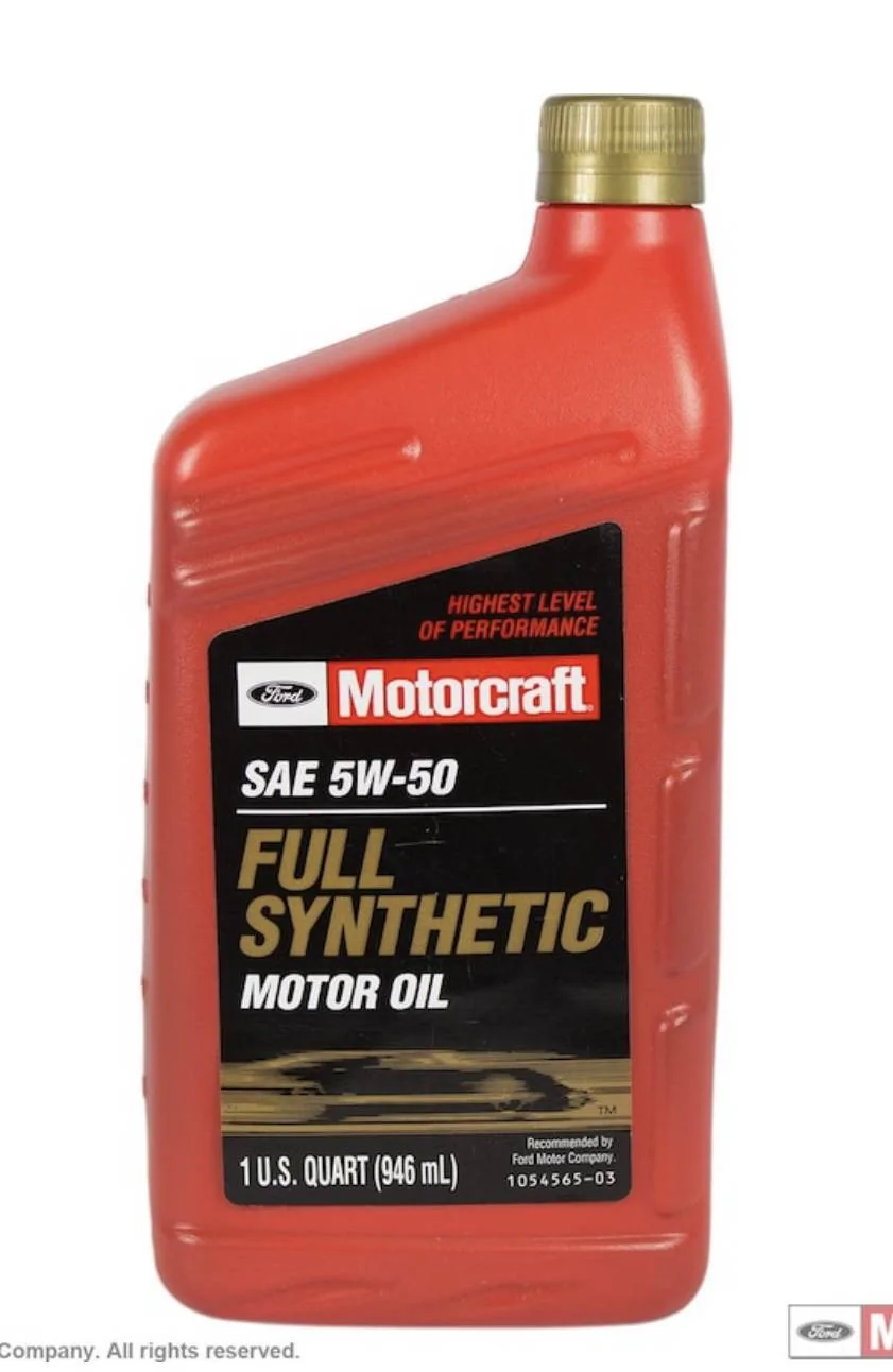

So I bought a 10qt case of motorcraft 5w50 along with the 2067 filter.
I took it up to a quick oil change place as I don’t currently have a jack that fits under the car.
when they took the skid plate off it has a spin on oil filter conversion done so the 2067 is not going to work.
Hes calling his help desk but might have to just have new oil put in (already drained) and leave the old filter in place until I can figure it out.
im going to ask to get a pic of the filter that’s on the car but didn’t know if anyone has experience with this conversion. They just told me they had to put the old oil filter on so I could source one. He said once I do to bring him the filter and a couple quarts and he would swap it for free.
I still have to figure out the filter but I have a 2067 I might put on eBay lol.

Just ordered the filter for $20 and ordered couple quarts 5w50 so they can swap it for $9 quart.
Oreillys has it pretty cheap for a full synthetic.

What brand of “really cheap” oil are you getting?

I had no idea O’Reillys carried Ford branded oil, never looked.
NavyMAC
NavyMAC
Jan 27, 2022
51
56
Orlando
Jeff
2017 GT350
Mine does but not this weight. I have to order it online from their website.
