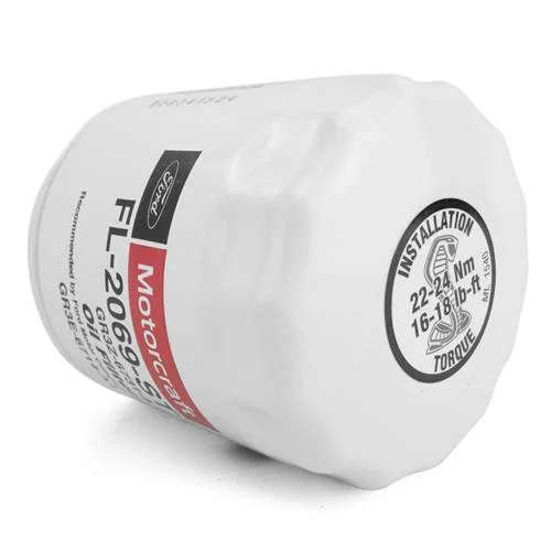

I will promise you that a filter that has an o-ring that was lubricated in oil and then torq'd to the 18in/lbs will NOT spin off on you. But if either of those two conditions aren't met, there's a good chance of it. I have a track only car with a spin-on and I have a hell of a time getting it loose every oil change.
The correct torque spec is 18 FT/LBS not Inch pounds !!, typo I am sure.

I probably didn't torque it right. Time to buy a new torque wrench for cyber Monday. I still using 1992 beam torque wrench.

Haha, yes. I was just talking to another fellow about spring rates and had in/lbs on my mind :)

I have changed my oil twice and I have a spin on filter. For my peace of mind I take a sharpie and mark the 6 o’clock position on the top of the filter after mounting which can be viewed through the drivers front wheel between the rotor and the barrel. I check it every couple of weeks to make sure my filter hasn’t moved. My filter has not budged.
