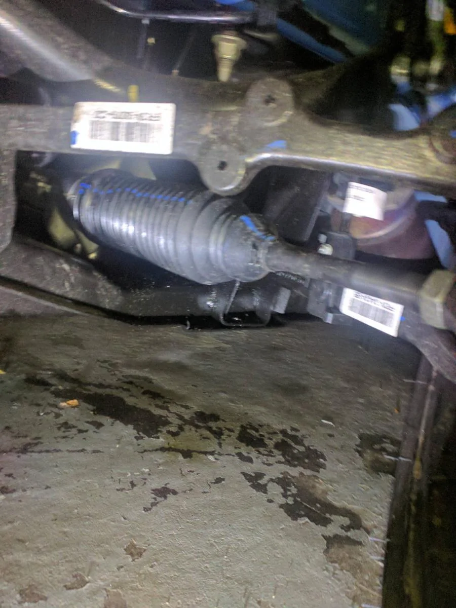

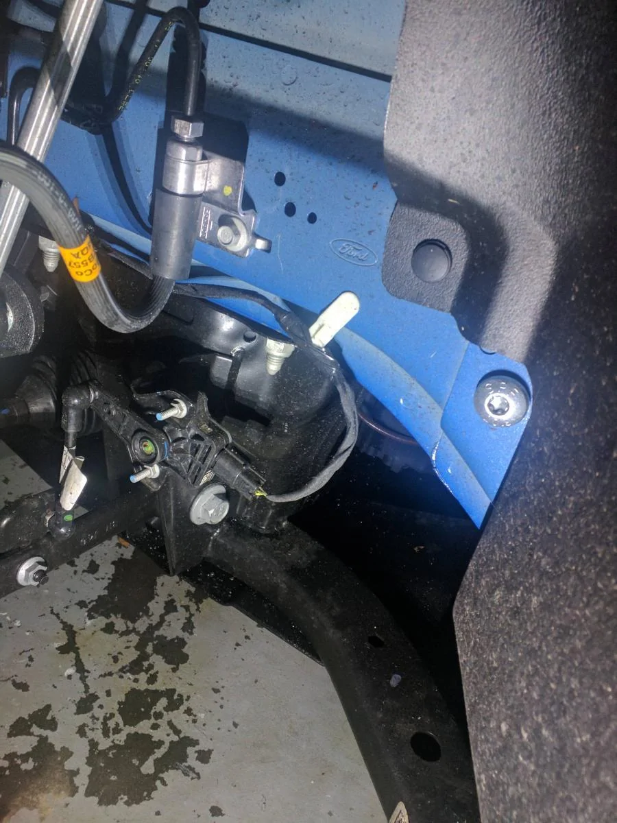

Hi all new to the forums. Seems like I may have the same issue. Over the weekend I went to wash by car and noticed a puddle of oil on the garage floor. I checked the dip stick and it was indeed missing oil. The oil was just above the lower dot on the dip stick. The 350 was built 4/18/2017 and i have 937 mile on it a of right now. I am getting it towed to the dealer on Wednesday to see what happened.

Are you able to get under the car to identify where the oil is coming from? If the oil filter has wiggled loose then it should be a quick fix - or at least peace of mind that it isn't something more serious. Good luck, let us know how it goes. :thumbsup:
One thing several people have mentioned and something that I do as well is put a witness mark on the filter w/ a sharpie. That way you can get a quick visual status and tell if it is coming loose. The filter is visible if you get down on the ground and look through the rim spokes, so no need to get under the car to check it!

I tried to look through both front wheels but could not see the oil filter.

So I checked with service and it seemed to be a oil pressure switch which caused the oil leak. It was defective and started to leak oil. Leaving this here if anyone else ever has a oil leak but its not coming from the oil filter.
